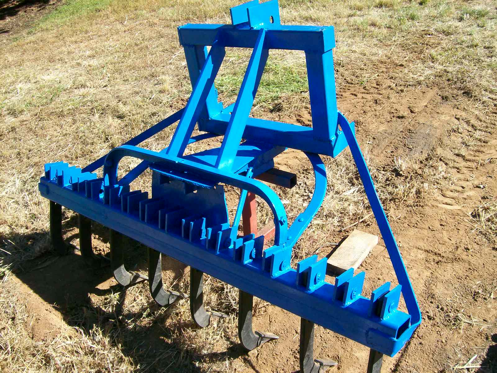

   / Anyone Plow With A Double Middle Buster? #14
You could just make a ripper , with box blade ripper's , like I did , ( actually mine is converted from a double gang pull disk frame that was later converted to a single gang 3 point disk ) . I do have very clay type soil , Make 1 pass around perimeter of fence to break soil , then 2 passes with my KK 6'5 disk . This gives me a 8' to 10' wide fire break around West , South , and East sides of Property .
It is nothing fancy , but it works .
Fred H.
