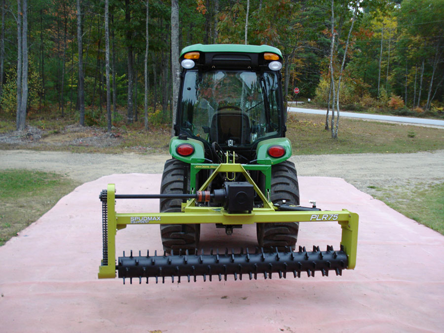

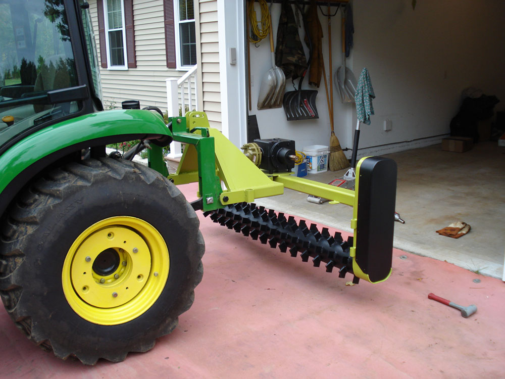

Umm...I thought the diverter just diverted the 2 loader circuits to the rear...the rear SCV doesnt change via Diverter...
What kind of power rake are you building?
This is what I'm building....99% done, just the final doo dads & trinkets to finish up...I'll let the pics do the talking...
