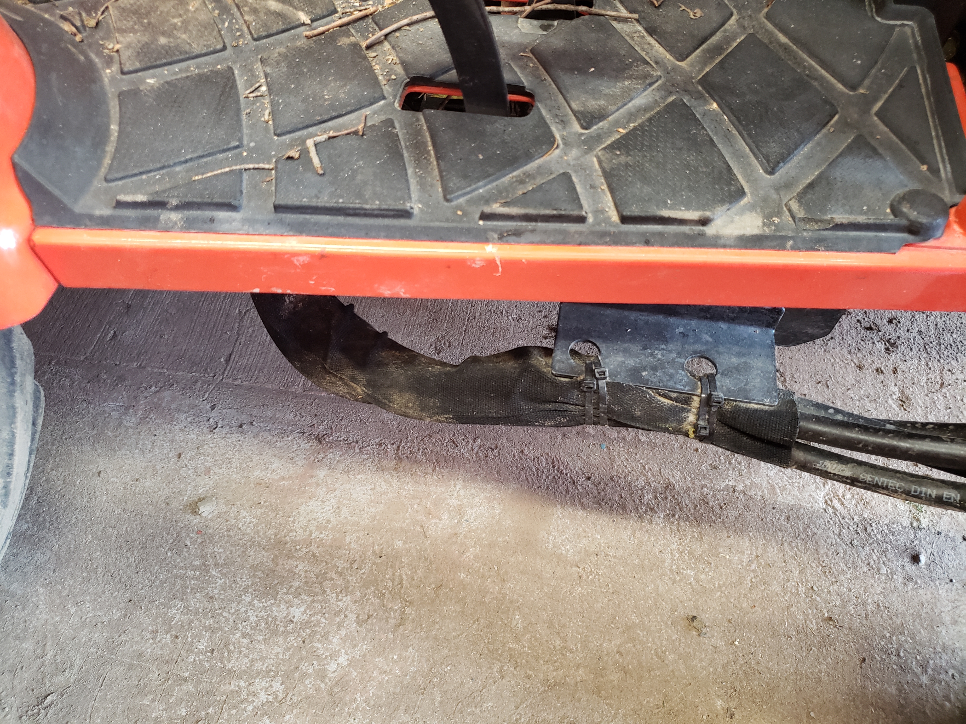

I'd like to add a step to the right side of my 3510. It's got the mounting holes already there for a step (same as the left side), but the Kioti step won't work, because of the loader hoses and bracket that are underneath the right hand side. Has anyone fabricated their own step, and have any pictures to share?
I believe the bracket that's in the way is where the Kioti 3rd function kit mounts. Right now, the loader hoses are simply zip tied to this bracket. I'm thinking about just removing the bracket, ordering a Kioti step, and zip tying the hoses to the back of the step, but I'm not sure if there's enough slack in the hoses for this to work.

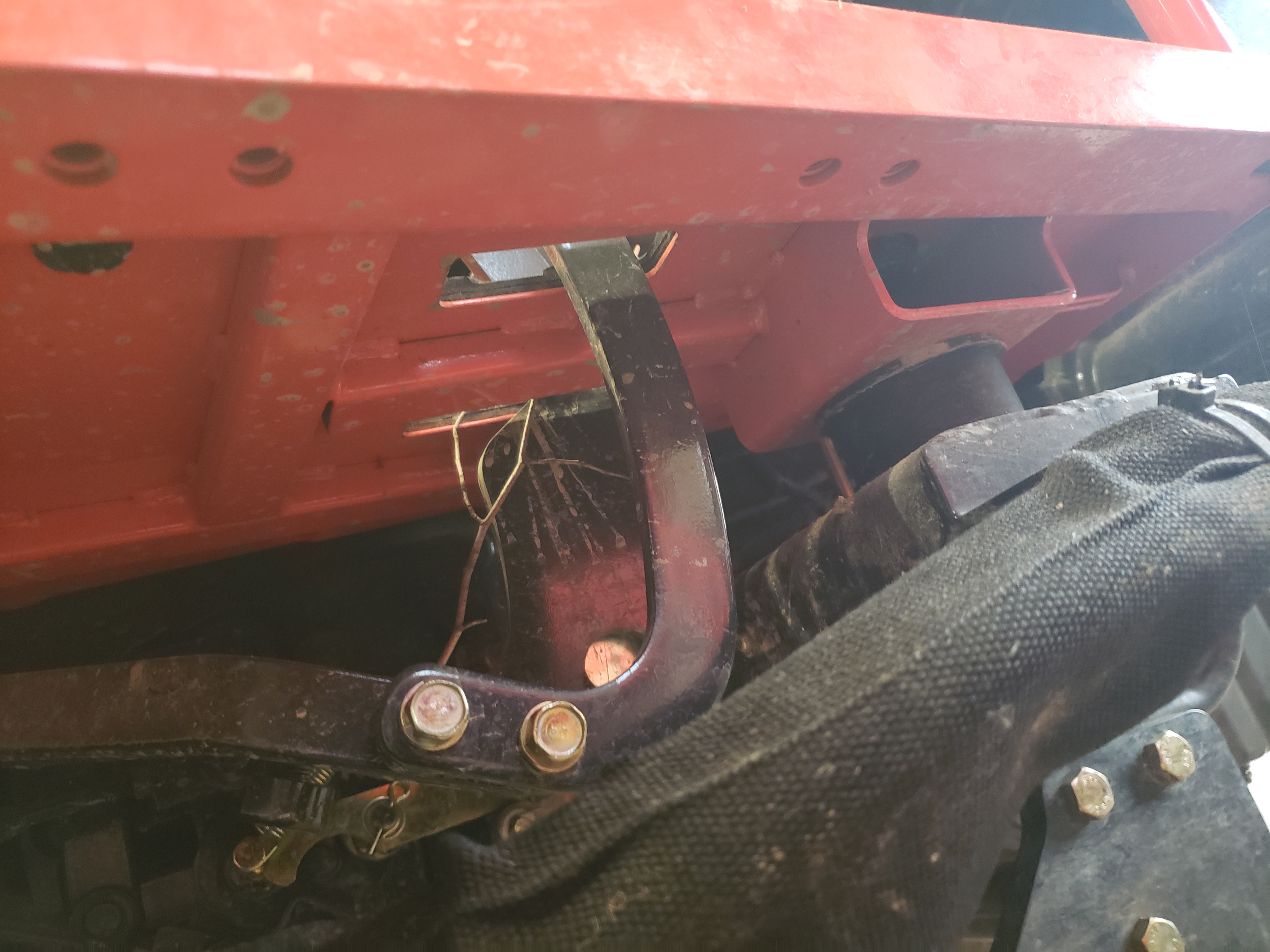

The hoses on mine seem to be routed out of the way. I just took a look. I don't see anything that would be in the way of mounting the step same as the other side.

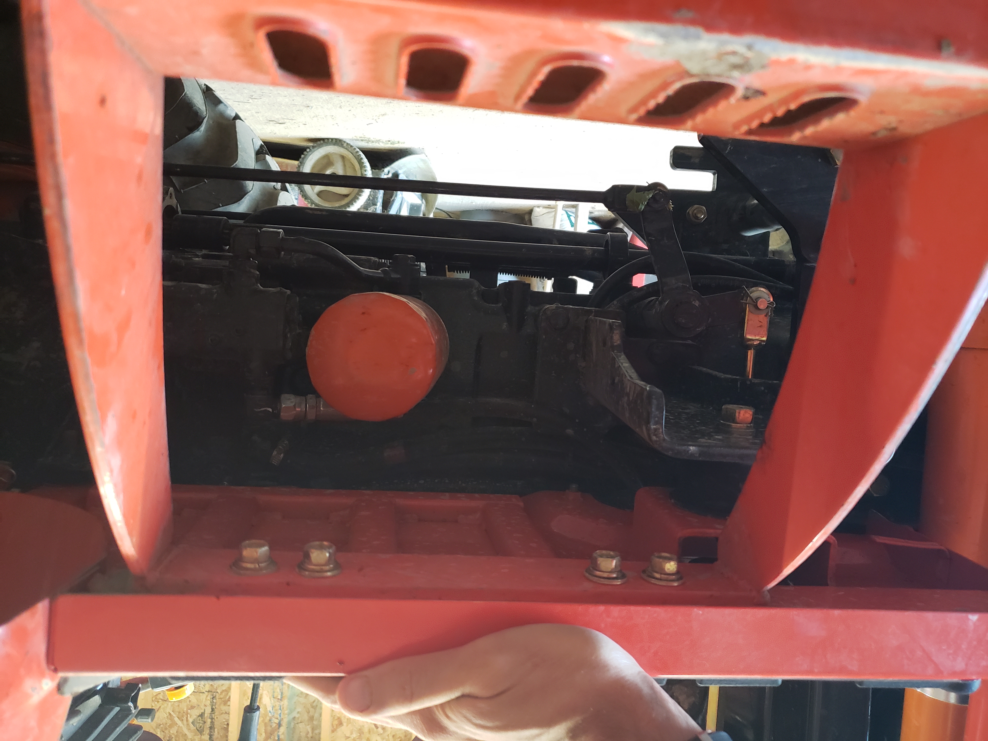

Here's a couple pictures of my ck3510se. First is the step on the left. Then you can see the mounting holes are there on the right side, there's just a little bracket welded in the way, with the loader hoses zip tied to it. I think I could build my own step, by not making it as wide as the left one, and doing some creative bends to get around that bracket and hoses. Just seems silly that they'd go through the effort of drilling and tapping those mounting holes, but then put the hoses right in the way.

Mine I is about the same. I think they way the factory step comes out from the side it would clear all that. Easy test would be to unbolt the one on the left side and see how it lines up. I am interested in this too. I find myself on/off the right side half the time. I even have a 3rd function but there is no box just a valve mounted by the quick connects.

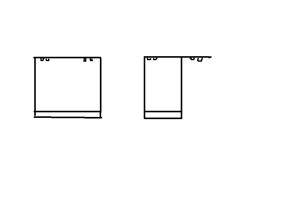

I tried. It does not clear. It's not even really close. The vertical part of the step hit's the bracket/hoses. I plan on fabricating my own at some point, but it's not a pressing project, so it might not happen til next winter. If I make one that's narrower, it would fit, and could even still use the existing mounting holes. Here's a very crude MSpaint drawing of what I'm thinking. The factory step drawn on the left, the plan for the right side drawn to the right.
I would agree a narrower step should work fine, can you put both feet on the factory step and or do you really need to put both feet on it.
