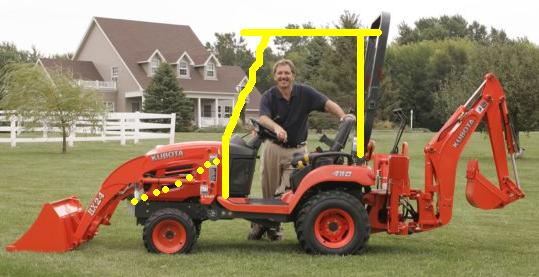

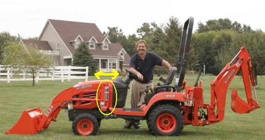

Interestingly, when I first picked up the machine, some of the bolts that hold the quick connect FEL cradle to the frame where not torqued completely and it became very clear where the design deficiencies were. If you look at the b21 file below, you will notice the added bar between the front "bumper" and the FOPs cage. Because I want to add heat for winter jobs plus the fact that I hate forgetting the ROPs is up (and hitting the top of the garage door), I will be installing a custom made FOPs for my tractor (yes yes I know the dangers of making your own protection systems). Anyways, I plan to add this bar between the bumper and the FOPs with some sort of quick connect so I can still quickly remove the FEL if need be. The image below labeled flex shows the problem common to bx24s when you are pushing something hard with the FEL. If you don't believe me, check it out next time you guys are sitting pushing something. It will flex almost a half inch (especially in float mode). Not a big surprise given how much mechanical disadvantage there is by design. By locking the top to a FOPs, I am hoping to really tighten things up.
Poke holes in my ideas .... the tractor is getting closer to the plasma cutter and welder by the minute!
