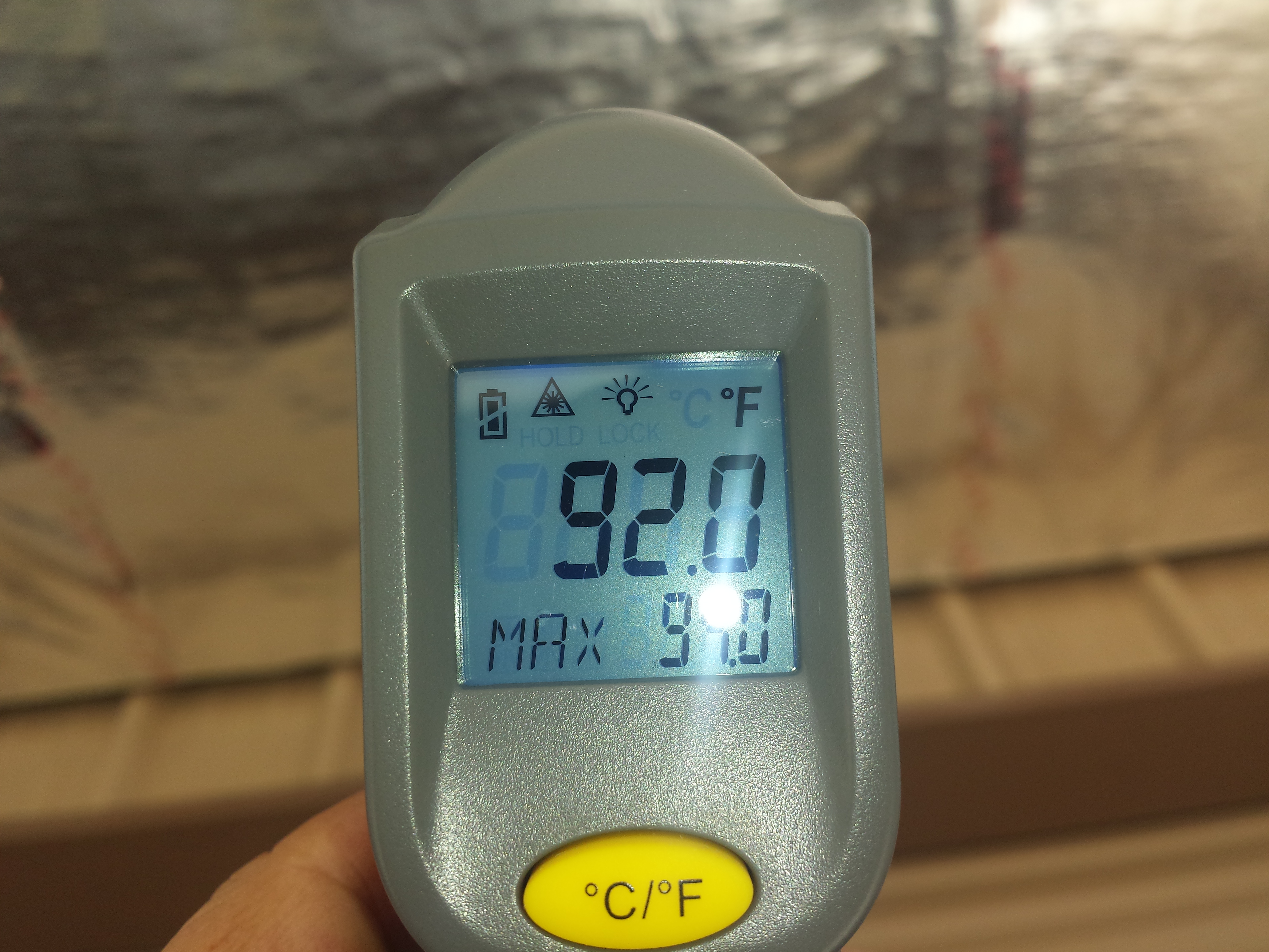

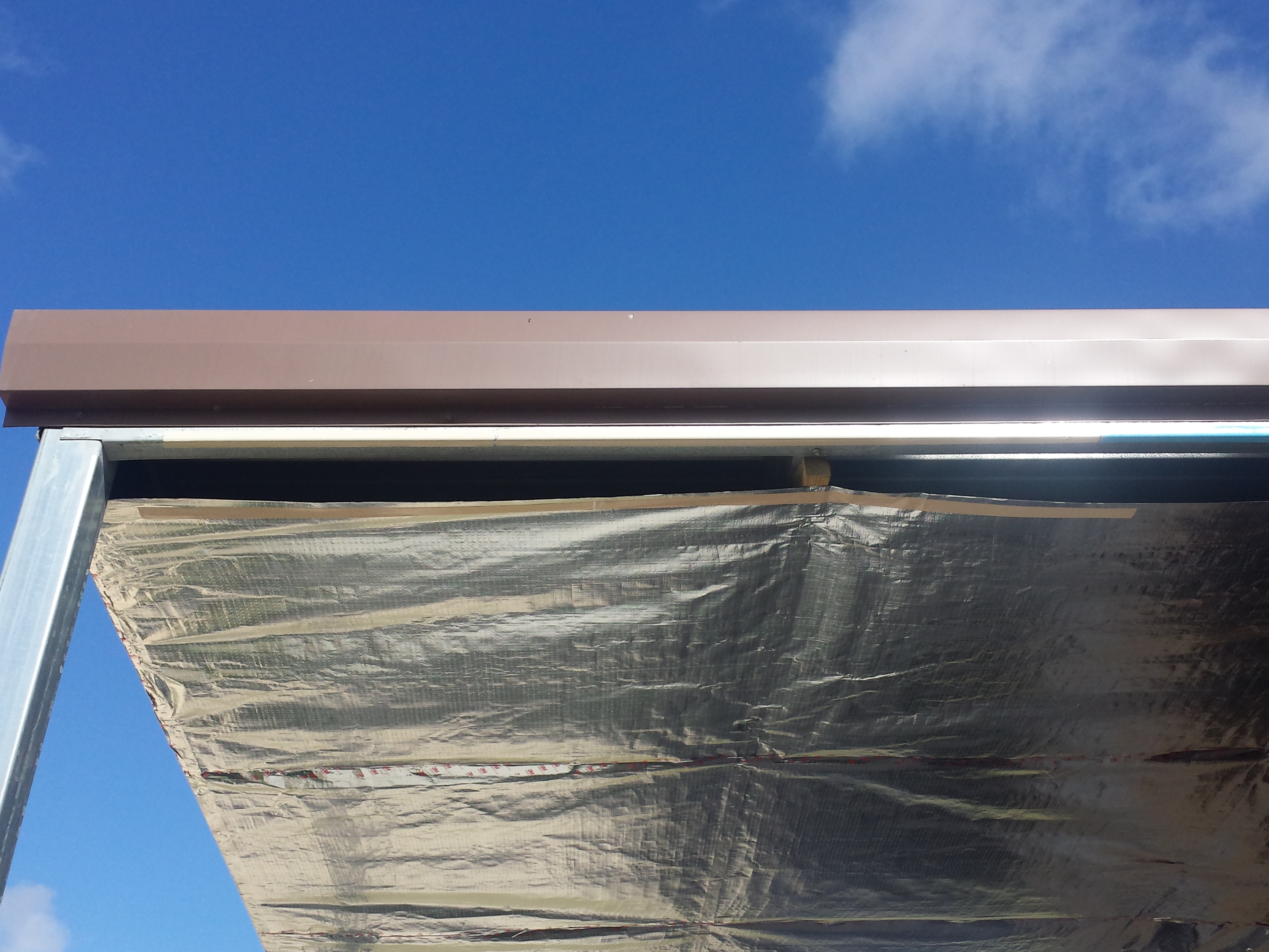

I used this under the awning of our barndominium.
on edit wrong web site. Here is the one I used: https://atticfoil.com/
Also laid some over the decking of the attic space over the living area. Noticed a tad improvement on a/c loading and heater needs in winter.
So using double sided tape this can be applied on the underside of you cab roof and then reinstall the headliner. reduce heat transfer. I noticed a 9 to 11* temp reduction. 20170822_123744.jpg
