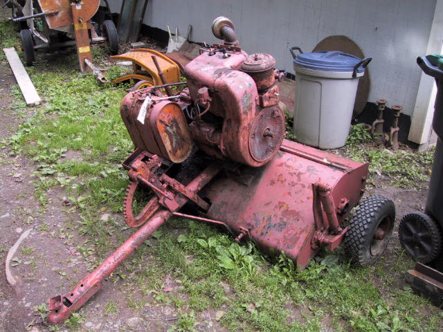

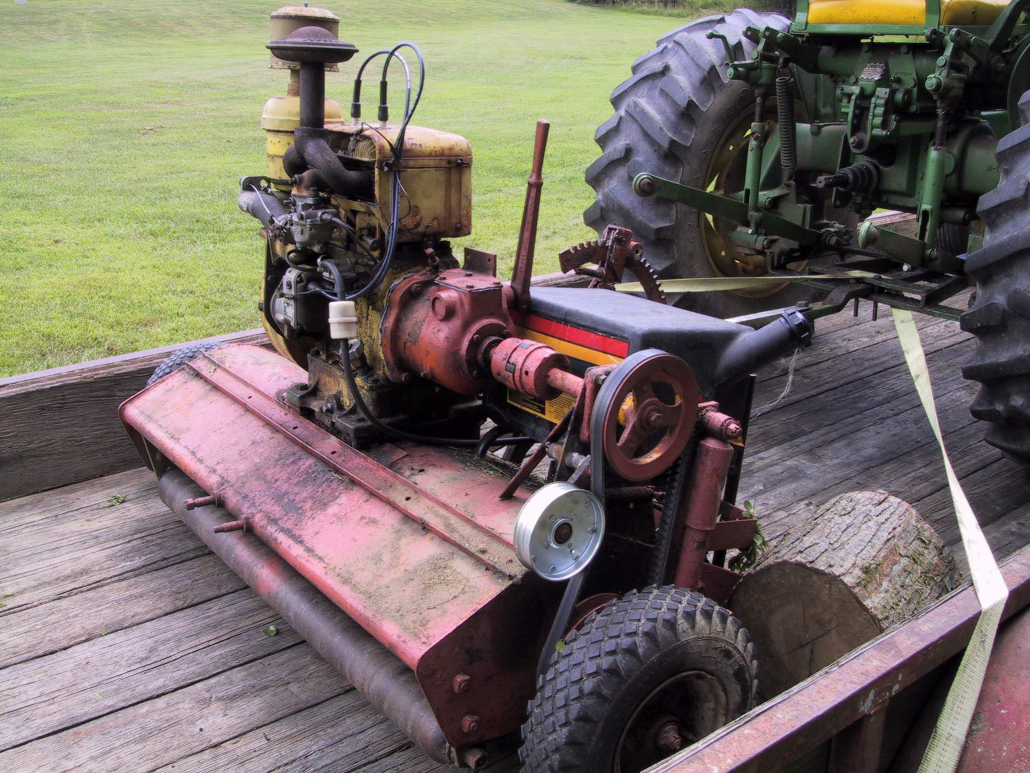

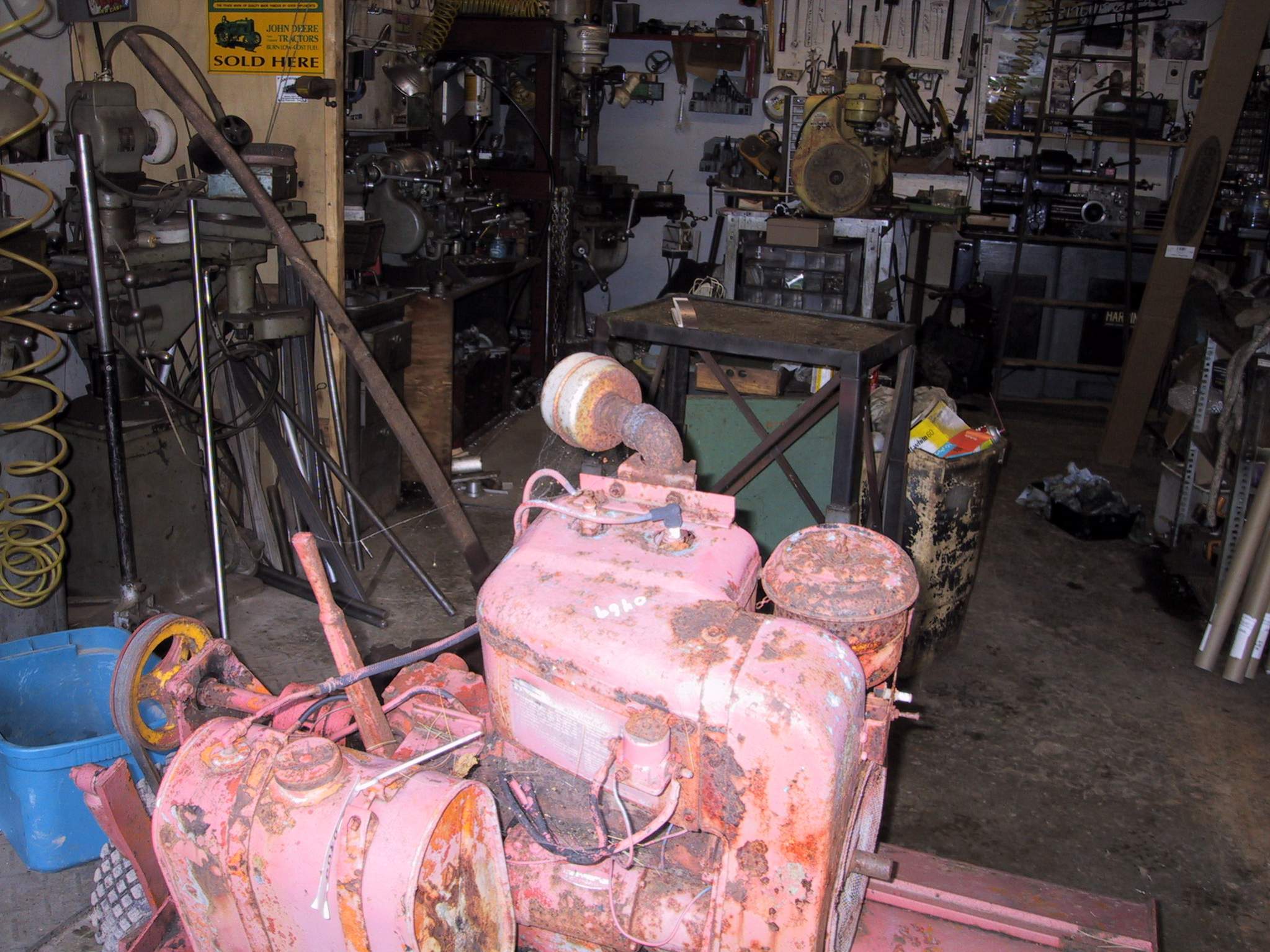

It is moving closer to the shop!! Just a couple more reel mower, generator, shed, dock, sap house, chimney, terrace projects to complete...

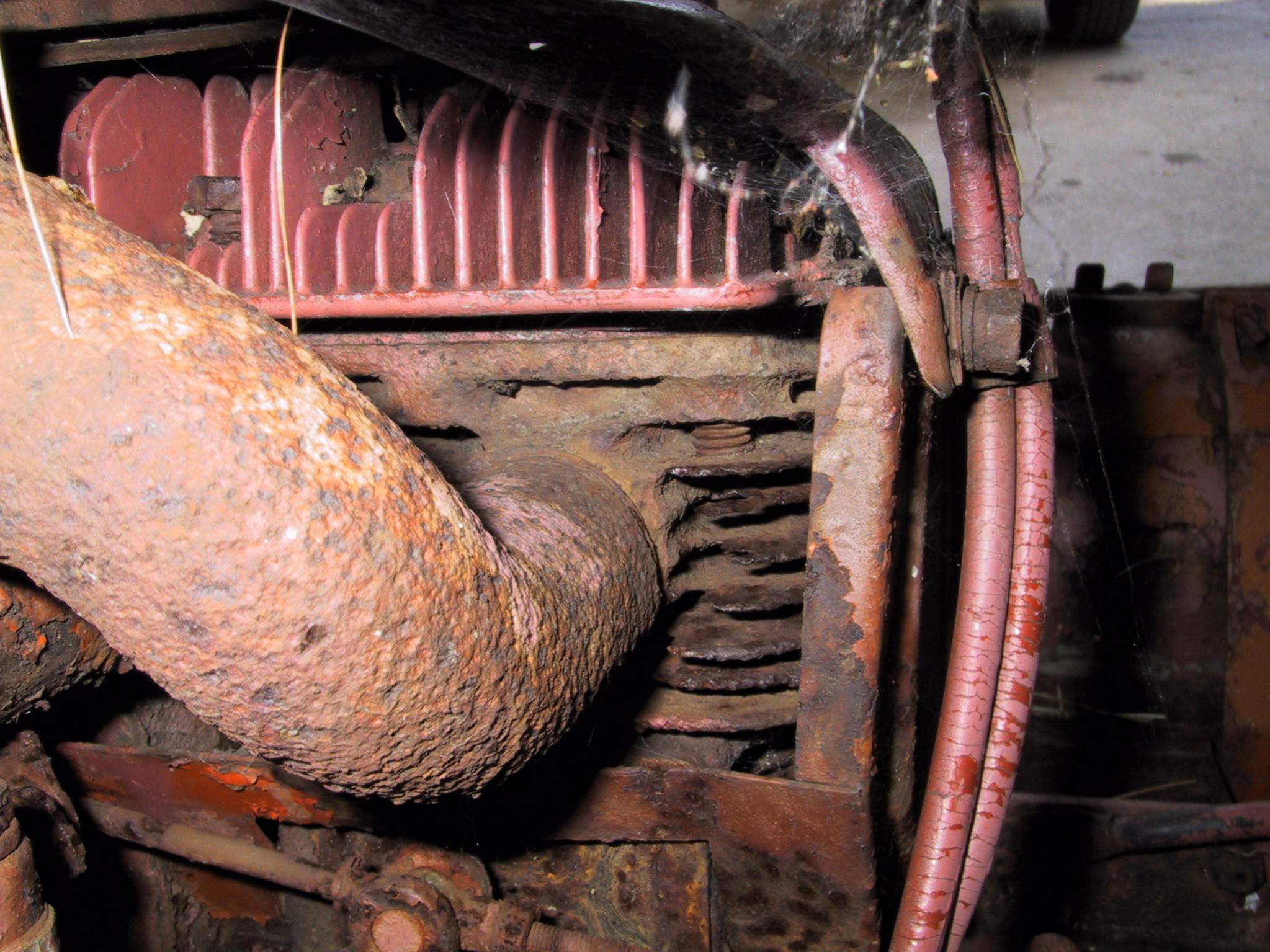

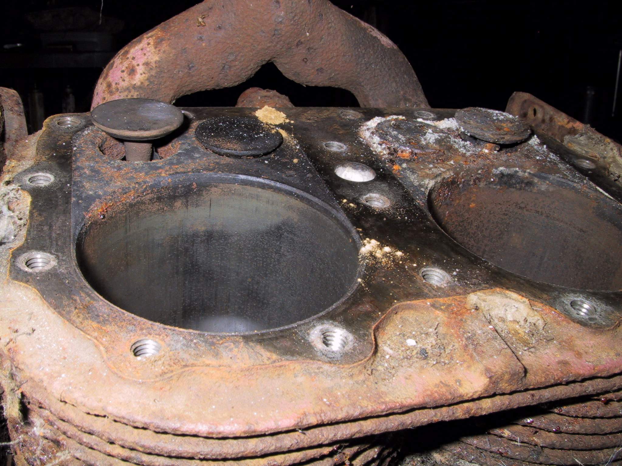

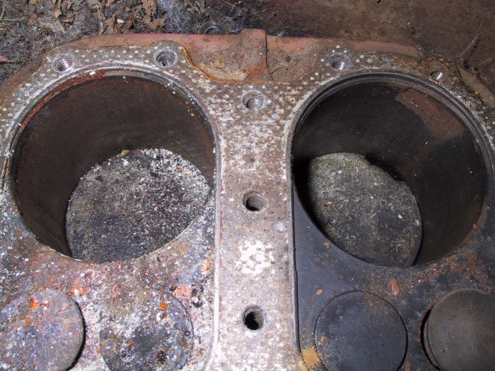

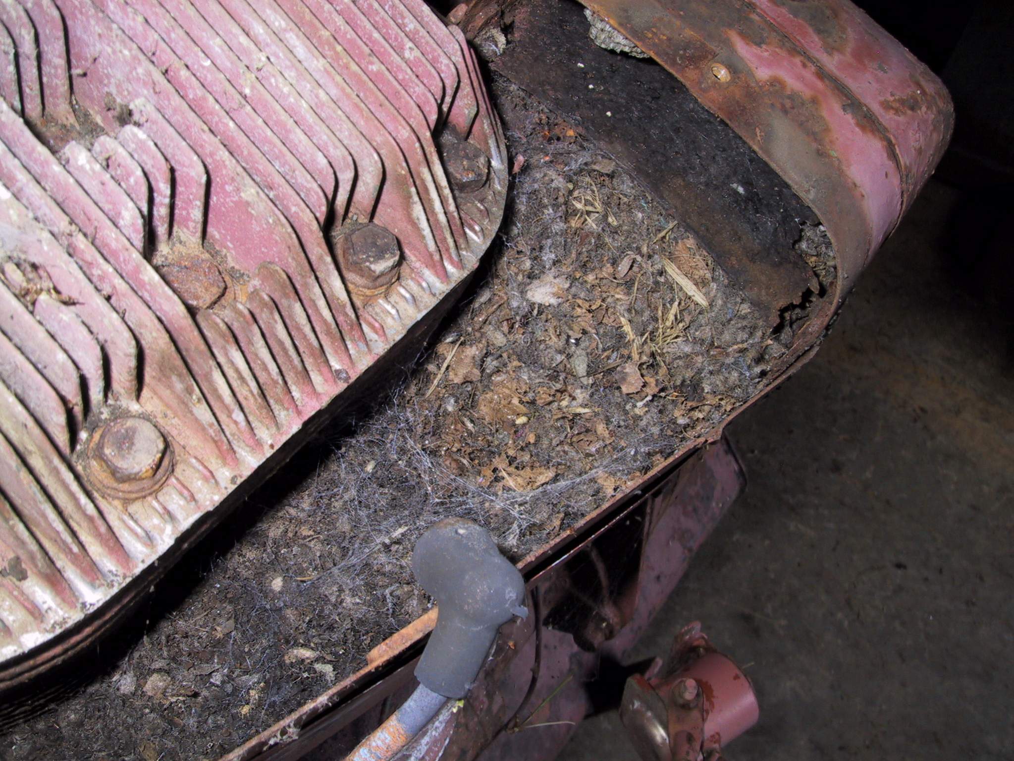

Well, It is in the shop! But the tear down was grim.:( Seems like it overheated- the pistons are broke to the top ring, and there is no ring visible on the one piston, and there is shrapnel damage on the head and piston crown. Could have been run with that mouse nest in there... Note that one exhaust valve is stuck open higher than the other- it probably was run with that valve sticking, and the cam hammers it open further- saw that on a generator a while back. These Wisconsin twins will run on one cylinder. That is the top end!

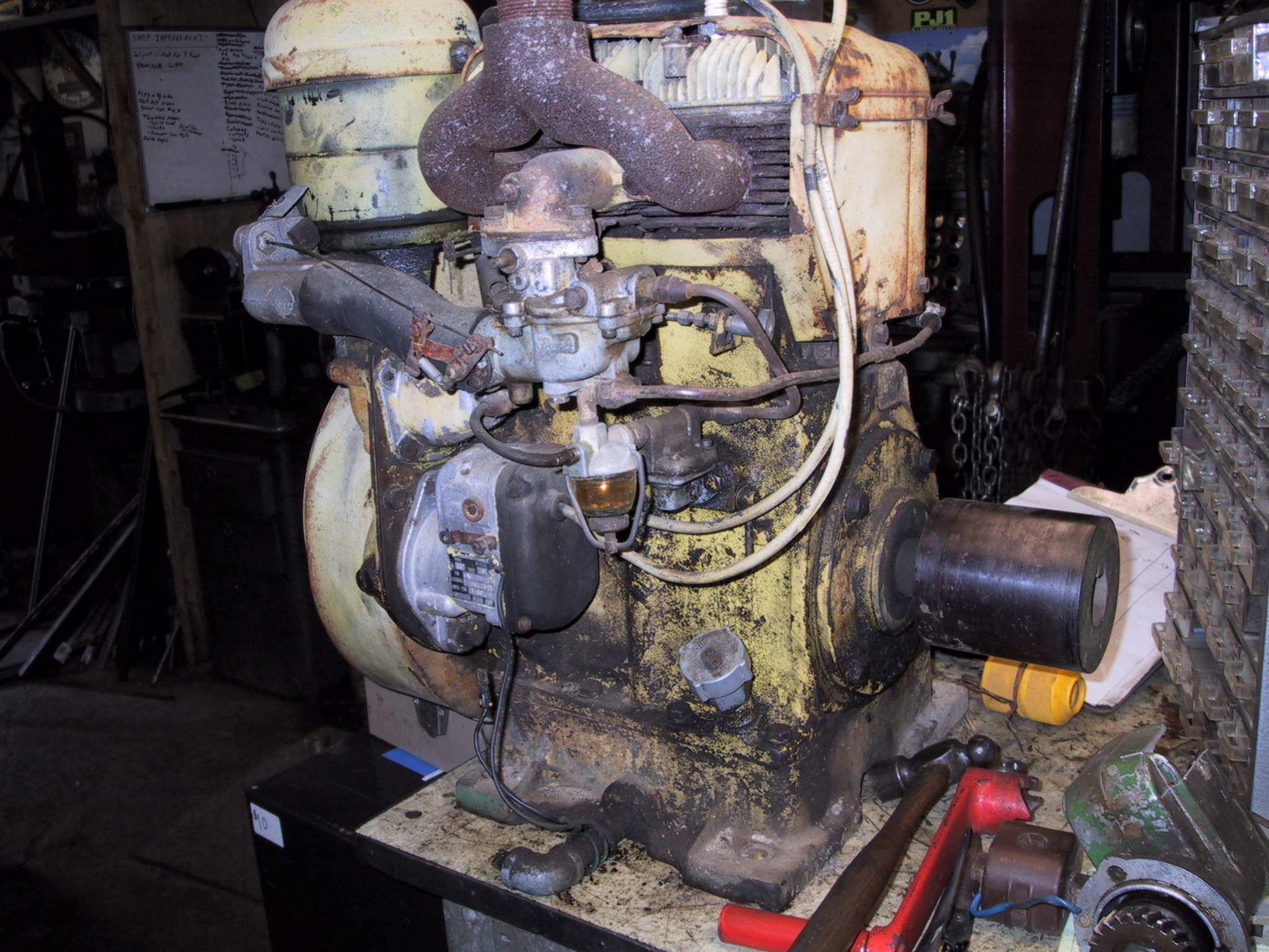

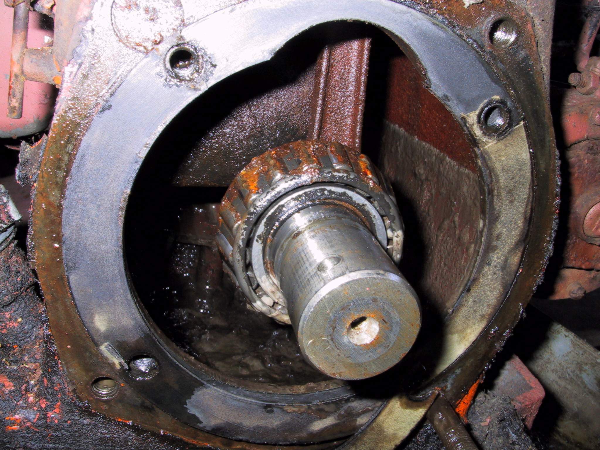

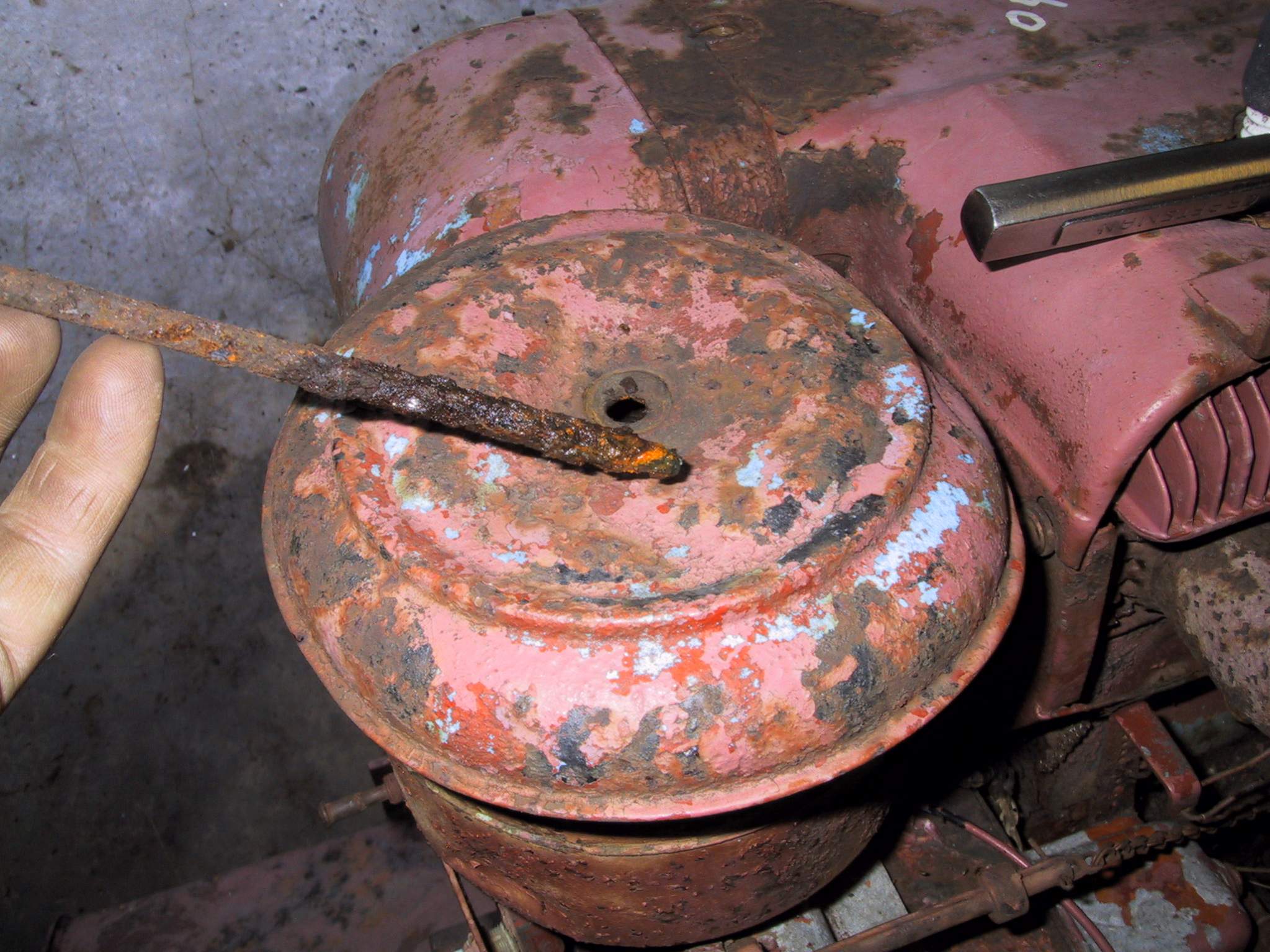

Now for the horror of the bottom end! There is evidence that it has sat outside in the rain for a LONG time- Look at those rusted cylinder fins! Water has been sitting in the air cleaner base- the stud was very rusted and twisted off by hand. The drain plug was pulled- no oil- but 2 gallons of water!:licking: You can see in the 3rd picture the rusty main bearing and the water line, which is above the rod bearings. Everything is corroded Tightly together! This engine is scrap. Fortunately, there is another to take its place!
Thanks for following along !! More to come...

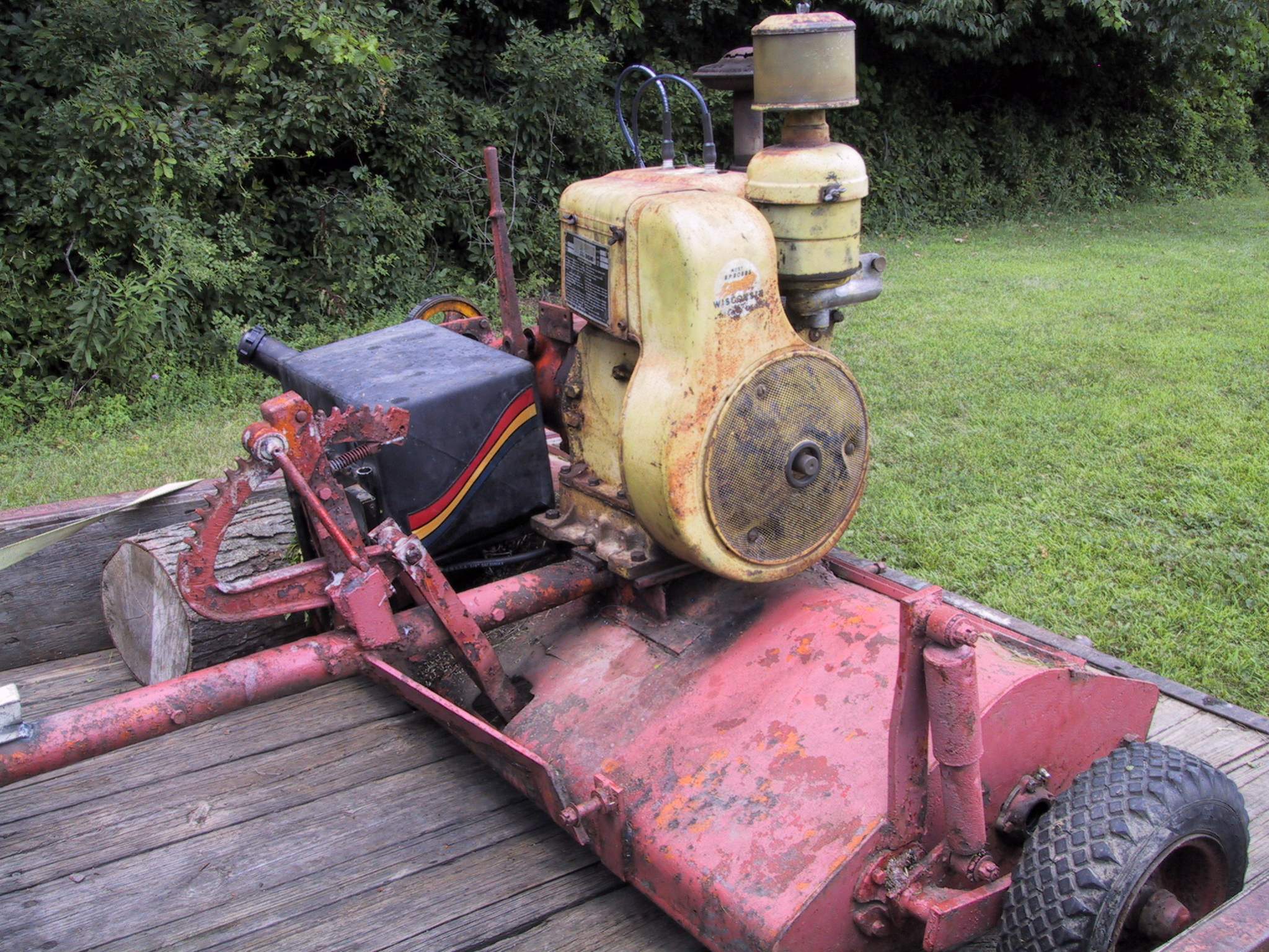

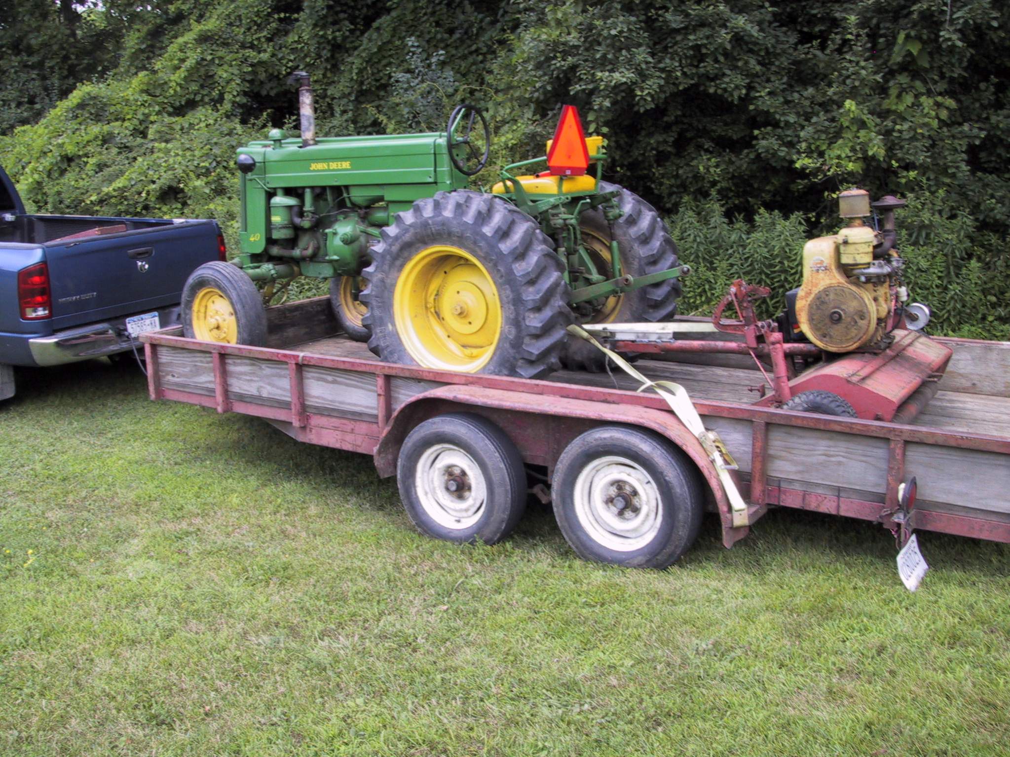

Well, got it up and running!:thumbsup: It starts on the first or second crank, and runs well! Mowed a path to the field that was to be mowed, but after a bit, one rotor bearing began smoking- Alot!:( Oh well, back to the shop. Not a bad showing for the first time out! The pictures are after loading up- didn't remember to get any in action... Flails are neat!!

Hello Ponderingjunkman,
I ma glad the "new to you" Flail Mower
is working well for you.
Sorry to hear about the bearing,
but as you are this far along you
need to replace both bearings
to assure that you have no
further issues with it.
If you require replacement grass slicer
knives you can obtain them from
Flail Master and other suppliers.
I wish to welcome you "The Flail Mower Nation" as a new member.
