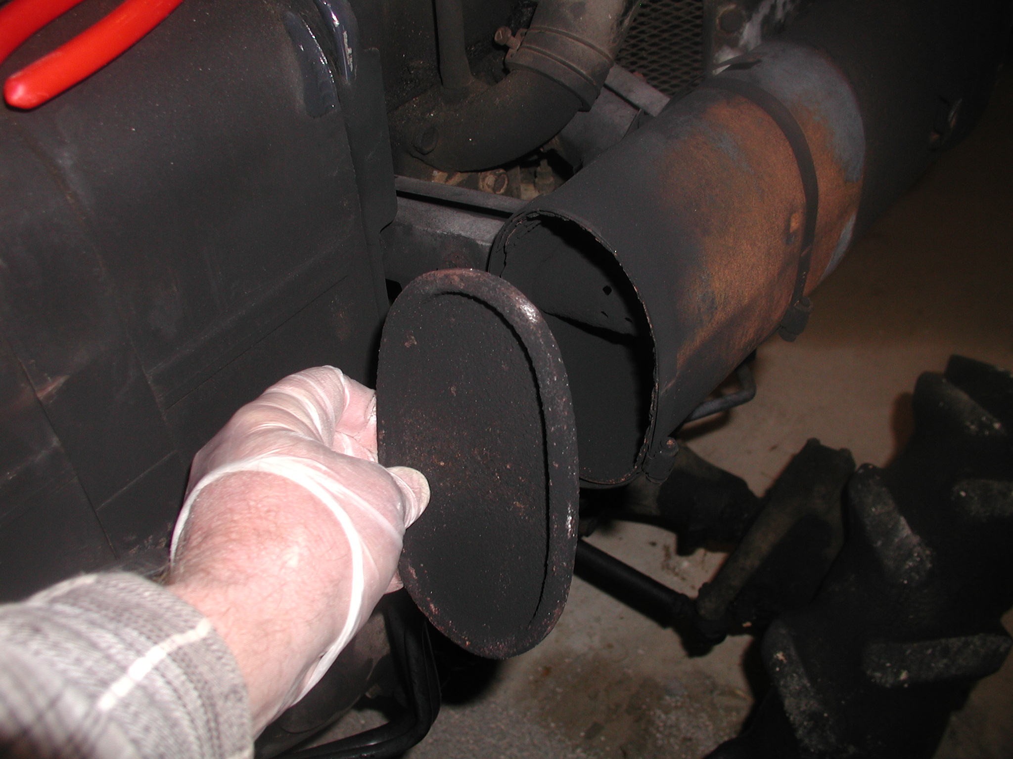

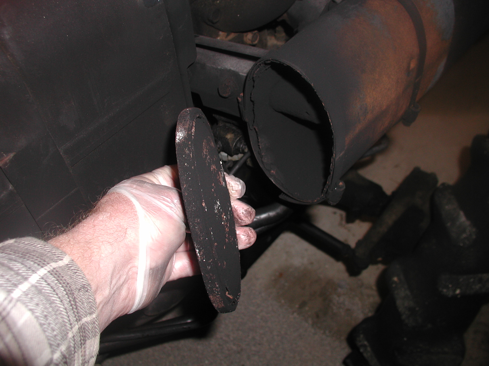

Muffler is leaking, I thought I would just take it apart and weld a crack. Its a bit more complicated so I wanted to ask the group about repair/replacement. In searching around this muffler is very expensive if it can be found.
I am open to any idea, I heard of one idea of making two stacks that go straight up.

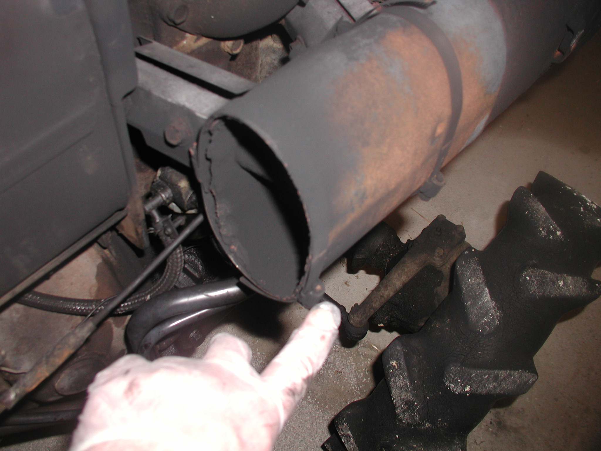

My pictures show the back of the muffler has completely rusted off, the second problem is a PO has wrapped sheet metal around the rear 3/4ths and held it in place with two large hose clamps, I am pointing out the rear hose clamp (where I would just like to weld on the back).
I assume I cannot just fix the back as I will have leaks where the sheet metal is.
I have more time than money, I am not a good fabricator/welder.
I need to keep this running for the winter as this tractor is my only way to blade my long driveway.

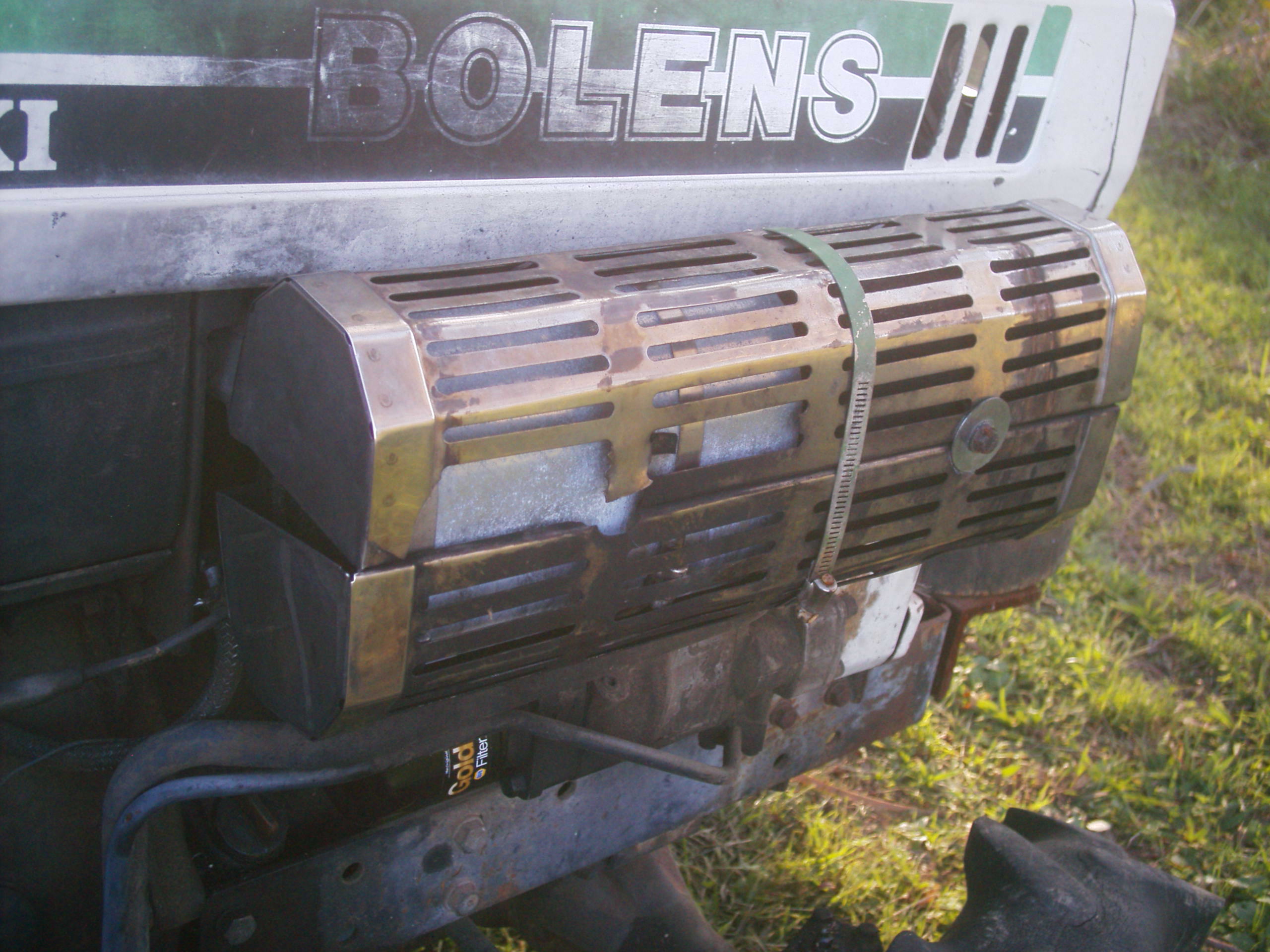

Here is the way I bought it the way the PO repaired (Fixed?) it. I might add its a great little tractor, everything works (except the temp. light), looks tired but starts easy and pulls strong.

You might want to hit up Leonard Sheaffer (sheaftractor@grics.net) and see if he has any good but used ones around. Pricing might not be as cheap as you'd like but it would save you some time. I don't really like how Bolens/Iseki built those mufflers. It's hard to find a manifold for the 2-cylinder tractors to install a normal muffler on them. Keep in mind Satoh tractors used the same engines so those manifolds would work also.
   / Anyone repair a muffler, any model, but this is a TX1500 2 cylinder #4
I repaired a muffler recently by wrapping a sheet of metal completely around the old one. Allow a half inch of overhang at each end so you can pop rivett into the sidewall of the end plates. (i.e. the bit you are holding in pic 2.). Also pop rivett along the length of the join. Use plenty of black silicone before and after to fill any gaps. Then paint the whole thing black. This sounds rough but it actually looks pretty neat if done well. As long as the guts of the muffler are OK and the end plates are sound you will wind up with a pretty solid result.

I like your idea alchemysa and pop rivetting is within my ability, Thanks! However I did find one 40 minutes from me for $150.00 used at West Kentucky Tractor, he says its in good condition, (Shaeffer's wants $200.00 plus shipping).
It dawns on me that I will need a gasket/gasket material, what would be recommended for that? I assume a new gasket is not available.
I posted too fast, Valley Power can get me the gaskets and I just ordered them.
Going to start soaking and resoaking the bolts for many days, I will run it up to operating temp before I soak them.
