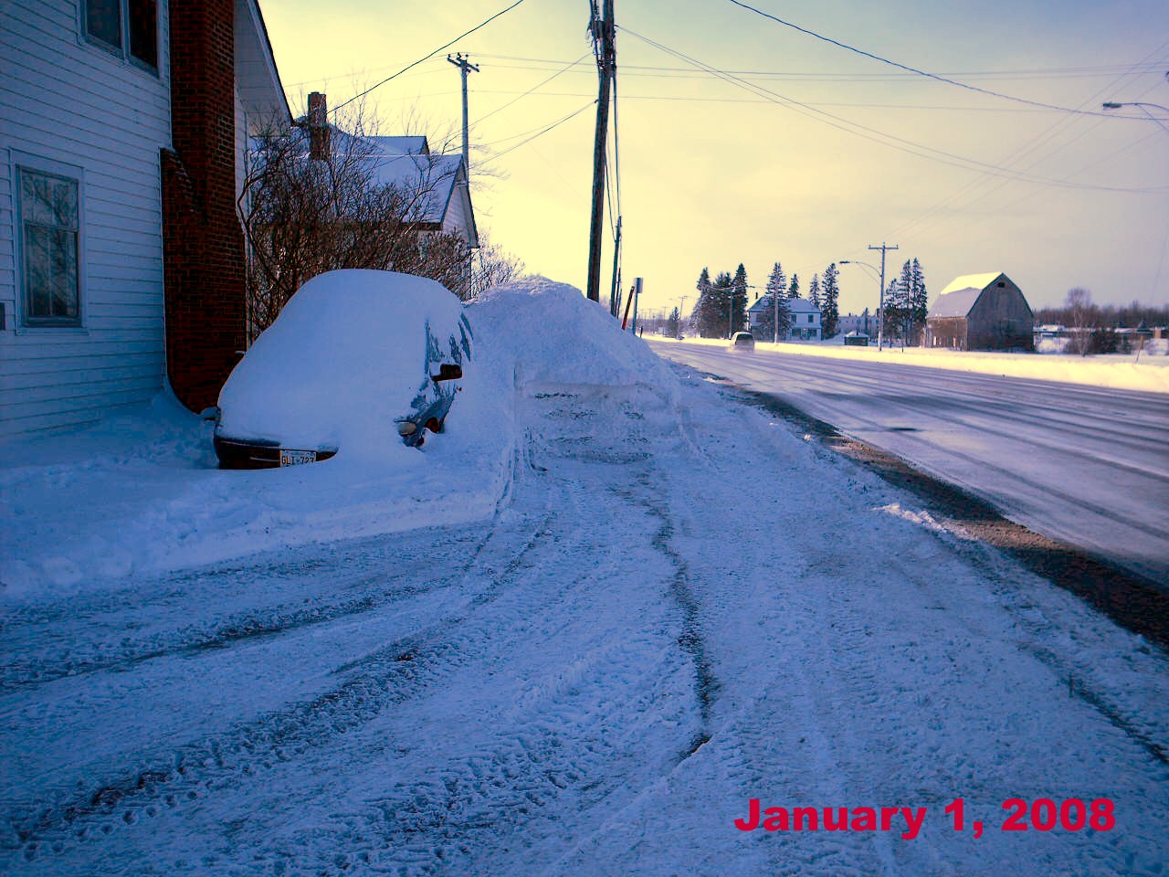

I run an old 72" blower on a Kubota B7800 (22 HP at the PTO, hydrostatic transmission). With the hydro, it handles it very well, even in deep banks of the wet, salty mess rolled up by the road plow. The hydro is the key - feed it slow enough in the heavy stuff to keep the revs up.
