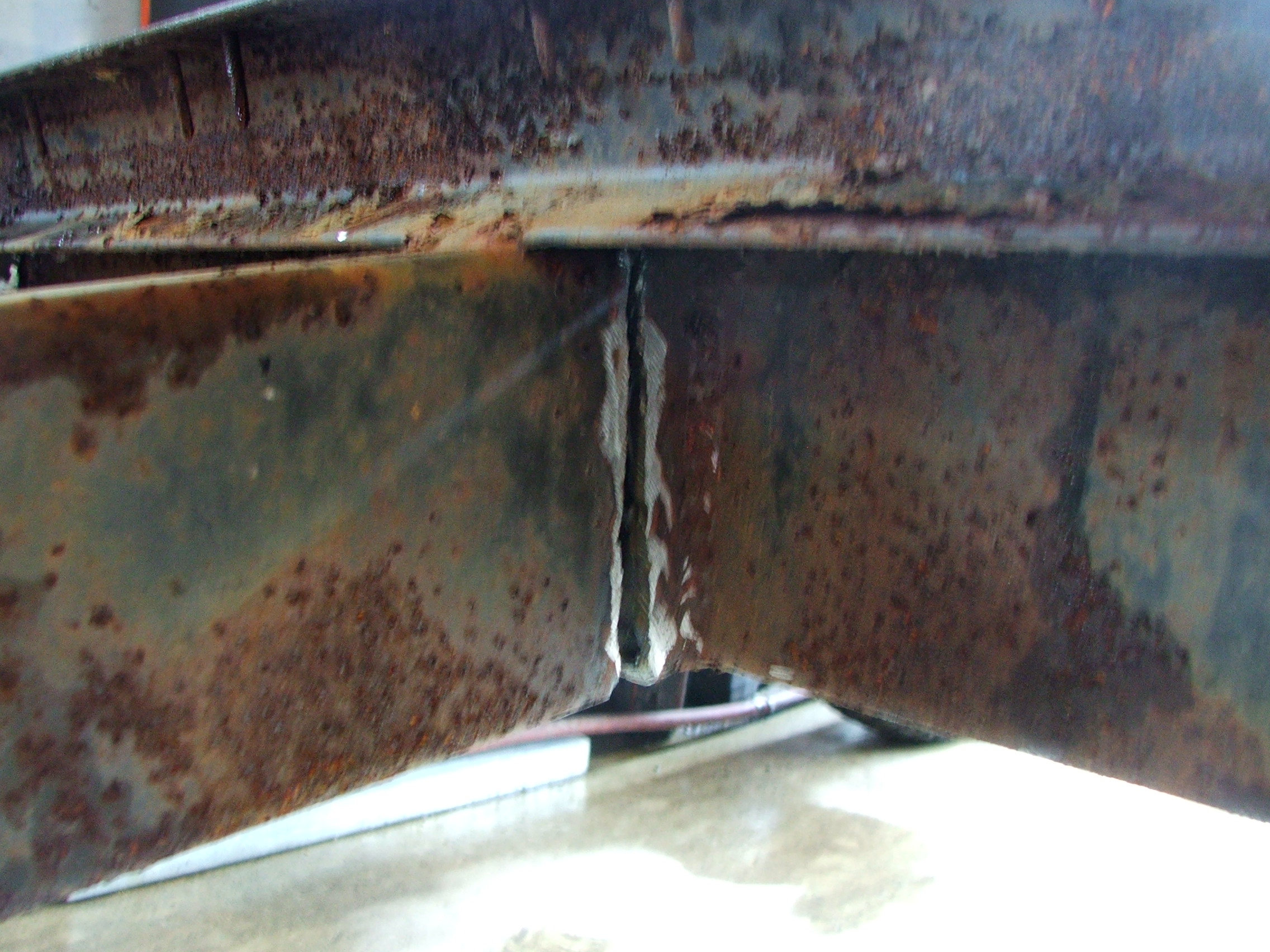

The issue is he used two pieces of Channel stood on end at the junction of the dovetail and deck. There is approximately a 1" gap at the top between the two and they meet at the bottom, right at the apex of the two angles. Therefore, to do it the "right" (I do see what you are saying) way I'd have to do a LOT of cutting. Much of it would be in tight quarters.
If I cut from the bottom and lift the tail, then bridge the created gap, the only thing other than the 4 main beams is the side rails, which are a quick fix. I'm no where near as worried about strength here because the leverage on the 32" tail is not as great as the force seen on the front extension I did.
If it was my trailer, I'd just flip the axles but I don't know what effect it would have on the brake mechanisms and the owner doesn't want to chance it.

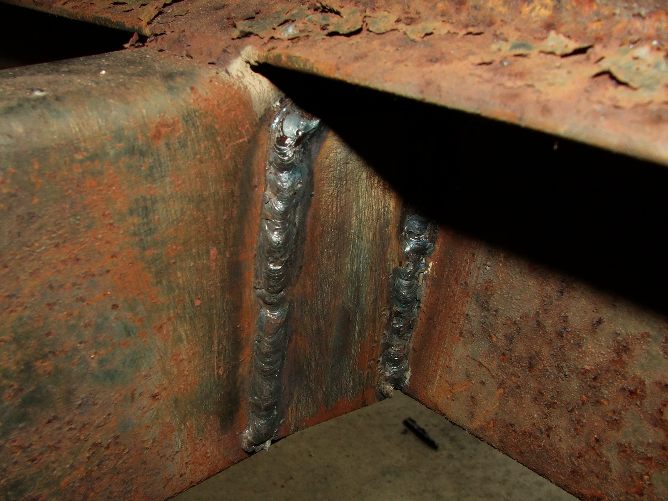

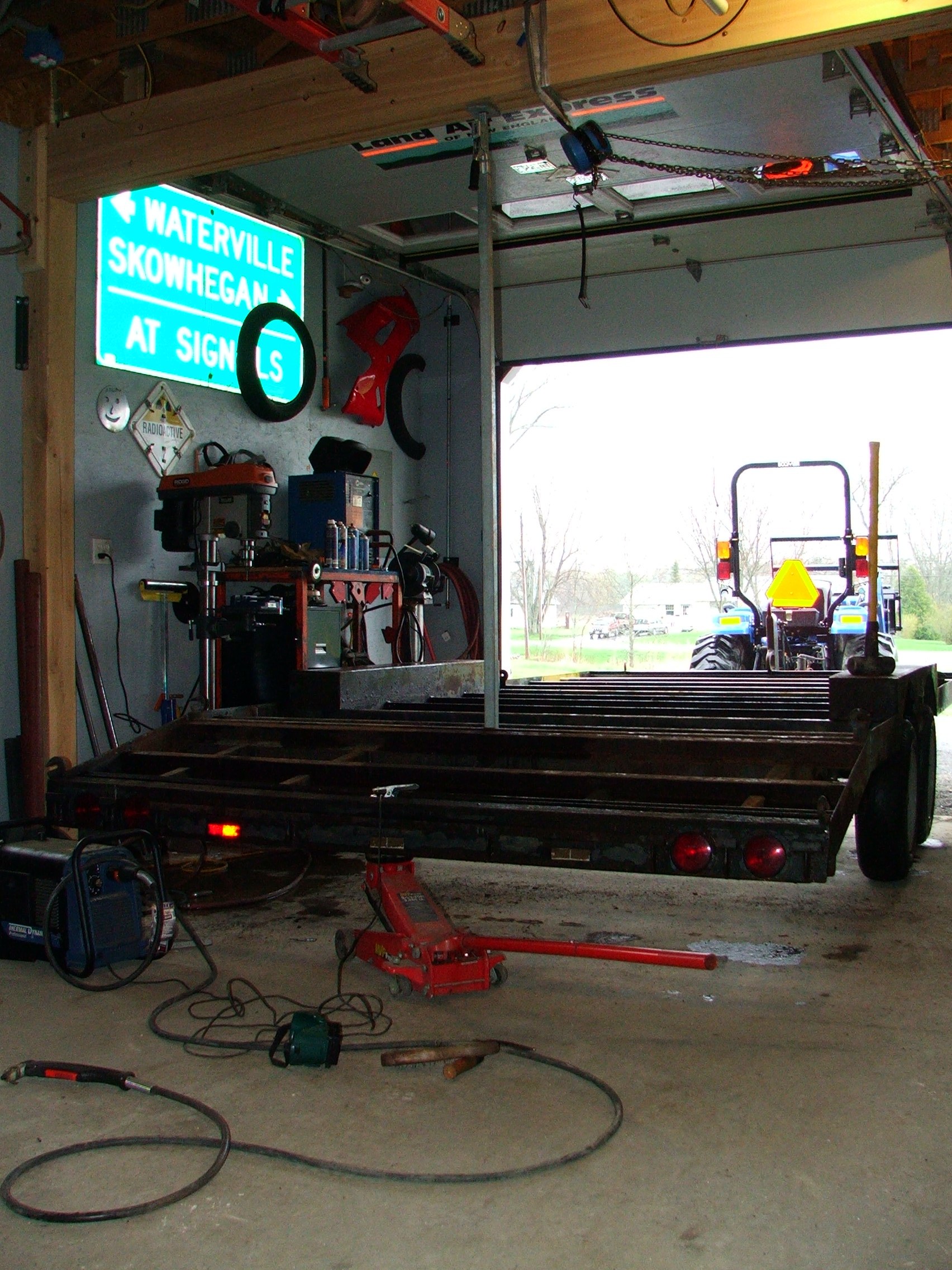

Anyway, I did what I originally planned to get rid of the steep dovetail angle. I sliced the beams from the bottom up, leaving the top intact. I then used a Load lock used in our truck trailers from the trailer to a heavy beam in my ceiling, then placed a jack under the tail and lifted. After some pretty noise (love the sound of rending metal!:D) I increased the ground clearance from 8 to 13 inches. MUCH better.

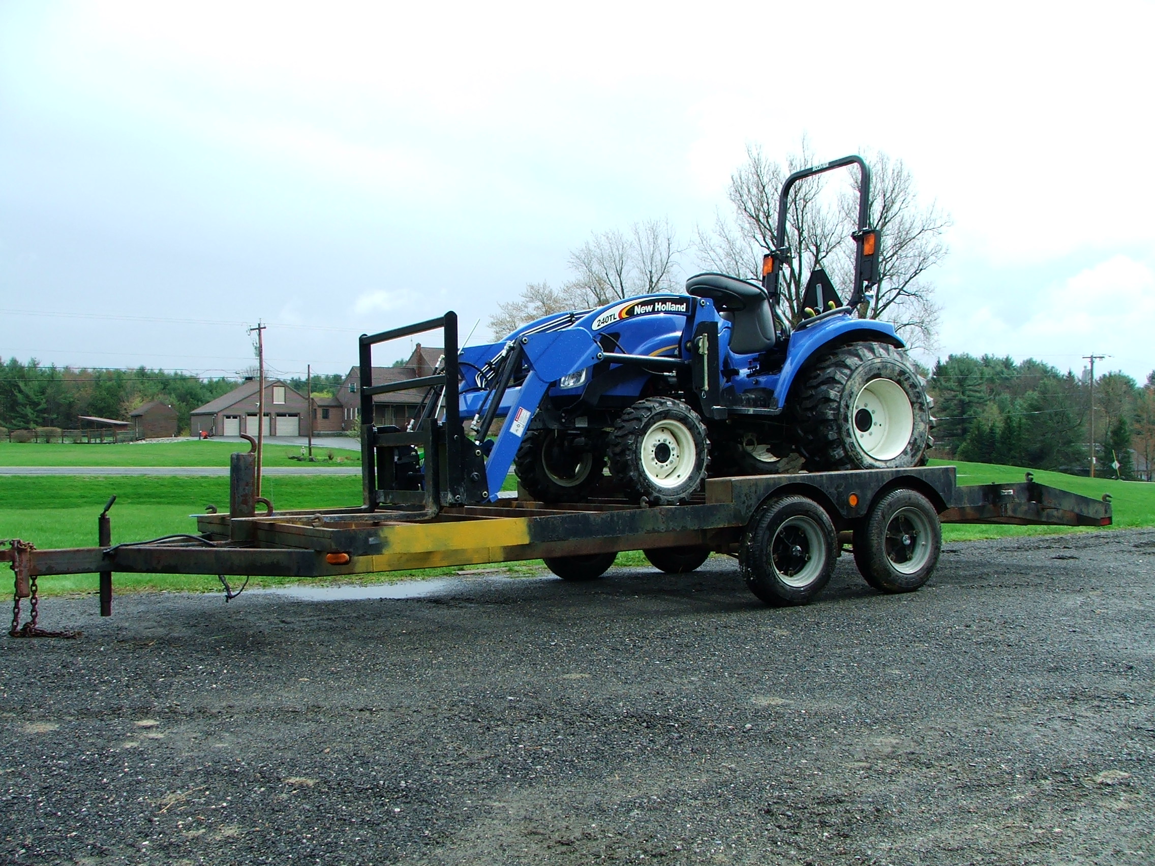

This trailer is going to ride HARD. I used my forks as "skids" and put the T2220 on it. The tractor weighs somewhere around 3500lbs and this trailer did not sag in the least. The owner was worried squat would decrease the height to much..... NOT!
Not happy with the welds. Off day and it was a pain getting the correct angles with all the structure in the way. I need a MIG!

I do need to punch some holes in the bottom of the frame. The builder did not. I have to say when you are laying under a trailer and punch a hole into a frame full of water with the plasma cutter, it is an invigorating experience!
