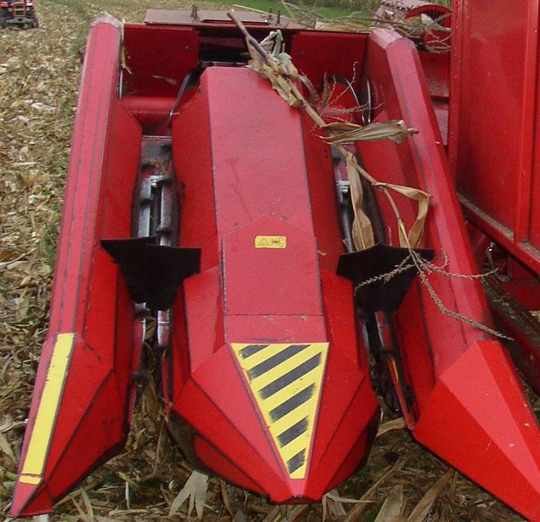

Paul is right,
You need driven "tooth" rolls to pull stalks down and take ear from stalk by hit 2 metal plates.
Even if system without rolls will work, it wil clodge permanently and it will be sloooow

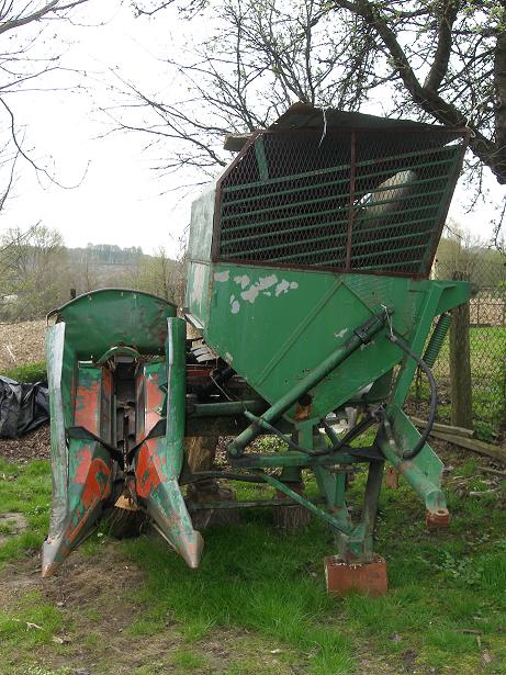

   / Anyone thought about building a corn picker? #28
That is a good picture! Speed is not important so long as the system works. At most I will have 10 acres. The crop will be dry, and if corn is 60lbs a bushel then Paul's 160 bushels an acre is nearly 5 US tons and four and a quarter tons an acre to the rest of the world. That is an impossible target to aim for in these parts. A ton and a half would be a good yield. Do you still think that size of crop would clog the stripper plates. If I could harvest an acre a day I would be very pleased. Old McDonald.
   / Anyone thought about building a corn picker? #29
Here it is.
I visited this guy today, and made some pics for you.
Picker is built from scrap parts, an that's why it looks like scrap /forums/images/graemlins/grin.gif

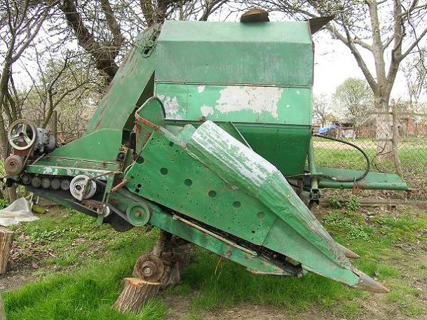

   / Anyone thought about building a corn picker? #30
Wheels are taken off for some other purpose

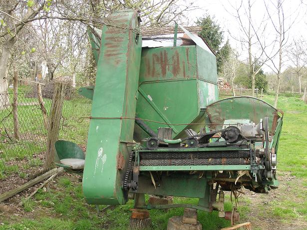

   / Anyone thought about building a corn picker? #31

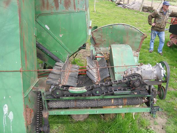

Husking table is made from rolls of two huskers, axles are from old combine ...

Ear pushers over husker have pretty modern drive: rear end of Vespa or something like that, with gearbox and 4 speeds ...
Owner and builder, stays on right

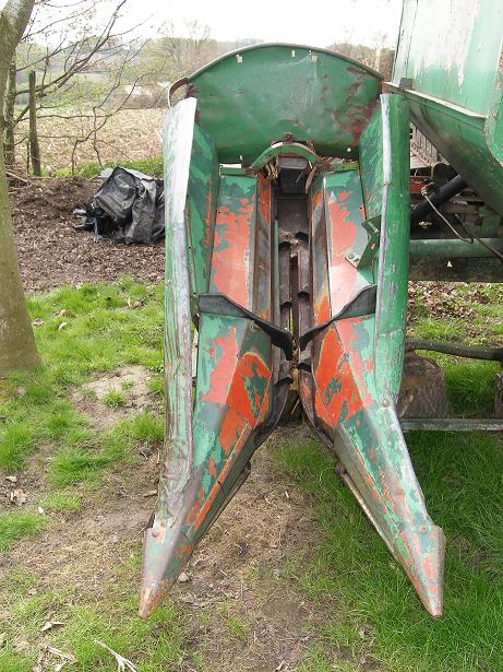

   / Anyone thought about building a corn picker? #33
Picking table is taken from 2-row from Laverda corn head, bought as scrap iron ...

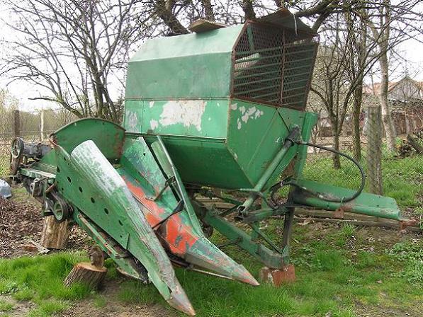

   / Anyone thought about building a corn picker? #34
Wheelbase is short and machine is very manouverable ...
