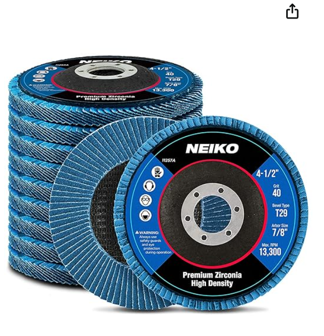

It’s funny that I have been rotary mowing for 35 years and didn’t discover how nice that flap discs work for this purpose.
   / Anyone try sharpening bush hog blades with flap discs? #12
Started using them last year on the Krone hay mower and really liked them , the only time I use anything else is when I remove the blades from a machine , like on one of my Gravely zero turn mowers, then it's usually the bench grinder.

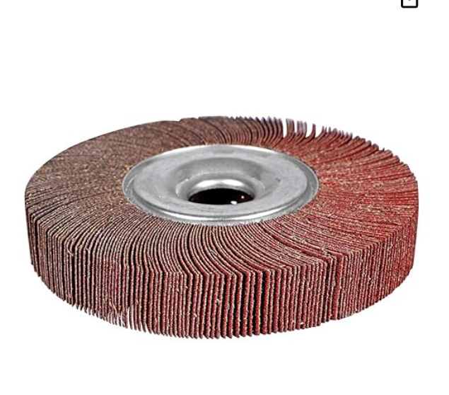

My bad - I misread the original post to be referring to a flap wheel not a disc. I use a flap wheel on one of my bench grinders. A variation could be used on a drill which is what I thought OP was asking about.
I too use flap disc on my grinder in the shop and for reshaping the hammers on the mower.

I had always used grinding disc until my SIL had me try using a flap disc... flap disc ever since
   / Anyone try sharpening bush hog blades with flap discs? #15
I keep 2 grinders at hand in the shop. One with a regular grinding wheel for heavy stuff and the other with the flap disc.
One of them is always the right tool for the task at hand
