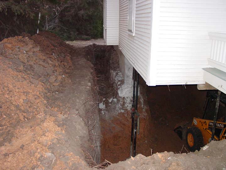

We had a basement put under our house. It was a very interesting process. The house was not elevated, they supported the walls, put the forms up and pumped concrete into the walls up to the sill plate of the house. They used 2 skidsteers. Here is the beginning hole.

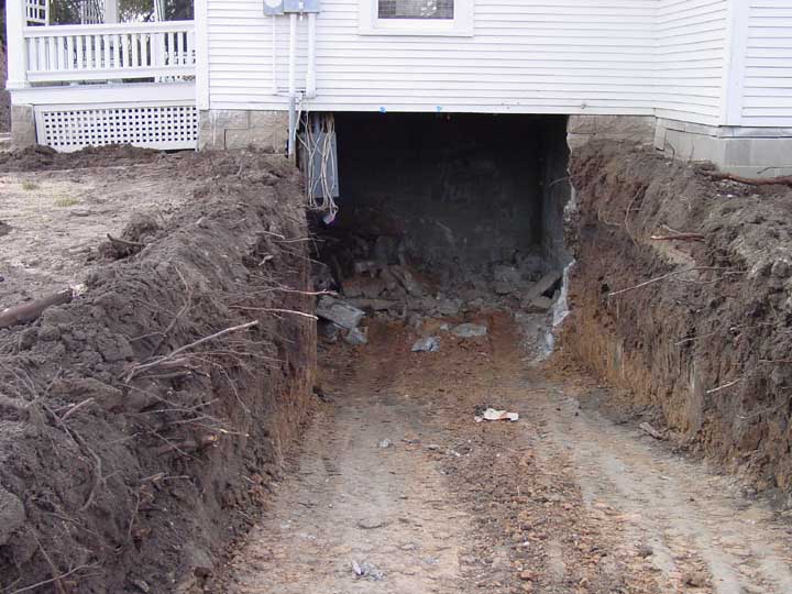

   / anyone try to dig a basement under House? #22
The supports and forms in place
   / anyone try to dig a basement under House? #23
Sorry, that last one was half the house in the air. Here is the supports and forms.

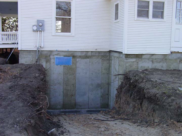

   / anyone try to dig a basement under House? #24
They poured the walls in 2 pours. Here is what it looked like after the 2nd pour.
