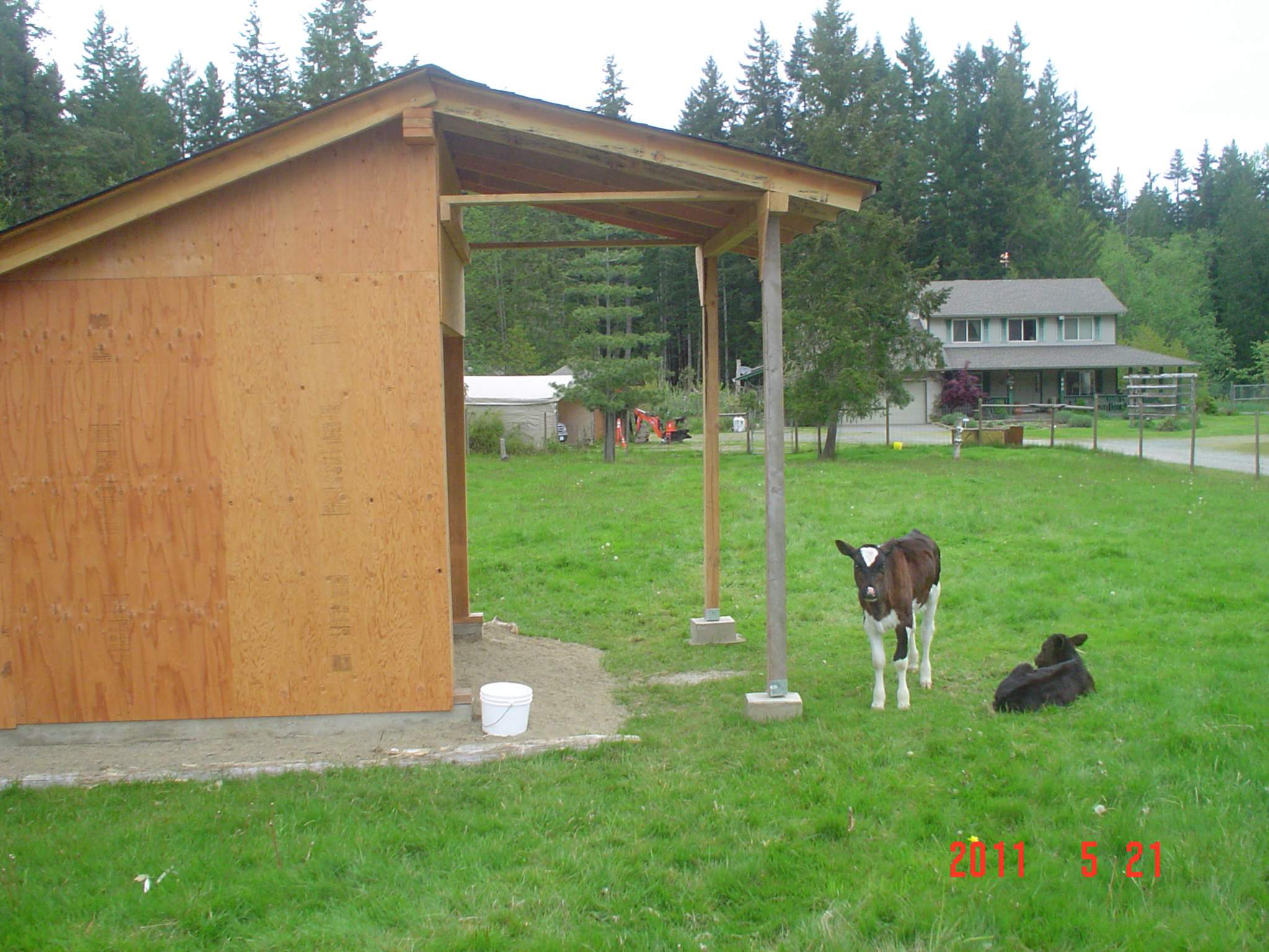

We have a smaller pasture in front of the house that I built a simple calf shed in. There is a gate at the back to a much larger pasture for my two calves. At first I closed the gate at night with the 2 calves in the smaller pasture. Main reason is we do have lots of black bears and cougars in our area. Just feel better having them close to the house. Now the calves always come on there own into the small pasture at night. In pic #1 you can see the gate on the left side. :)
