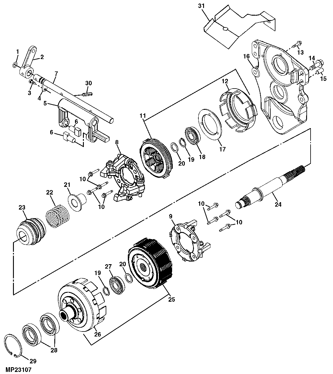

Anyway, since I don't have a service manual for the 3x20 series machines (for theory of operation), I did the next best thing...went to JDParts and compared the PTO systems between the 4400 (although the 4410 might have been a better comparison) and the 3720.
These are both illustrations for the PTO system...not all inclusive, but shows the components.
The 4400 uses a clutch and brake (items 25 and 11, respectively), the 3720 uses a clutch that appears to combine the brake and clutch in one assembly (due to it's greater number of friction disks). I did look at the 4410 (HST) which as a very similar arrangement (didn't save the illustration though).
So, it appears the 3720 does use a PTO brake (although the terminology is clutch).
That's my interpretation of the illustrations.

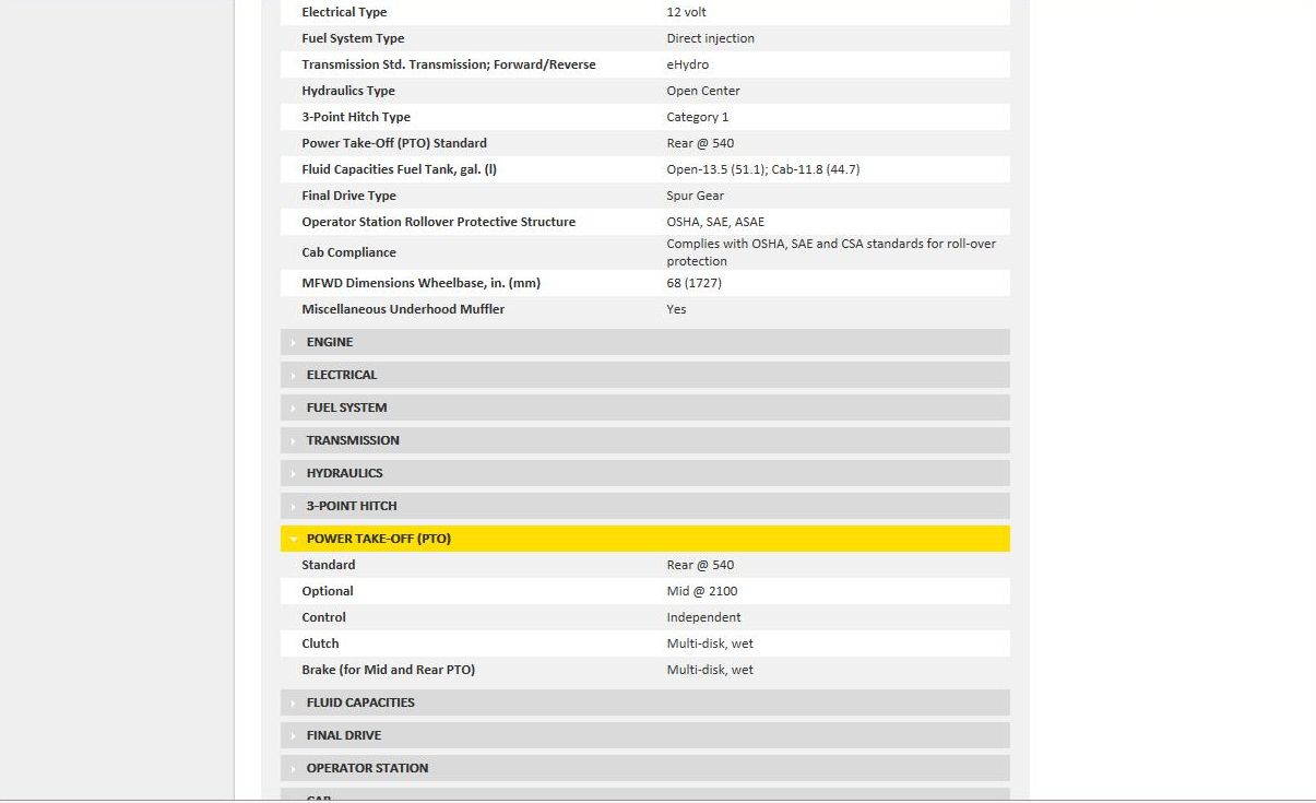

ADDED: Although I was surprised to find it on the Deere website, there it was:
JohnDeere 3720 Compact Utility Tractor 3000 Series Compact Tractors JohnDeere.com
under the specifications tab.
I also added a screen shot...note the yellow high lighted section. The 3720 does have a PTO brake (and I think I was correct...the brake and clutch are one package now, rather then two discrete assemblies
My JD2520 has a brake, next time I am running the chipper I will pay more attention to how quickly it stops, but I would guess within a revolution or two.
Well, yes...your 2520 does have a PTO Brake:
http://www.deere.com/wps/dcom/en_US...drive_tractor/2520_4_Wheel_Drive_Tractor.page
Look under the specs tab.
