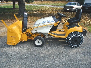

Completed Blower, Chains & weights on my 3204....just need the snow ( i hope it snows this year /forums/images/graemlins/blush.gif )

I've got a Cub 1862, which is about 9 or 10 years old so it was built prior to the 3000 series, but is still very similar in size (mine has an 18hp Kohler). I use a 48" blower on the front of it, with wheel weights and chains, so the set up is very similar. The blower has a front mount that is also similar but is belt driven. I used it to clear our drive for 8 winters without any real problems except for one broken shear pin when I accidently found the garden hose that I forgot to put away before a surprise snow storm buried it. Anyway, it takes a lot longer to put the blower on the Cub than it does to install one on the back of a CUT with a 3pt hitch, however it works very well and I am very satisfied with the unit.
