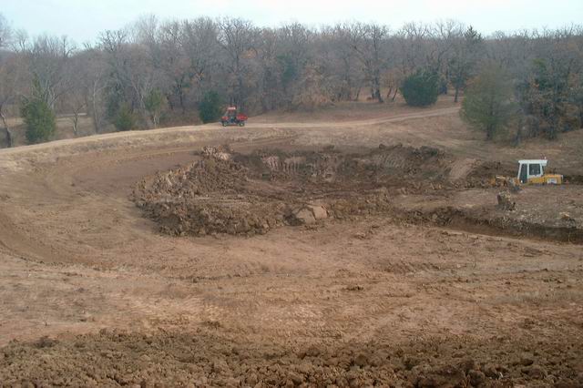

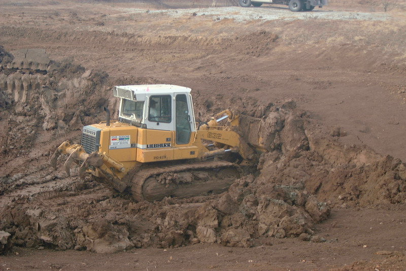

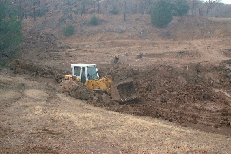

I think you are going to waste your money on that pump. With your limitations I think you need a dredge style pump that removes water and solids, filters out the solids, and returns the water. I think you are going to find that the mud/muck is 75% or greater solids and the pump simply cannot pump out the muck. Think of a concrete pump. That's the kind of pump you need for the described task in your pond. Otherwise, you will just have to sacrifice some trees so a large excavator can get into the pond.
Silt is something I have a lot of experience with. Mud/muck takes forever to dry. It can look dry and crusty on the surface and be "pudding" underneath. My pond had been dry for 6 months when this dozer arrived. He had to dig a trench deep enough to be on the native dry soil while removing the silt. At some places, the silt was 10' deep in my pond. An excavator with a very long arm can reach in and dig out the silt, but I think your silt is too dense to pump and to thin to drive in a dozer or other tracked vehicle.
