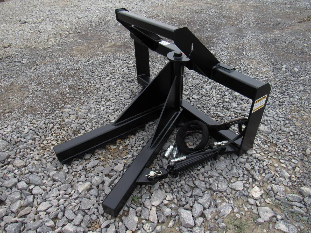

I have been planning to get one of these as well for my MX5800 as I have some small creeks that run through my property and I think this would be a good way to be able to pull some smaller trees from the banks to clean things up. It is all well overgrown right now. The Titan has great reviews. I also found this one not too far from where I live on CL.
I like the idea of the top bar to help push on the trunk while trying to dislodge it. I know I don't have the capacity to just lift most out, but I think with some movement most will come out. Downside on this one is I think the frame needs some beefing up at least behind the teeth. Seems like it could twist easily with some stress. Trying to decide if I want to add the top bar to the Titan or beef this one up a bit. Anything stand out to anyone on which may be a critical differentiator?
Leaning towards the Titan and adding the top bar to it. Wouldn't be too hard although it is about $150 more expensive.
