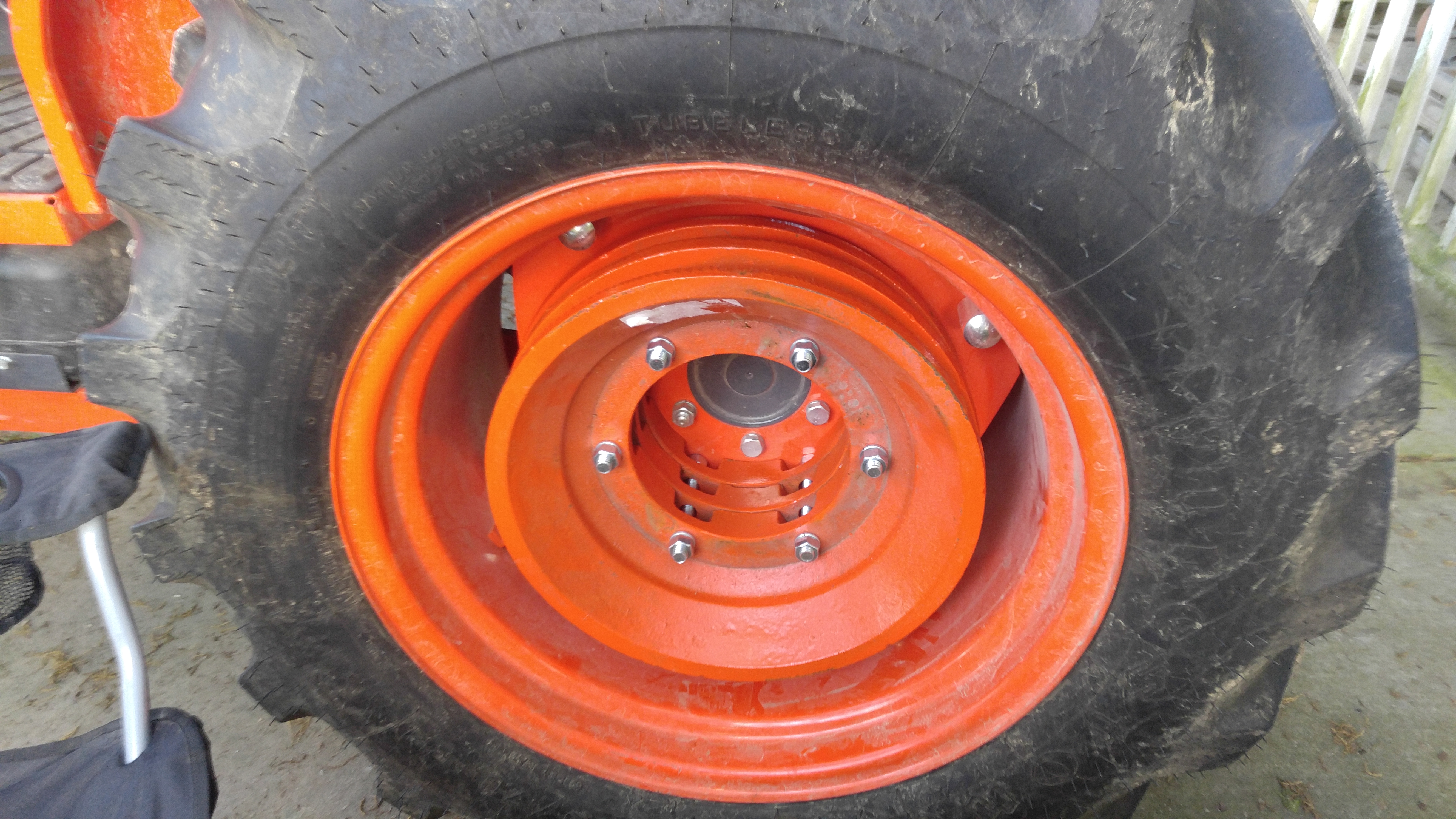

JJP,
We’ve taken out close to 60 locust trees so I don’t want to mess with fluid or weights. The thorns of those thing are awful! Finally slimed out ATV tires because of flats. Skidsteer had around 6 flats on brand new tires which was irritating. Don’t want to have any difficulties being able to remove a tire.
My plan Is to get a cat2 ballast box and fill it full of cement. I should be able to get 1100-1400 lbs back on the 3point if I am needing more ballast than a brush hog can provide
   / Anyone use a tree and post puller on a Kobota MX5800, Grand L series or Kioti NX6010? #12
Makes sense to me. While I doubt it'll be needed, the wheel weights shouldn't get in the way of tire removal unless they are of a different design than mine. The ones on the L3560 attach to the inner hub only and don't interfere with access to any of the wheel mounting hardware. Just for informational purposes I've attached a picture of the full set installed.
However, if you can do what you need to without having to add wheel weights or liquid ballast (or worse resorting to foam-filled tires) that'd be ideal.
One of the things I forgot to mention earlier was that with the Intimidator upfront, and a 700-800lb finishing mower on the back a short wheel base (like on the L3560) can mean the two implements on either end make the tractor a bit bouncy in a teeter-tottering way. It's usually not a problem as all the wheels stay on the ground, but it's something to be aware of since it can occasionally be a bit unexpected and cause further operator induced rocking. First couple times it happened, I mistook it for the start of the rear-wheels coming off the ground so reacted accordingly and my actions introduced additional rocking of the sort that had started to dampen out.
However, I haven't seen the problem arise when using shorter ballast implement (e.g. the box blade) on the back though, and that combined with the wheel weights pretty much eliminated the problem for me (which implies a heavier short ballast implement would likely work just as well).
Anyway best of progress (I've had to remove a few Bradford Pear trees that had spikes on them so I can definitely appreciate not wanting to deal with tire difficulties).
