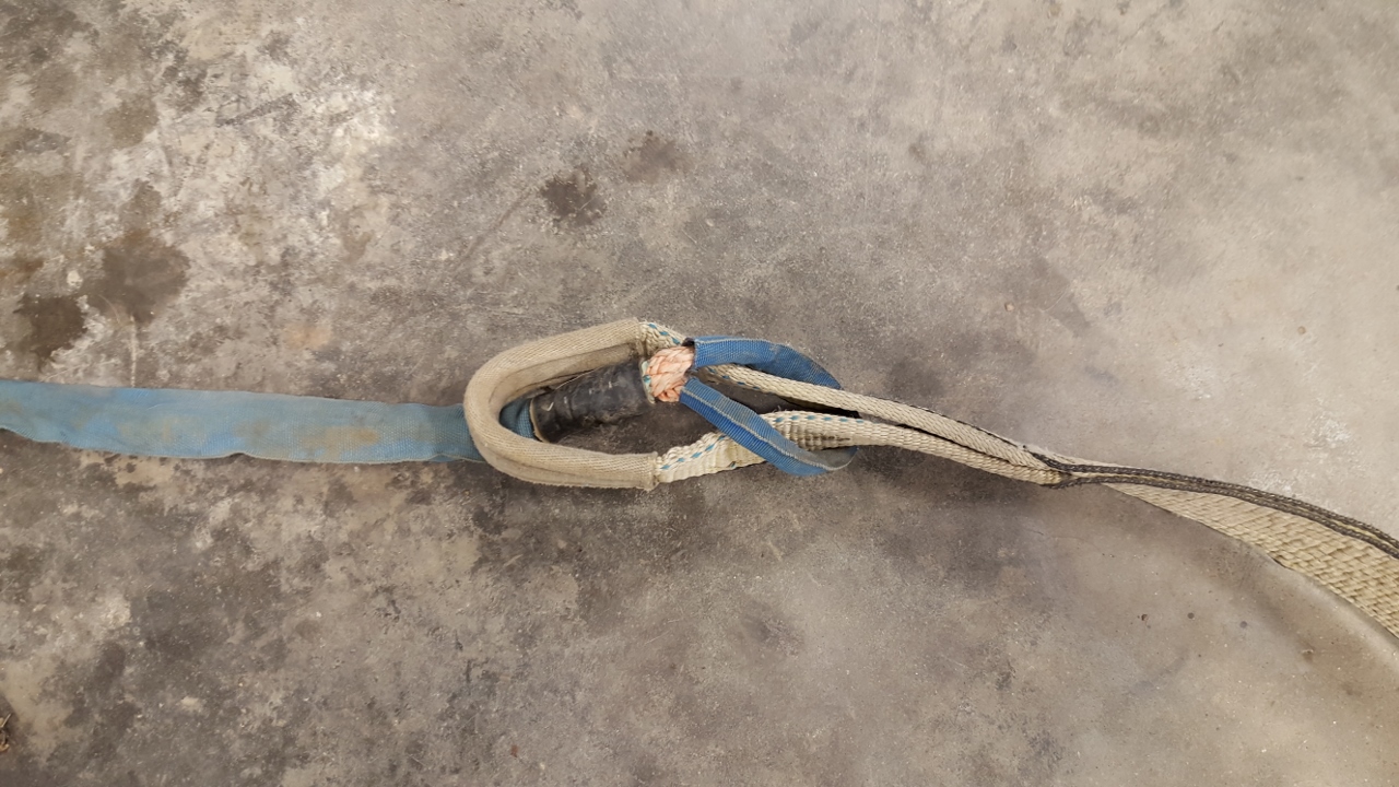

I recommend a breaking strength many times stronger than the weight of the "tow" vehicle. I don't use any rigging ropes or tree straps with less than 30K break strength. You will invariably back up to get some slack and then yank it. Things get ugly quick doing that.
As for tying them together. There is a wrong way and a right way. As Redneck said, if you do it wrong you will more than likely have to cut one rope to get them apart.
First picture is the wrong way. It's accomplished by running loop of rope #1 thru end loop of rope #2. Then taking other end of rope #1 and running it thru it's other end loop, the one you just poked thru rope #2 loop. This is the most common way to loop two objects together and has been misused in this application thousands of times and caused the destruction of thousands of ropes.

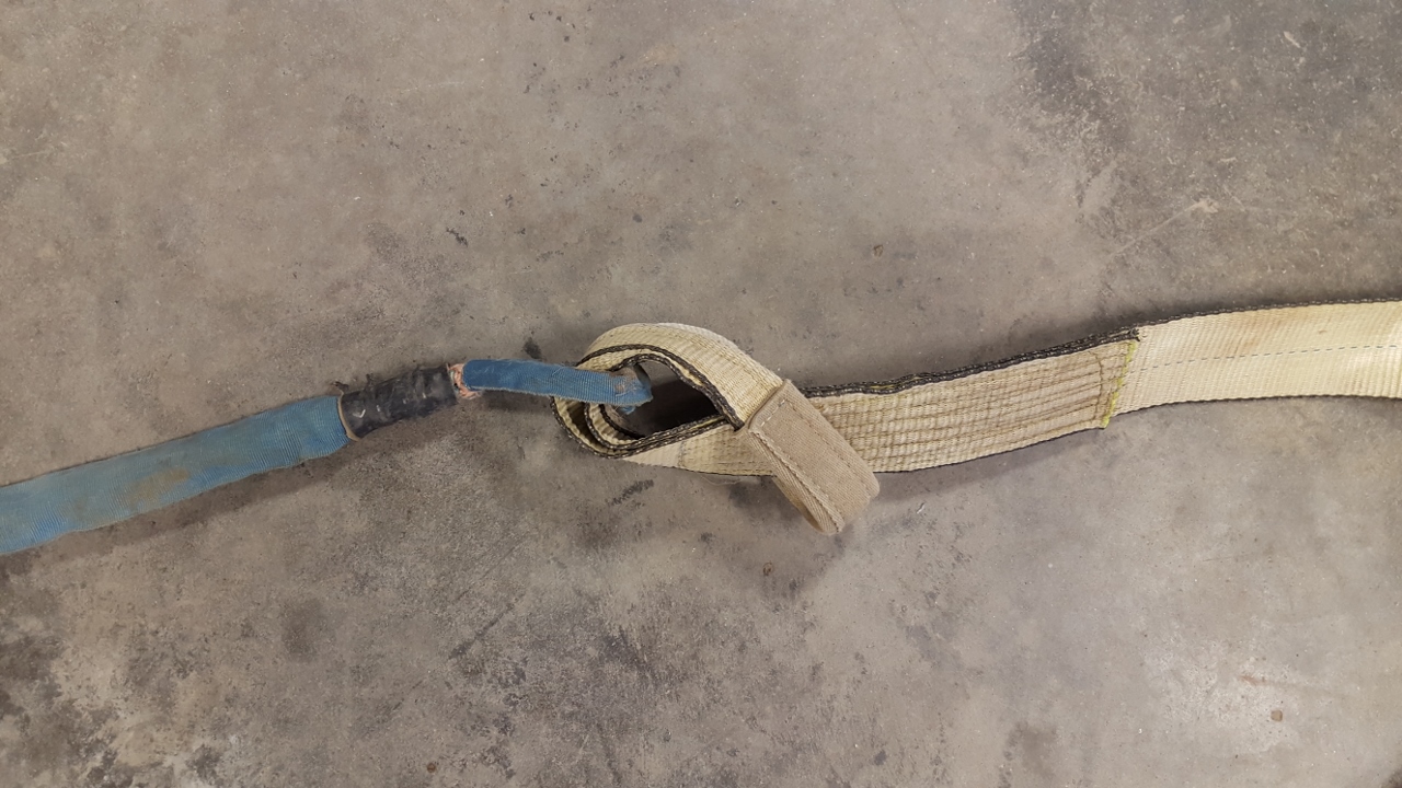

Second picture is the right way. It's accomplished by running loop of rope #1 thru end loop of rope #2. Then taking other end of rope #2 and running it thru the loop of rope #1 that you just poked thru rope #2. Clear as mud right. :)
