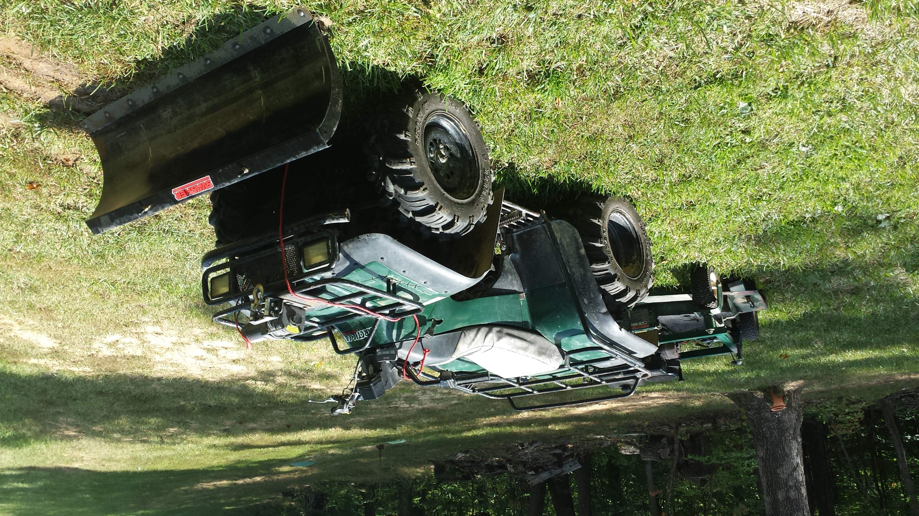

I have a '98 Polaris335 Sportman with a 4 foot plow that I use mainly for snow plowing at my cottage. The driveway is 250 ft long. I use the cottage about 4 to 6 times a winter. The only snow that gives a problem is the berms the road plows leave if they have a chance to harden before I get to plow them. I found quickly that low range and 10+ mph works best.
