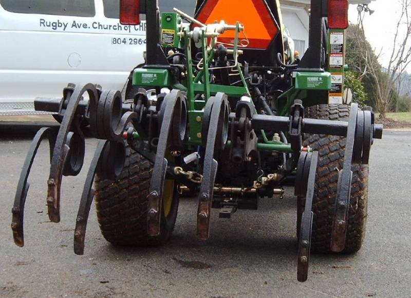

Here's mine, mounted an old JD M soil ripper diamond bar.
The soil ripper mounts onto a drawbar hitch mounted on the 3PH. Some special clamps had to be fabricated (by a friend of mine who gave me the soil ripper) to hold the disc hiller shanks.

My discs run right behind the wheels. Can't do that mounting them directly to that 3ph drawbar, not wide enough.
Agri Supply sells something calls a Keulavator and includes the hardware to attach some discs. I ordered my 20" discs from Agri Supply. Later ordered some 12" ones that I combine with the soil ripper plows and work them together to rip at the raised rows and to clean out between the rows. Alas! I've plastic down now (old leftover stuff that I decided to use) between rows and don't till the rows. So, all this is sitting unused until I decide to completely redo the garden again, or to create another.
