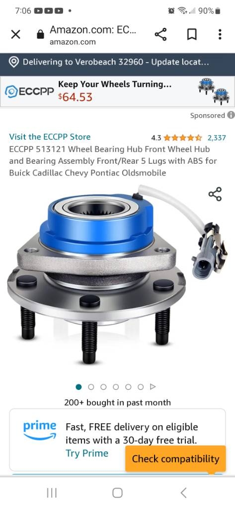

Do you think this might work? Front wheel drive cars often have a hub assembly that bolts to the McPherson strut. Many cheep chinese knockoffs on ebay
