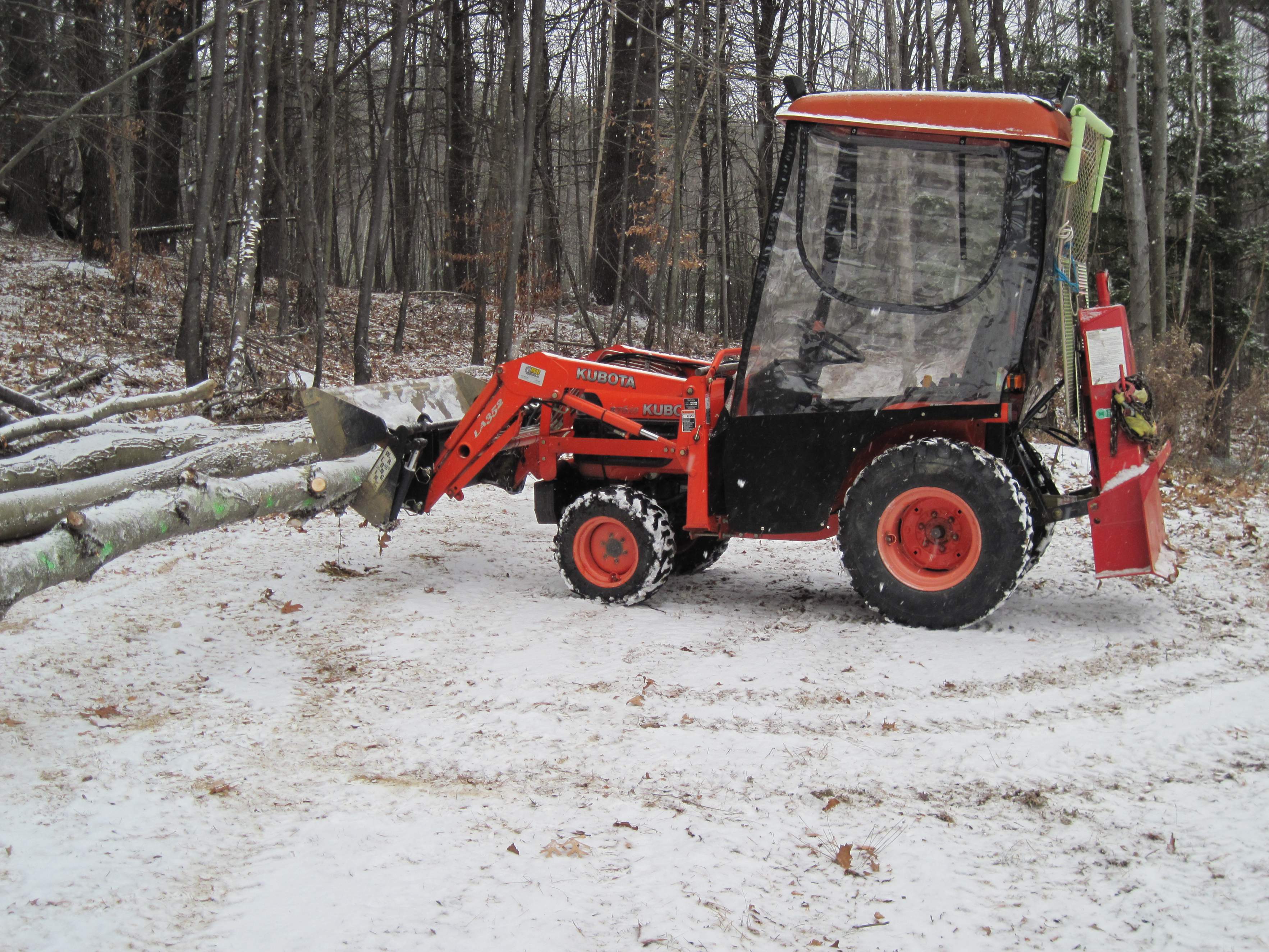

Only action picture I have is this one when I was stacking up logs that pulled out before winter set in.
I have no issues with the weight or lifting things. Actually I am always surprised at what it can lift weather it is the 4in1 bucket or the grapple.
I think I paid around $1,800 back in 2010.

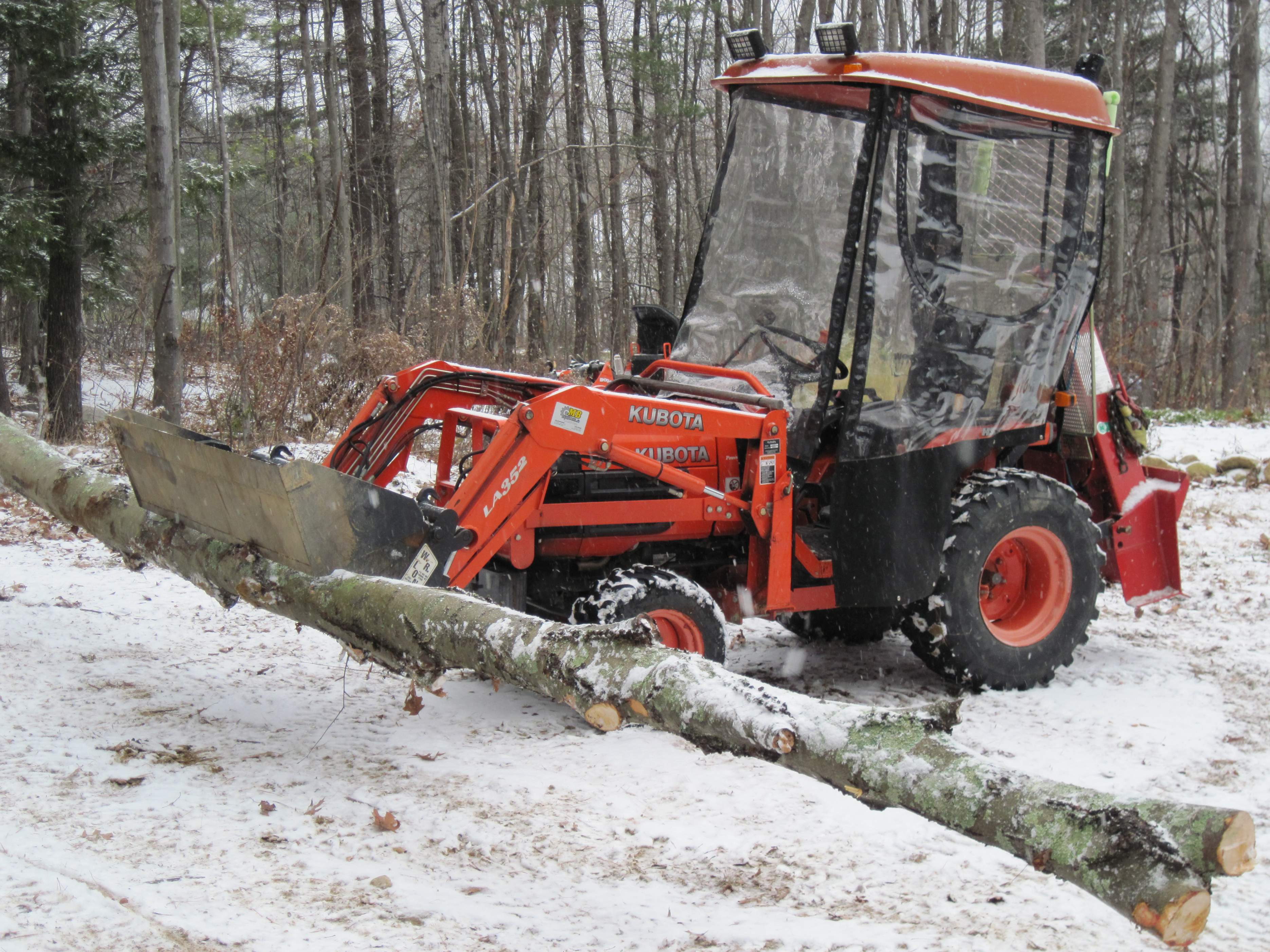

Here is the other picture that did not post.
