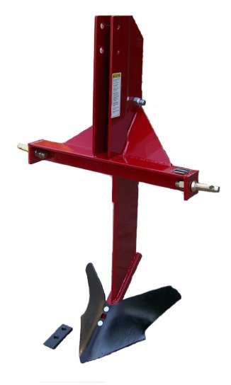

I'm thinking about buying a three in one Howse subsoiler. It is a combination subsoiler, middlebuster and can be used as a hitch for a trailer. Apparently these different parts are a matter of removing and bolting-on the different attachments. I was wondering if anyone has used this implement, and has any comments regarding the units quality. This picture shows a little about appearance of the implement.

I have one and it bends easily being made of only the finest Chinese steel. My mighty 29 hp Kubota is just too much for it. So enjoy.
   / Anyone using a Howse Subsoiler? #3
I bent the foot on mine while ripping some old cedar roots. I got the root out but it was so big that it got stuck under my Branson. That 3pt hitch has some power. :thumbsup:

Actually there were two different attachments when I bought mine. I bought what was the Middle Buster, removed the sweep and bolted on a pointed chisel. The "Subsoiler" had a flatter foot angle than the middle buster and might be stronger "or not". Otherwise the two are identical. The forged chisel I put on might be a little longer and therefore more leverage on the foot. Understand, I not only bent the foot but also the 2 5/8" bolts holding it on. Hey, I got the stump out.

This culprit here was an old cut cedar, about a 15" tree. You never know if a cedar has rotted or not. Either way they last a long time in the ground. I hooked the chisel under the stump and then raised the 3pt to pull upward. I did this several times, finally tearing it loose. I'm 6'1" and 220lbs and it took all I had to roll the stump into the bucket.
No, I wasn't surprised that I bent the subsoiler, nor was I upset. The labor it would have taken to dig out that stump would far outweigh the repair on the subsoiler.

Chinese bolts no doubt. Howse is located in Laurel, MS about 80 miles from me. When I discovered an almost local manufacturer I was delighted. I bought a dirt scoop from them and it lasted one weekend with my mighty 29 HP Kubota. The dealer took it back and said he had never seen a scoop bend like that. I got a King Kutter and have been happy ever since. I had also bought a Howse multi purpose, sub soiler and middle buster. The large horizontal angle iron holding it together is what bent on mine. Plus the furrow broke in two. When I called Howse to complain the company itself said the steel was fine Chinese steel, so I did not make that up. Since then I have been a no House zone and very happy.
