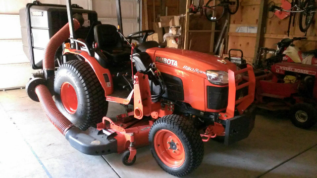

Well, since no one has replied to your post with the specific setup you are asking about, I will give you my .02c about something close. I have a B3030 with a 60" mmm. I think it does a good job as a lawnmower. It is a bit on the heavy side if you are looking for a show place lawn. If the ground is soft it will leave slight tracks whereas a lighter machine would not. On the other hand it does ride good and is very comfortable to operate. When mowing I usually drive in M with a full HST pedal. The ability to change ground speed with the HST as conditions change is fantastic. Reversing for turns and around obstacles is effortless. Of course that is true any time, mowing or not. I took the back gauge wheels off of my mower and used chains and hooks under the tractor frame to semi-suspend the deck. I did not like the tracks left by the center rear wheels. I adjust the hooks that hold the chains so that the front gauge wheels are about a 3/8" off the ground.
