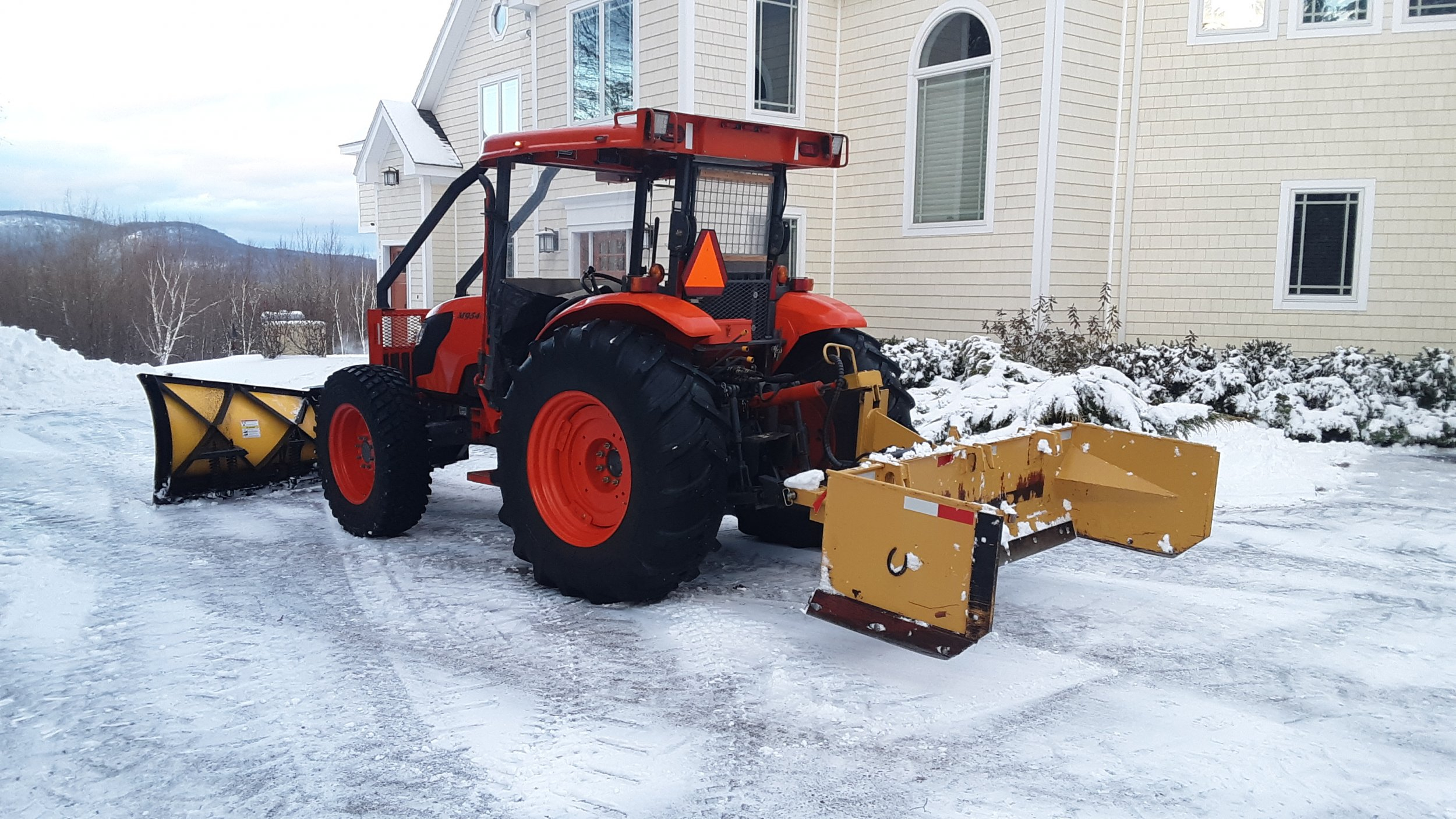

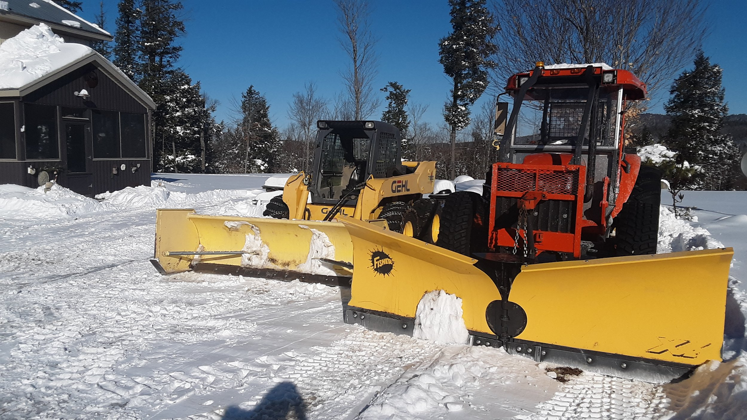

I wouldn't go more than about 20" or so wider than the tractor for the heavy roof drop snow. I have a 8'6" but it's on a 5 ton SS with 110hp. My routine is first "shaving" off what I can, usually with my tractor that has a 9'6" Fisher V blade, then back drag/dig out the rest just far enough away from the building to be able to either use the V plow or the rear pusher (or both, no turning around the tractor)
to carry it off. Sometimes I don't feel like switching bucket/pusher on the SS.
to carry it off. Sometimes I don't feel like switching bucket/pusher on the SS.View attachment 718850View attachment 718851
Wouldn’t the skid steer do better with the chains on the back since most of the weight rides there? A Gehl 7800 is a beast. The average person don’t realize how much muscle sits in that small package.
   / Anyone using a Snow Bucket / High Volume Bucket? #18
What can I say, I'm lazy 😆
I have a set for each axle if it gets icy, but for stacking - you know how the weight transfers to the front with lifting. 👍
