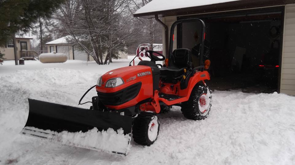

Agree whole heartedly. The wetter or deeper the snow, the more the angle allows you to keep momentum, which is your friend in moving snow. I've pushed snow, tons and tons of it with a front blade, double hydraulic, for a decade up here. Only way to go. Not saying a pusher isn't right for some contexts, but i'll be staying with the blade.

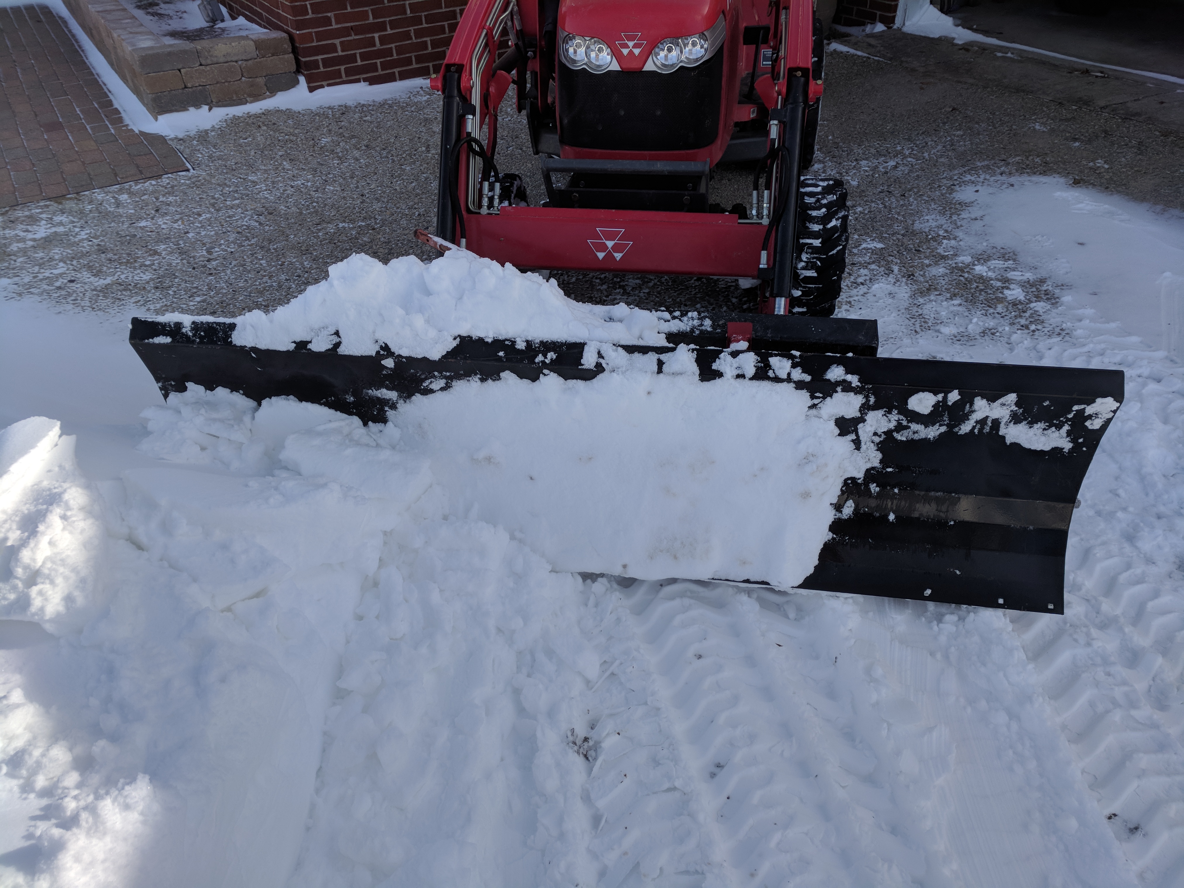

I've had the 60" dozer and it's a brute. The 54" also works very, very well.

I agree on the traction/weight issue, although I don't seem to run out of it pushing snow here with my rear ballast unless I run the full length of the driveway. I'm really pushing for the front HD blade like yours, BP. I wish I could dump my FEL blade for the right price, and go with the HD blade tomorrow, but seems like the FEL blade for the BX is the red herring no one wants. For my use, a rear blade and the HD front QA mount blade would be perfect. I might just swing a deal in spring for an 80-series and dump the whole works. Nice looking rig, by the way.

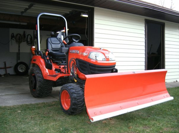

The original BX was an 1860 with the dozer blade. With 70lb wheel weights it was unstoppable. Then, I went to a B2320 and thought I'd just get by with the front loader and rear blade. Fact is, we just get too much snow. We're pushing snow by November and still at it April. 75% of the tractor hours sometimes come in the winter doing this job. When the next BX came along, a 23 horse, I went back to a front blade. The lighter duty blade uses the same front hitch assembly but only come with manual manual angling. A spare cylinder and a bit of fabricating and it is now a hydraulic angle. It is simply THE fastest way to push out a whole bunch of snow. Love it. I also agree that the leverage placed way out front on the end of the FEL arms will hamper a BX something fierce. The tractor simply doesn't have the weight, in itself, to counter act that. I found the B series with the loader having much the same issues. The BX front hitch assembly is highway robbery to buy, but the fool thing is incredible. Holding the blade and articulating it so close to the front of the tractor just flat works. If you'd ever watch a BX work in snow with this setup you'd shake your head. It's a sight to see.
