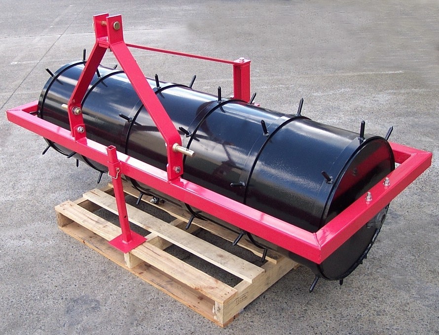

   / Anyonr recomend a good lawn roller for Kubota BX #4
I bought a 'made in China' 3PT roller which was bearing-slung under the frame. The strain of that configuration would've put too much supporting pressure on the bearings, so I dismantled and re-installed the bearings on top of the frame.
I did find one leak around the fill-cap weld. A bit of steel-putty (a 'plasticine' compound that hardens solid) solved that problem.
The attached photo is what the implement looked like when I first received it.

   / Anyonr recomend a good lawn roller for Kubota BX #6
"The strain of that configuration would've put too much supporting pressure on the bearings, so I dismantled and re-installed the bearings on top of the frame."
The only things you have changed is taking the bearing mounting bolts from compression to tension and increased the clearance for the roller when the implement is lifted.
   / Anyonr recomend a good lawn roller for Kubota BX #7
G'day orangeandgreen. Yes and no... firstly, I did this on the recommendation of the bloke who sold it to me (or re-sold it, as it came from China). He'd had a number of previous sales break due to the original configuration and this suggestion was the work-around. Secondly, due to the weight of the loaded (water with a wee bit of anti-freeze) drum on the four bearing mounting bolts in the suspended (underneath) configuration, it would quickly (time wise) shear the bolts with the constant up/down & tractor manoeuvring wobbles/vibrations when setting up for the next pass.
Supporting the bearings on top of the frame reduces those stresses. The aerating spikes are bolted on as a 'strap' and can be removed if I simply want to roll. The other option would have been to purchase a towed roller, but I have small horse paddocks with limited manoeuvring space to utilise that type.
