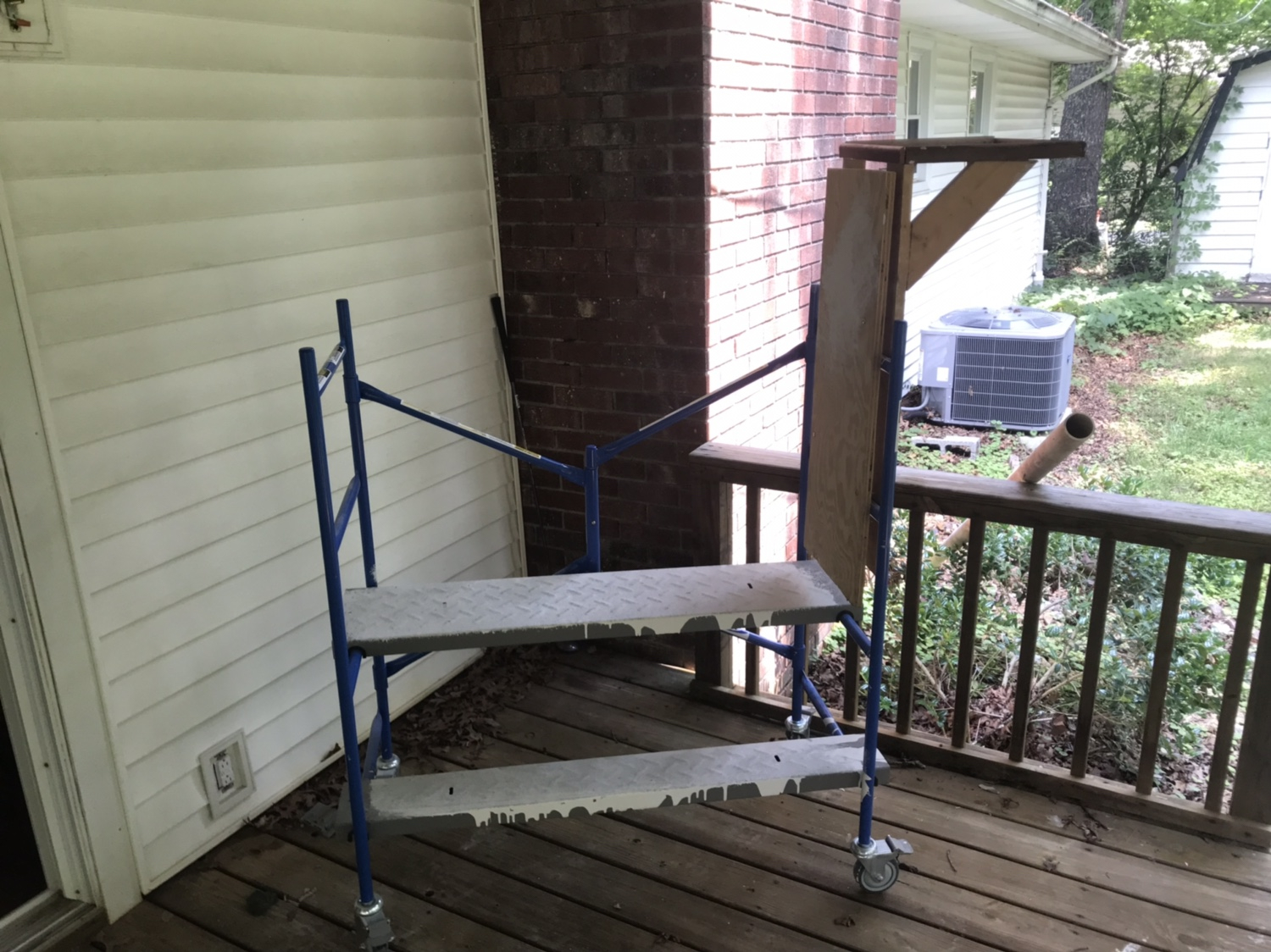

I use this whenever I can. It’s way more comfortable than a ladder and I’ve got the shelf to stack tools on. If I was only hanging one fixture I’d probably grab a ladder but if I’m painting or hanging several fixtures it’s well worth the effort to bring the scaffolding.
