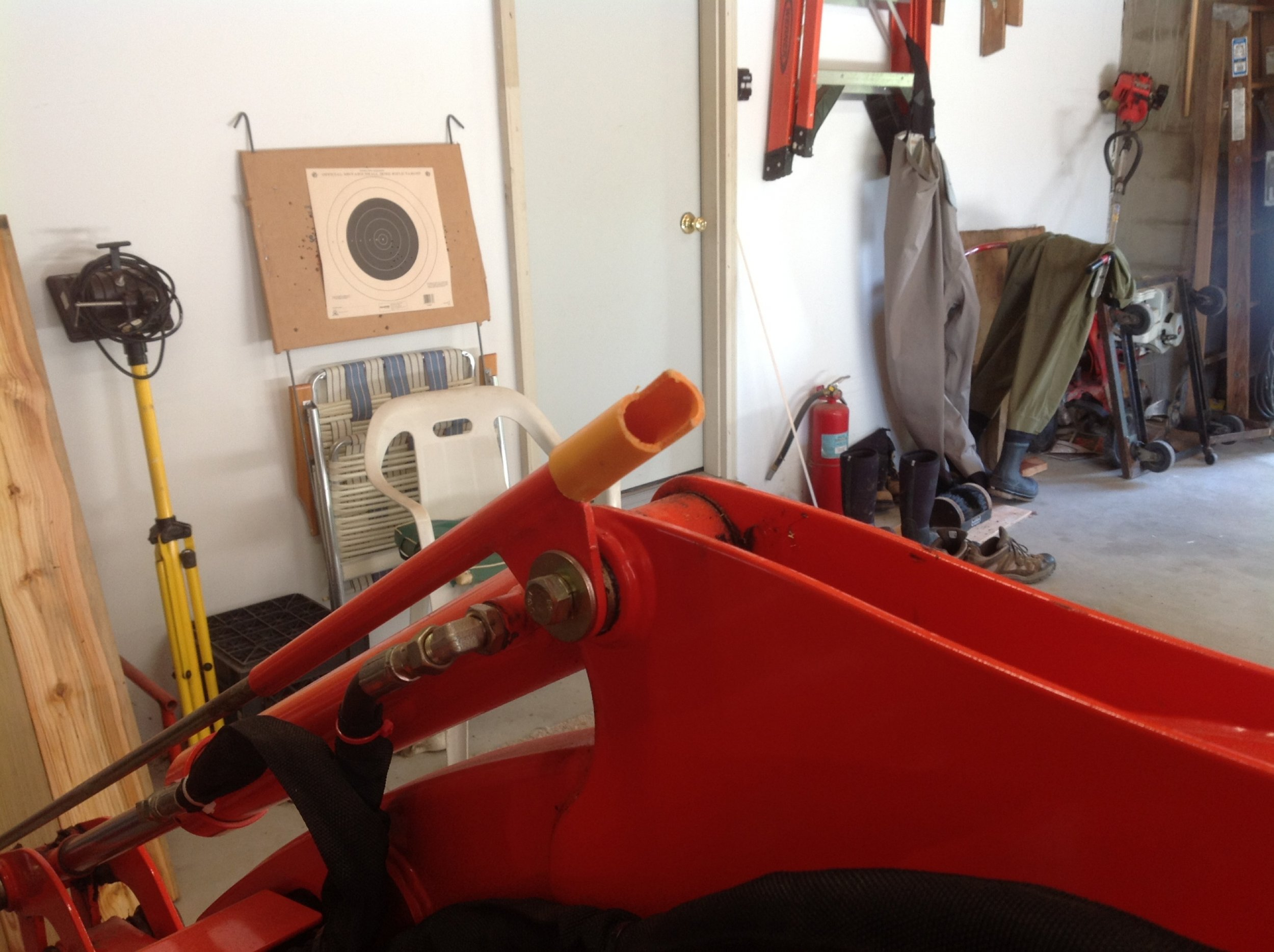

I have only the bucket on the loader, so I cut the rod 1/4" longer than the tube. That works good for me.

To level the bucket I just file a groove in the rod and from experience I can make small adjustments to compensate for the ground.

Great idea for a longer rod. I had one BLI that worked well with a slash cut on the tube. (NH 7308). That allowed me to tweak. Seems it'd be easier to put notch or two for that on the rod than to trim it's length.

Yup, that's what I did cut a piece of CPVC pipe to length, and it fits tight over existing sleeve.

My bucket indicator is a tube and rod. I had the same issues you have, and did not want to cut the rod. I put a piece of 3/4" pex with a notch cut out on the tube. With the bucket on the ground and level adjust the pex so the rod is even with the end. The notch in the pex is so you can see how far below level the rod/bucket tip is.
Mine is similar but a longer tube with a slot with notches cut for different implements, bucket level is different to hay spike level
