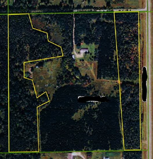

Ok, I heard back from the company that wants to purchase my timber. I have attached the letter they sent me and a plot map they sent showing what they want to harvest. What erks me about this whole deal is as you can see in the letter they said my pine "plantation" was to small for them to bother with HOWEVER if I would also be willing to let them clear cut my aspen they then would be interested. They KNEW how much pine I had on my property prior to contacting me.
As mentioned earlier I had not thought about logging any of my property before I was contacted, at this time I will enjoy my property as is.
