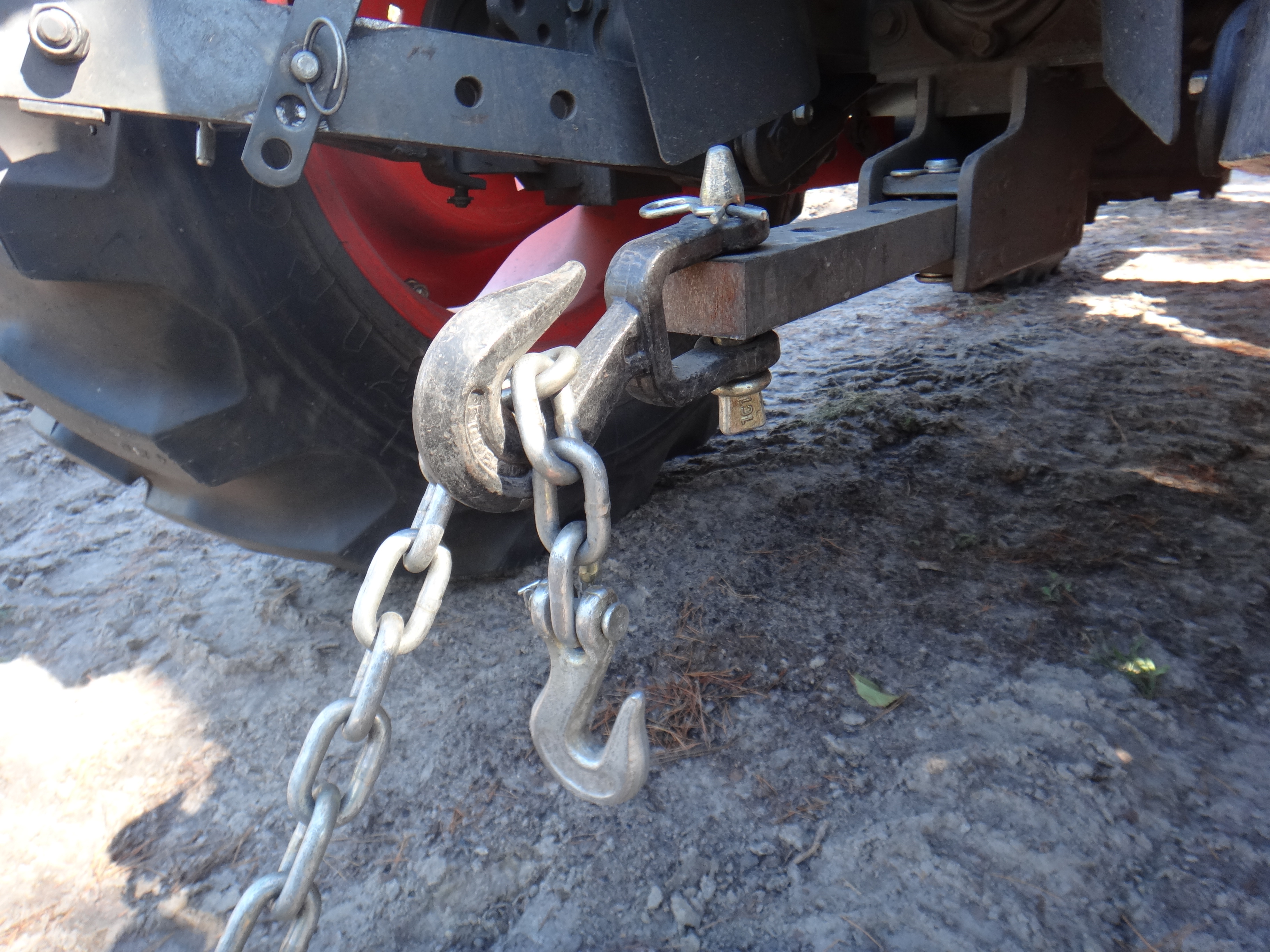

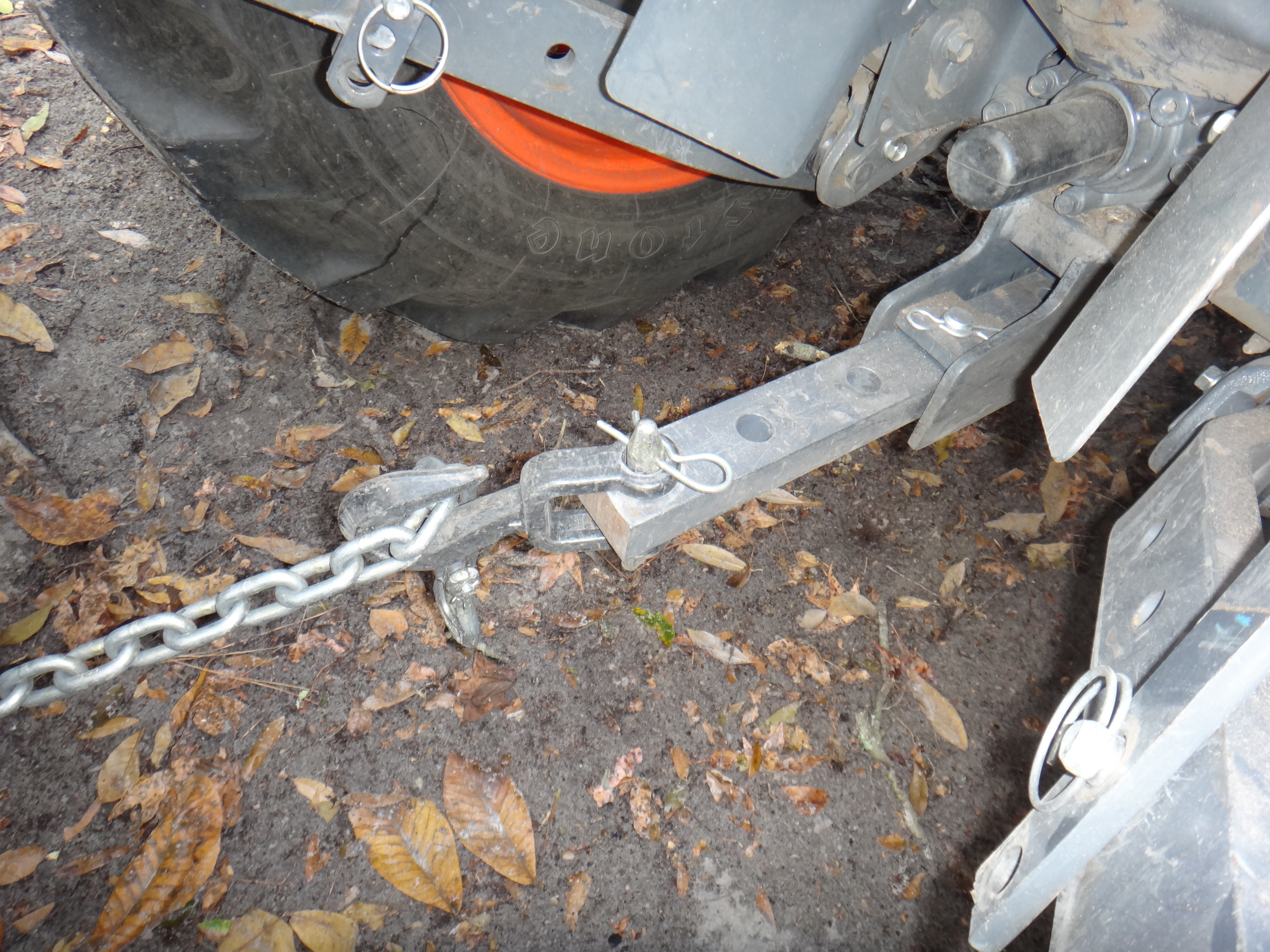

I suggest you next install at 3/8" clevis mount chain grab hook on your rear/center drawbar.
It is tempting to thrust the FEL into underbrush, noose a log to the bucket grab hook, then back out, which can bend the FEL.
If you have a clevis mount chain grab hook on your rear/center drawbar you will be likely to use it, correctly, for pulling heavy loads.
I have 5/16" chain grab hooks on my tractor.
I keep two lengths of Grade 70, 5/16" chain on my tractor, one length 8' the second length 12'
One end of each chain bears a Grade 70, Forestry/Choke Hook, the other end of each a Grade 70 chain Grab Hook.
The Forestry Hook is used to noose logs. The Grab Hooks are used to link the two chain together when necessary, hook to link, not hook to hook. Linking two chains is a rare event. I use the 8' length more than the 12' length.
15/16" chain is much lighter than 3/8" chain. Your L3901 cannot possibly break Grade 70, 5/16" chain in good condition. 5/16" chain is completely secure in 3/8" chain Grab Hooks. Lowe's and Home Depot are inexpensive sources for Grade 70, 5/16" chain. They sell a 20' length, with four grab hooks, in a bag in the Transport subsection of Hardware. Have them cut the chain in 8'/12' lengths in the store. Tough to cut at home.
LINK TO FORESTRY HOOK: Ken's Bolt on Grab Hooks <<Accessories>>=
LINK TO CENTER DRAWBAR: http://www.tractorbynet.com/forums/owning-operating/376755-rear-center-tractor-drawbar-use.html

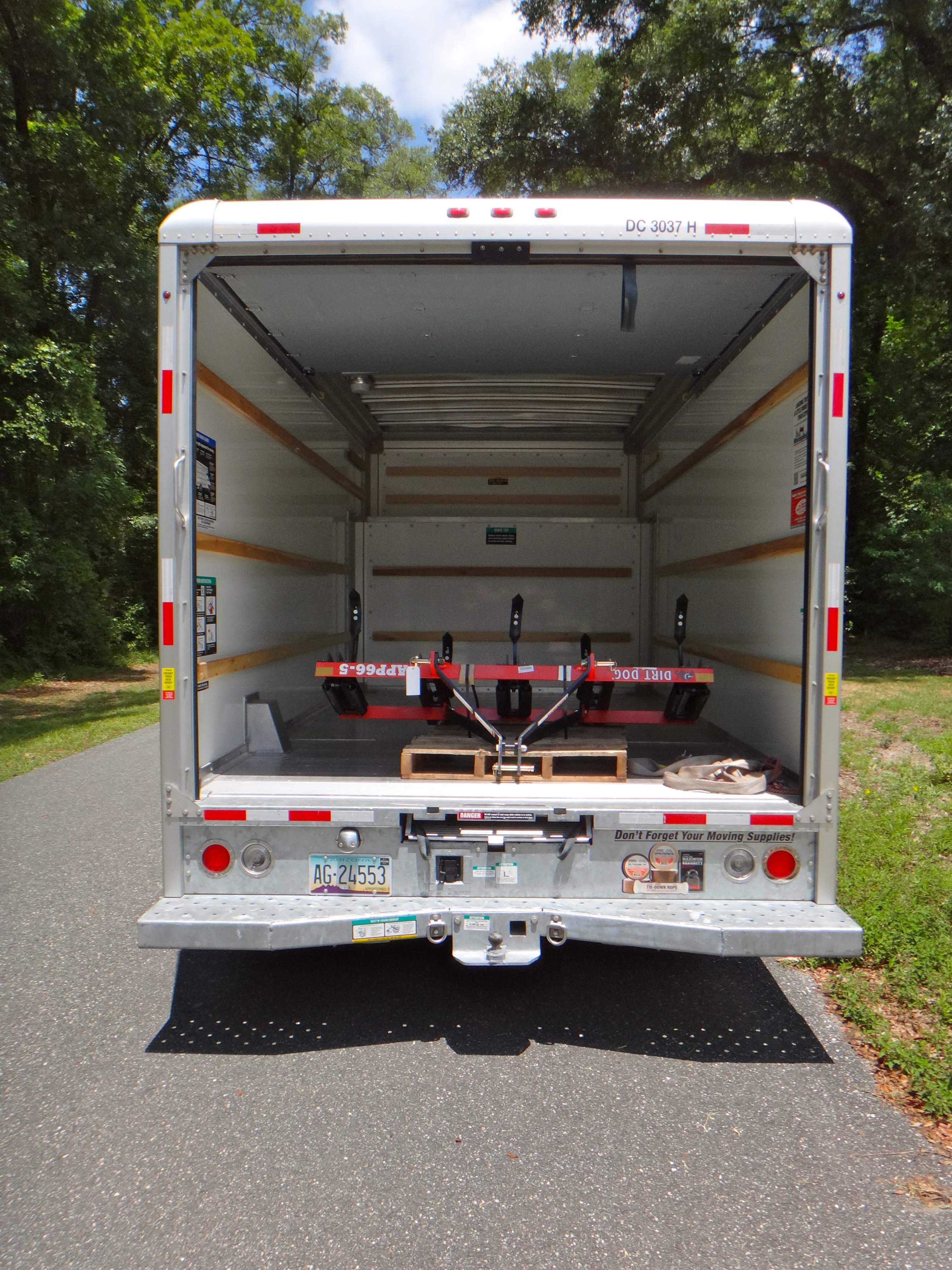

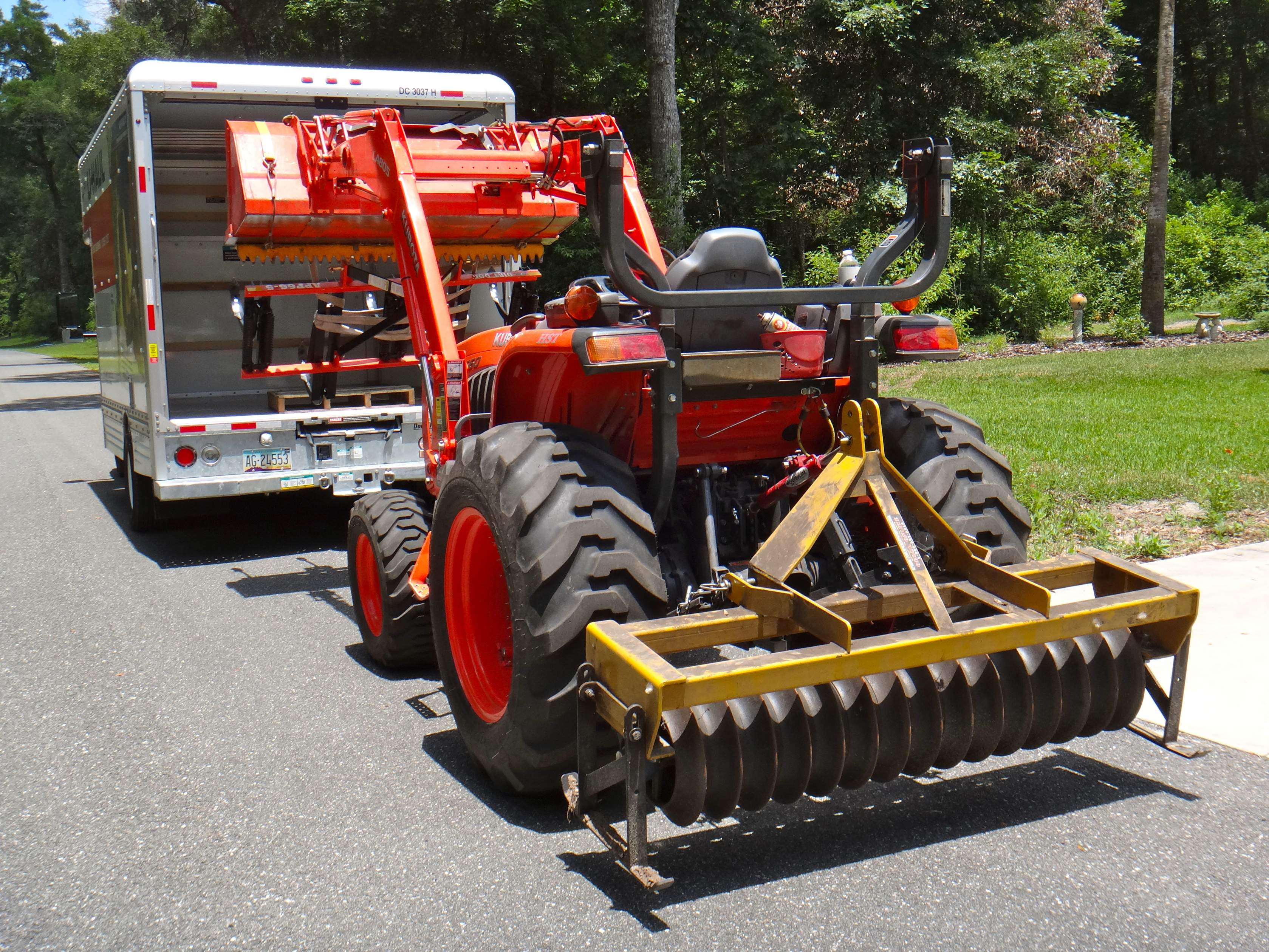

   / Appropriate Ways to Use Bucket Hooks? #4
When unloading a pallet (bucket full of concrete bags, pavers, etc.) from a pickup truck bed or a delivery truck, have a maximum counterweight loaded on the Three Point Hitch. Usually at least 75% of the anticipated FEL load, 80% better.
Lift the load just an inch or two without moving the tractor.
Have an assistant carefully drive the delivery vehicle out from under the load.
WITHOUT MOVING THE TRACTOR lower the FEL load to 2" above the ground.
Proceed slowly.
Field Cultivator weight, less pallet, 275 pounds.
ETA Cultipacker mounted on Three Point Hitch as FEL counterbalance, 700 pounds.

jeff9366 Is the reason you put the hitch pin in from the bottom of the draw bar just to make it easier to insert the clip? Or anything else?
   / Appropriate Ways to Use Bucket Hooks? #7
I do the opposite. I always put a hitch pin in from the top. If a sapling or brush happens to snag the clip and pull it out, the pin won't drop out. Extremely important when pulling a wheeled implement or hay wagon up hill. Not so much when just skidding logs, accept for finding the lost pin.
   / Appropriate Ways to Use Bucket Hooks? #8
I believe the clip is better protected from being pulled out when positioned above.
I think tomorrow I will replace the hairpin clip with a small bolt and ny-lock nut, or cotter pin, for greater security.
