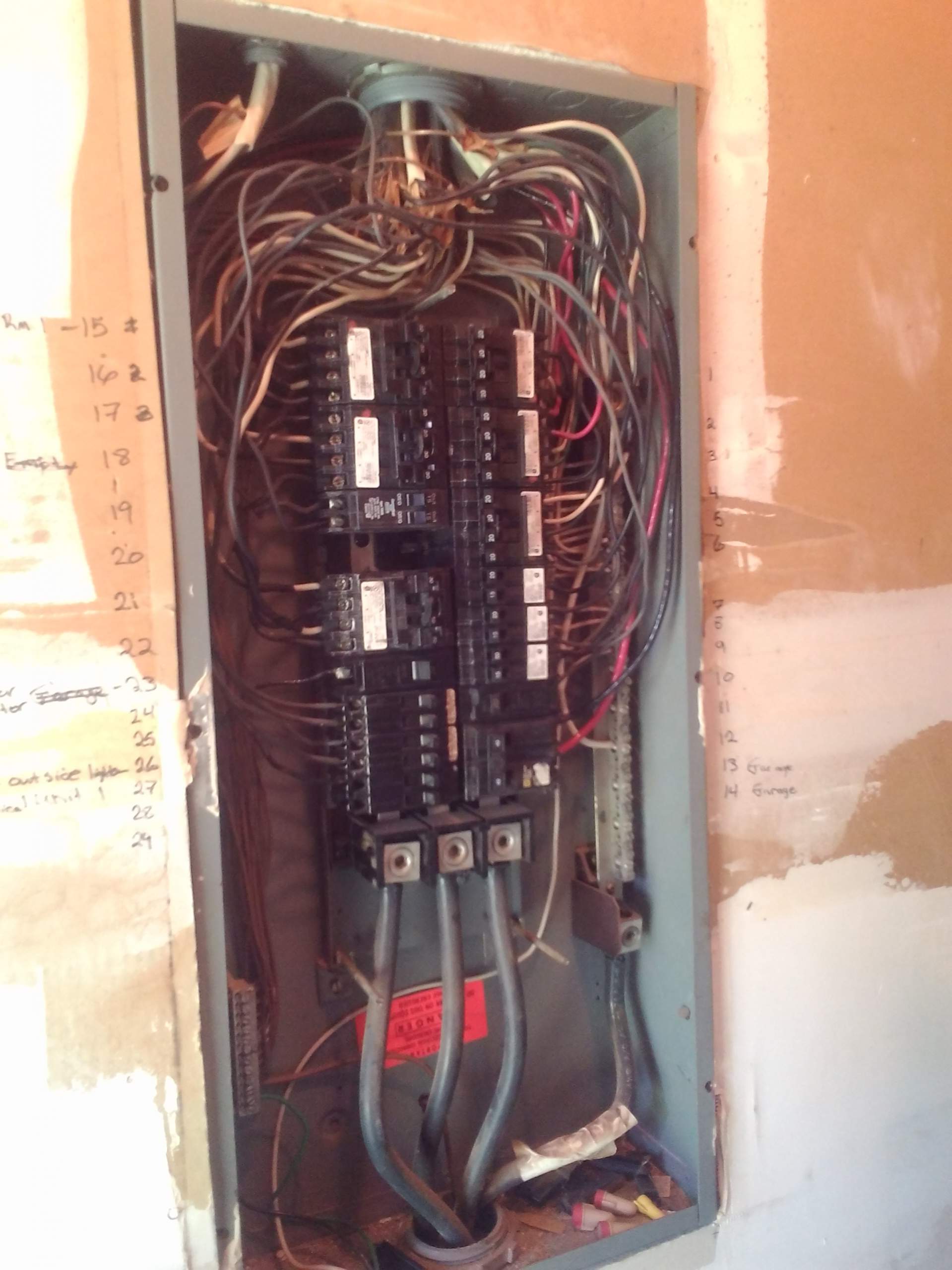

This actually answered some of my questions as well. Was given an old montgomery ward stick welder a couple weeks ago. Started looking in the subpanel that's in the garage to see what was in it. Breaker for 220 that isn't being used is only a 30amp. Started looking at the subpanel a little more closely and probably gonna have to suck it up for an electrician. The picture posted of the panel looks like like it was taken in my garage :shocked: already had to have half the breakers replaced and the subpanel looks worse. Plus no shut off. Was just piggy backed off the main breaker on the main breaker box :mad:

If it wasn't for the distance between us, I'd swear the same guy installed both. The guy that installed ours piggy-backed off the main lugs 400 amp, but didn't run the same size wire to the sub-panel. I just double checked, and the wire is #8, not #6, so I guess I'll pop a 40 in there. The breakers are Challengers, which are also the famous Zensco breakers I'm told. Here is the inside of the panel, including the fried section of the buss bar.

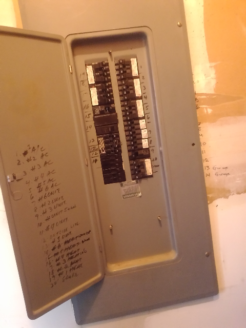

Original breaker box in my house is an ITE. Got lucky though and it just takes square D breakers you can get anywhere. Sub panel is a GS. Looking af the wiring diagram it can be wired two different ways. One of which is with a main breaker which takes up the top left two spots. Might get lucky and be able to get an electrician to just wire in a proper main breaker and swap the 220 breaker to a 50 amp :D Sub panel is next to the main breaker box, so he can update the wiring to the panel with a two foot piece with out trouble

I don't know that type of panel, but it looks like an awful design to me. I like Siemens, and Square D are decent too. Replacing a panel isn't hard if you plan ahead. Label everything first. Loosen everything you can to save time before you call for the electric co to shut it off (early in the day). Then work like mad until you are done and inspected and get it back on late in the day. Have plenty of flashlight batteries charged up, or even better, an extension cord from a neighbor if there is one close by for some lights. Or even a generator, if you have one. Replacing a panel is pretty much a 1 for 1 job. You know exactly what you need before you start. Heck you could even preload the new panel with breakers and label them with tape if you really wanted to. You would have to get a permit for this as the electric co won't light up the new panel without an inspection (at least around here). But that allows you to talk with the inspector ahead of time to see what you have to do that might be different from what you have in place now.

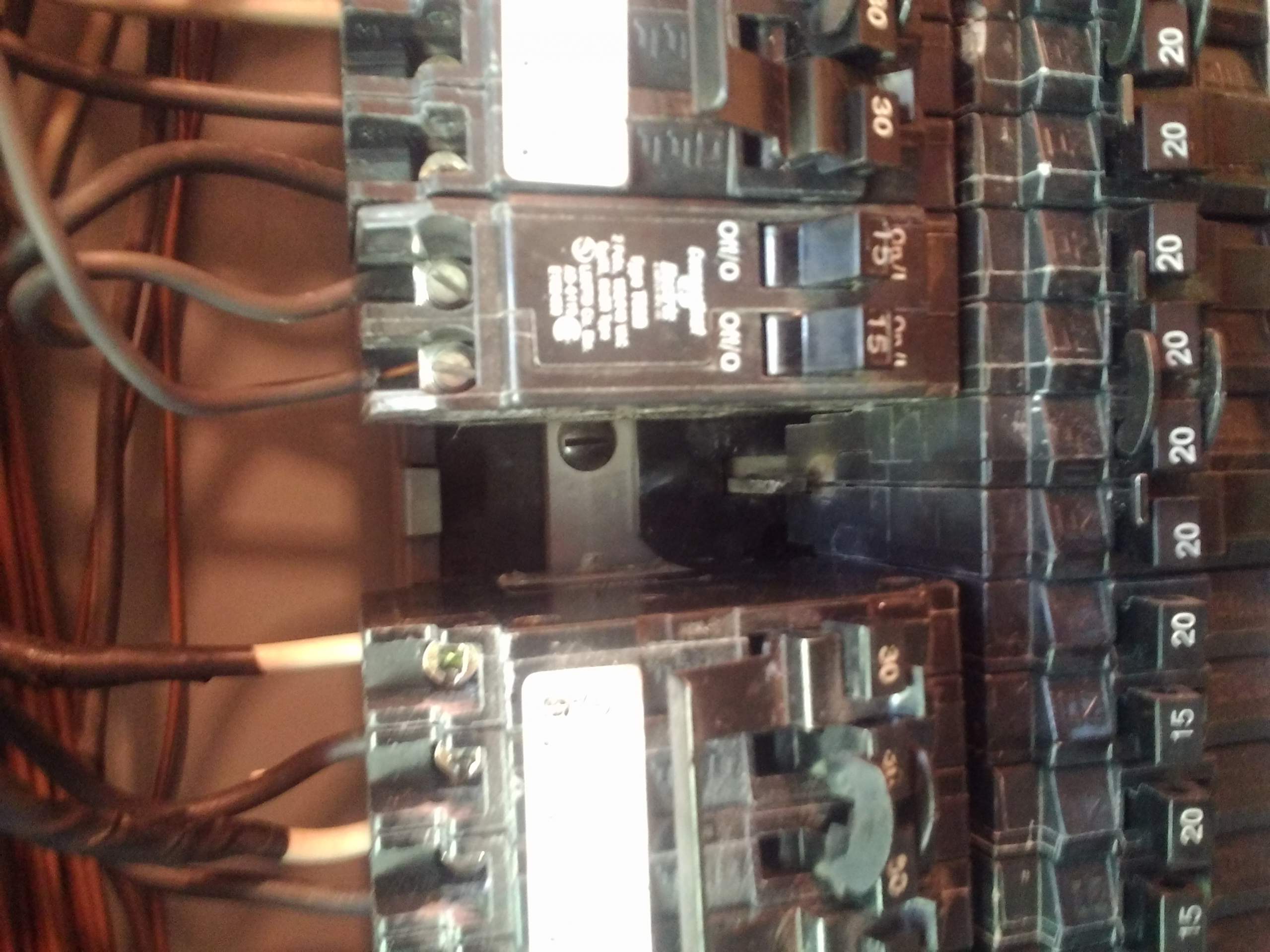

View attachment 421698View attachment 421699
The supply cables to a pony panel only have to be 1/3 the ampacity of the main panel if they are 10ft or shorter. Eg a 30amp sub panel needs to be supplied with 66amp or higher rated conductors.
