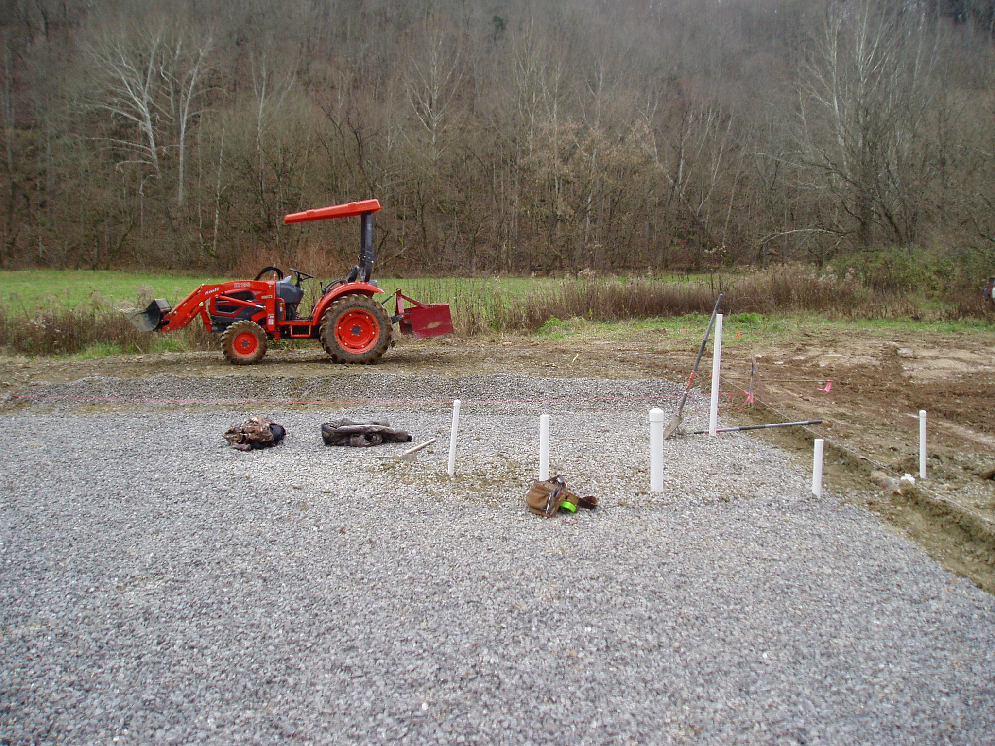

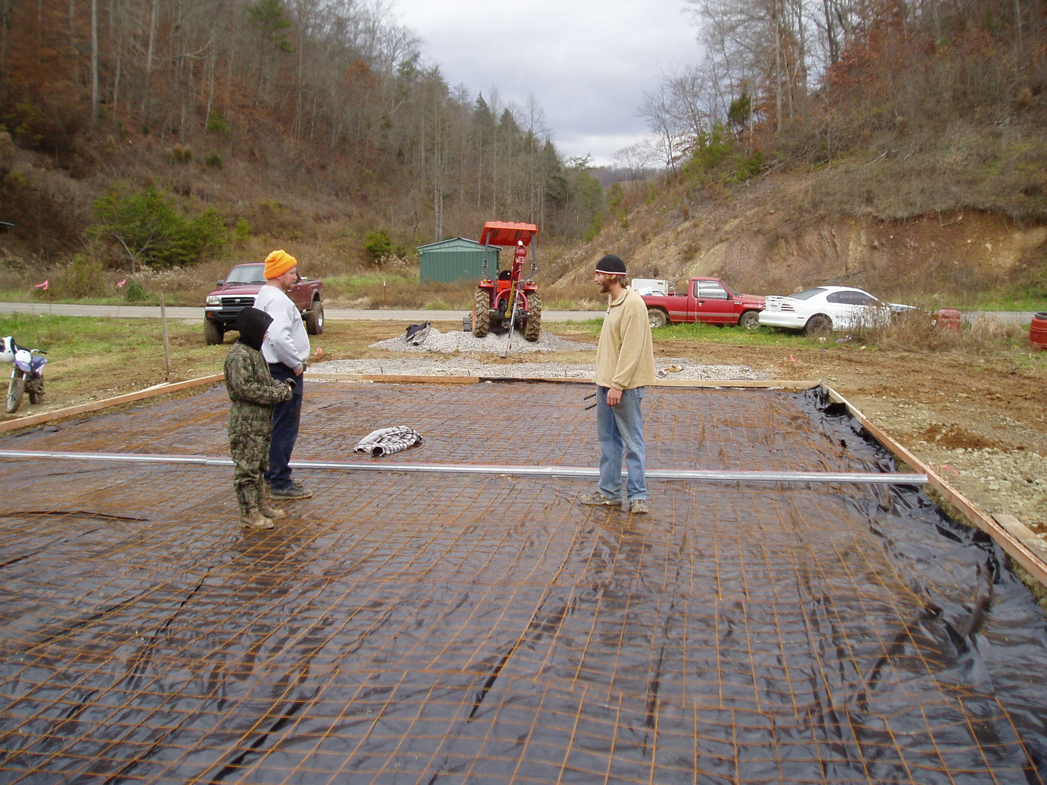

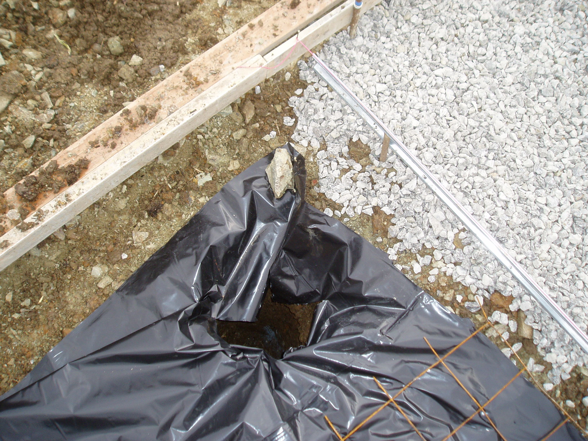

The excavation is done, i augered holes in the perimeter, vapor barrier, wire mesh and plumbing done. The rebar will come on the concrete truck, but i had to get to NO for Turkey day, so i left the rest for my concrete guy. The excavator also installed the 1,000 gal septic tank w/120' of gravelless field line. I was going to do the septic myself, but my excavator put the thing in for what i would have spent on the tank and line alone. Next trip up i will get some pics of the finished slab.
