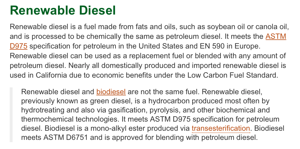

Looks like all of SoCal ARCO has gone Bio.
I used to hear ads touting biodiesel maybe 10-15 years ago, but not so much in recent years. Didn't even know Arco was still around...haven't seen one of their stations in forever.
Looks like they are mostly west coast.

OP here. I confused Biodiesel with Renewable Diesel which ARCO is selling. Apparently Biodiesel and “Renewable Diesel” are NOT the same thing.
   / ARCO selling Biodiesel at my station now? #18
So, was the renewable diesel at your fuel station 100% and not blended? It sounds like RD is just like #2 and should be considered the same while Bio is not highly refined and must be blended. Yes, I was confused too. :rolleyes:
Biodiesel vs. Renewable Diesel: Are They the Same?
There as no sticker on the pump indicating a blend. Online info from ARCO it has a Cetane of 63 which should be excellent.
