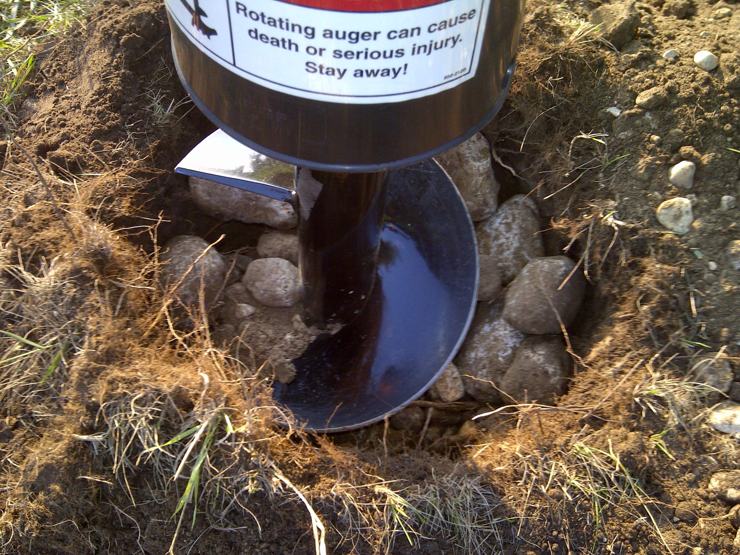

I agree with others in that all PHD's are not created equally and once you use a hydraulic PHD mounted to a larger tractor or skid steer, it's difficult going back to a 3 point PHD. With that said, we put in around 40 posts this summer with our 2520 and Frontier (Rotomec) PHD200. As you can see from the pics, we have some very rocky soil in places. I did break a couple of sheer pins but I am happy with the results of our project and how well the PHD stood up to all the rocks. FWIW...the price of the PHD was $980 and 9" auger was $280.

Looks like you were drilling at my house. What grade are your shear bolts?
Dave
Dave
Grade 2...Just brought down the throttle to an idle and took it real slow. A few times I had to get in there with a "breaker bar" to bust up a rock that was too big for the auger to take up.
