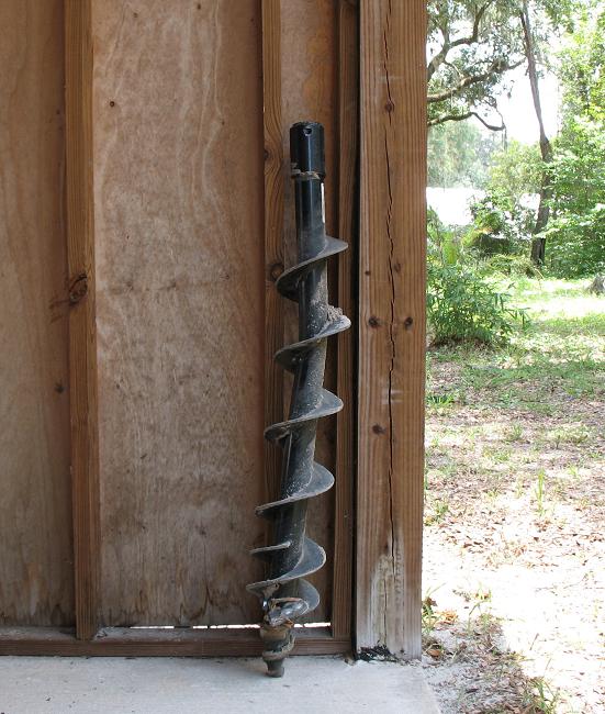

Bepp: Sorry to hear that,glad no one got injured.
Maybe post a pic of it when you can.
Might sound like a "dumb question" but any way you can get a replacement from Northern Tool since you just bought it ?

Ha-ha! I can't blame NT for this. A combo Mutha Nature & me. :eek: I just have to suck this one up.
Sure, I'll post a pic ASAP. Didn't think anyone would want to see it. Funny thing is, it's still bent a lot now, even after I put it back down in the hole somewhat & tried to straighten it ... which did straighten it a little, but alas ... well, it was a last gasp effort ... that failed :eek:

Here's a pic of the bent auger that augered exactly 2 & a half holes for me, aka very expensive holes.
Again, the bend you see is actually after we straightened it a lot :eek: It was pretty obvious it was just gonna kink & we were never gonna get it very straight anyway, so we gave up.

A good machine shop with the correct size Hydraulic press probably could straighten the auger enough to be usable again. bjr
