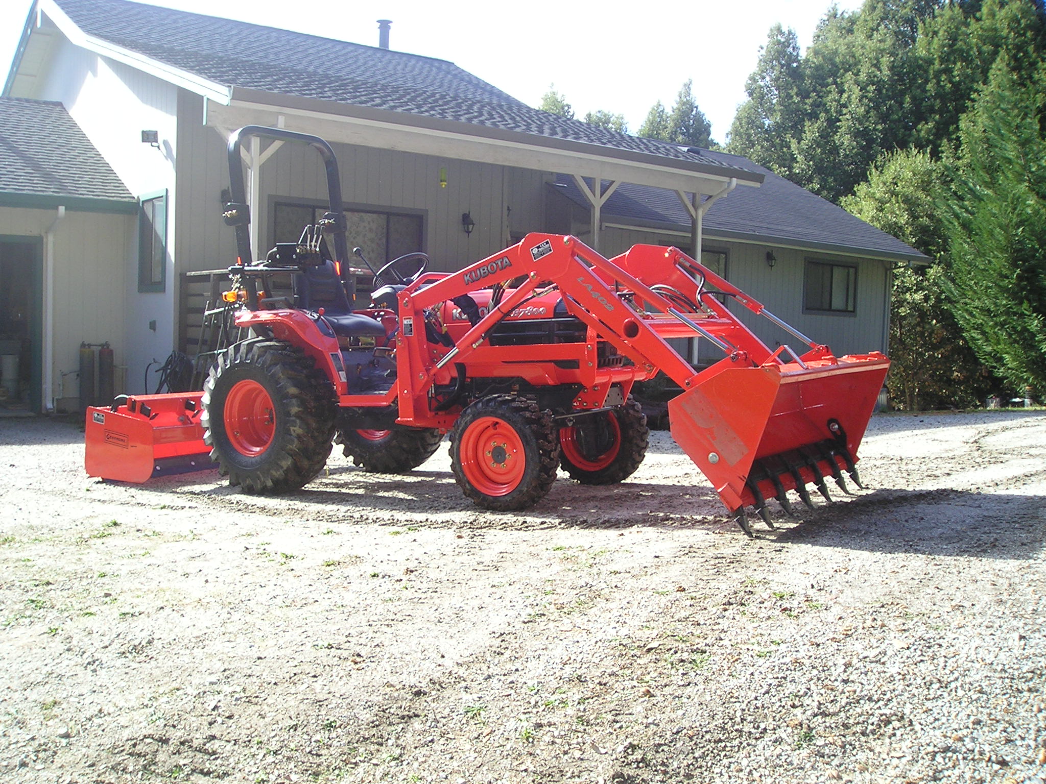

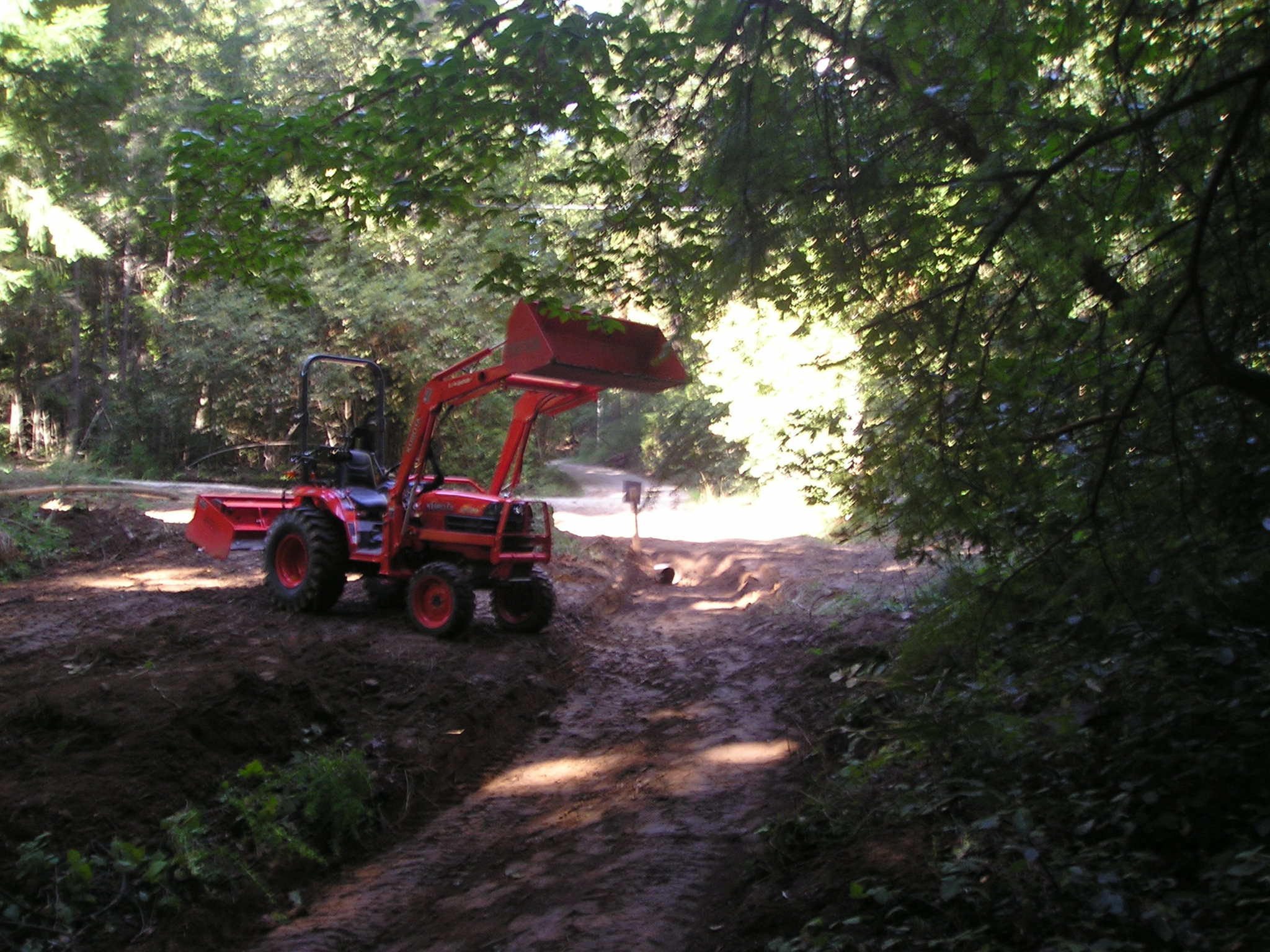

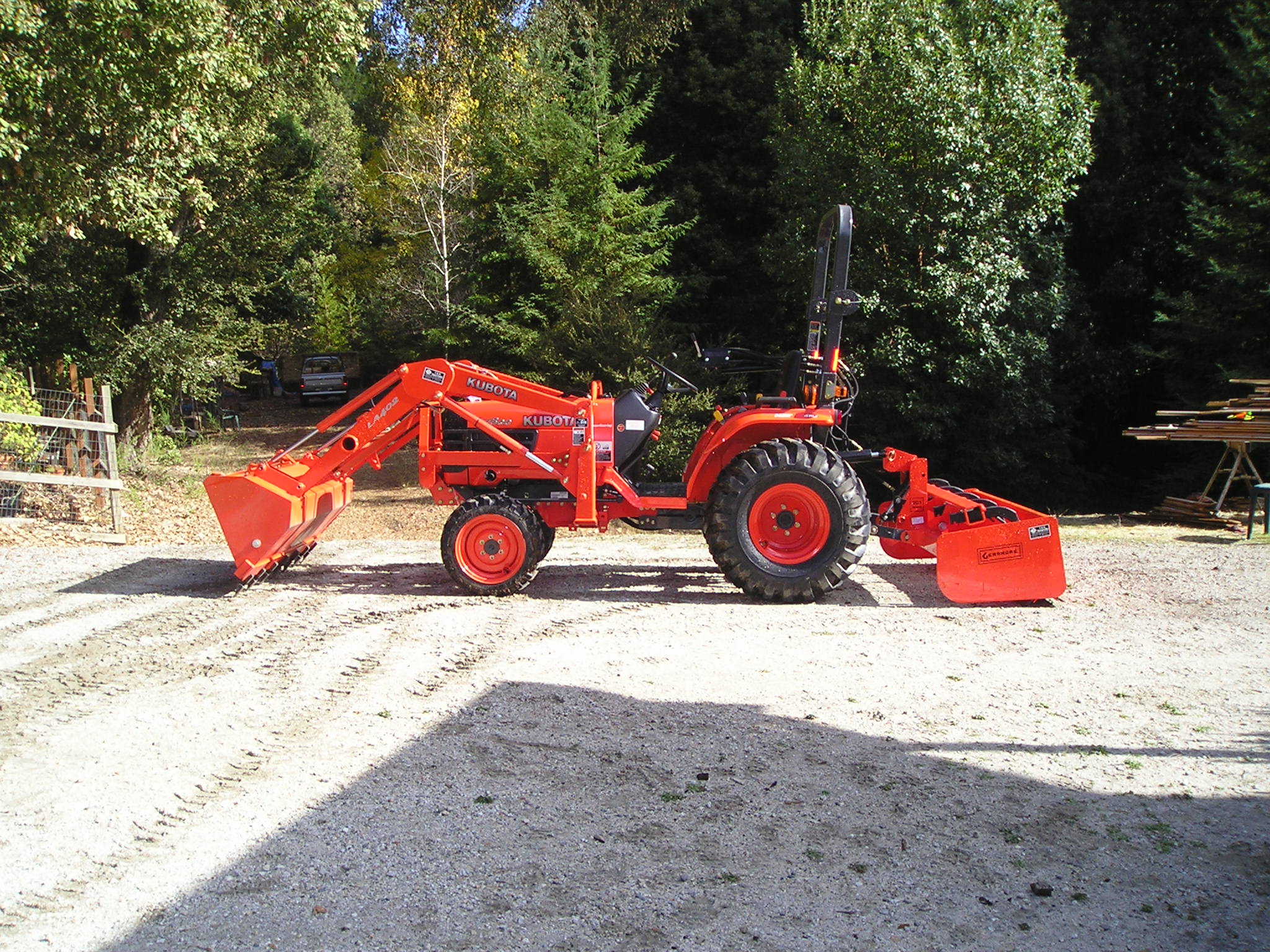

Everyrhing is OK....The diff is not locked and works great....Thanks for all the replies...
Here are a few pics I took...
Oh yeah...looks like I posted these pics earlier in the thread...Oh well...
Enjoy again...
Jim
