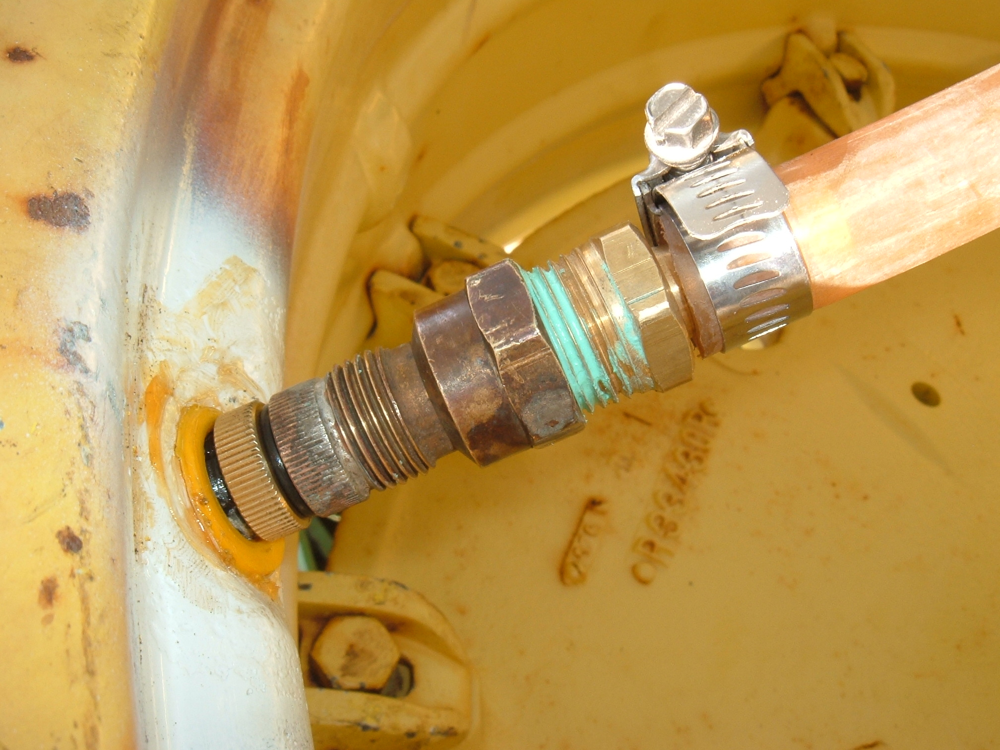

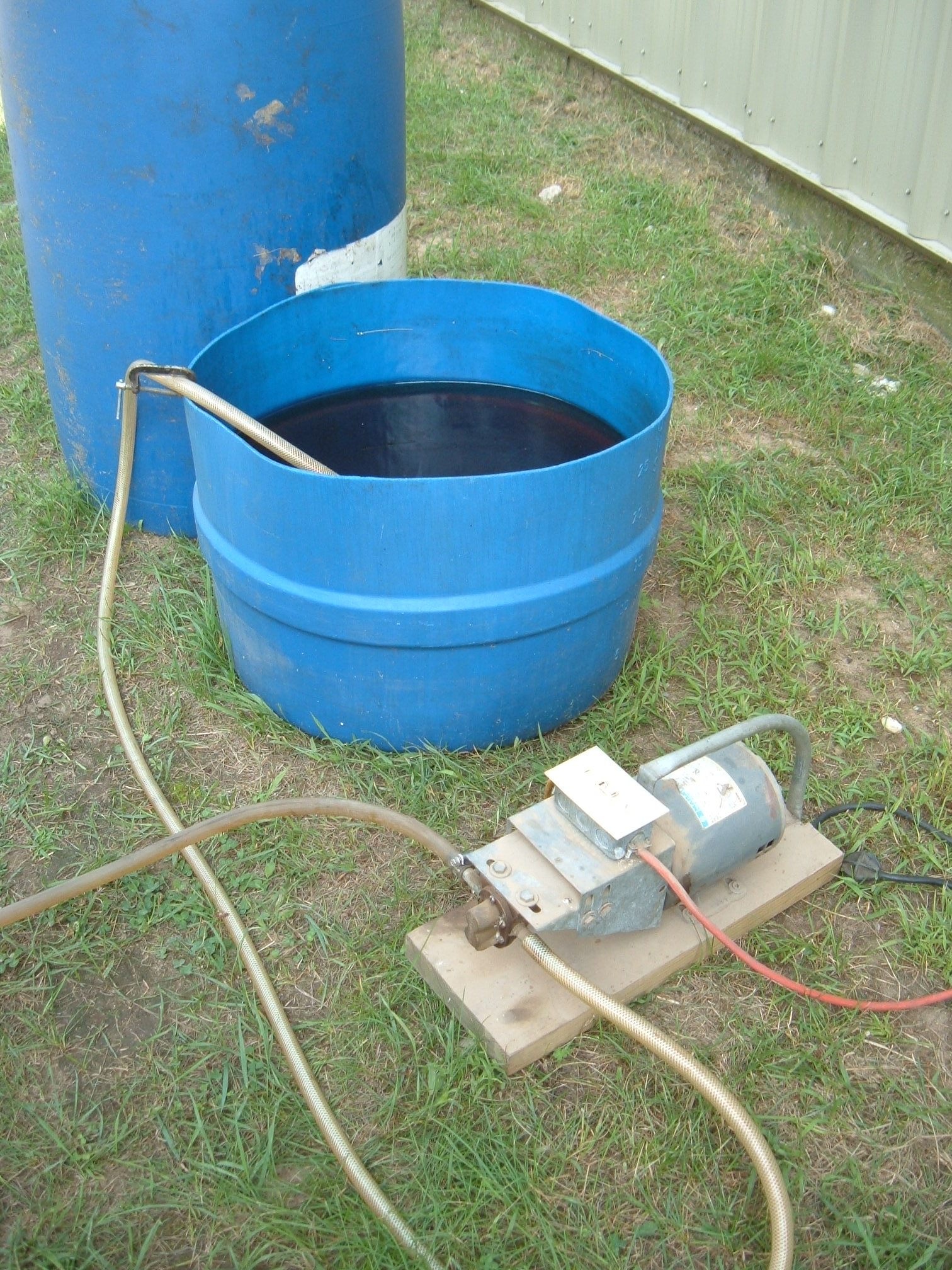

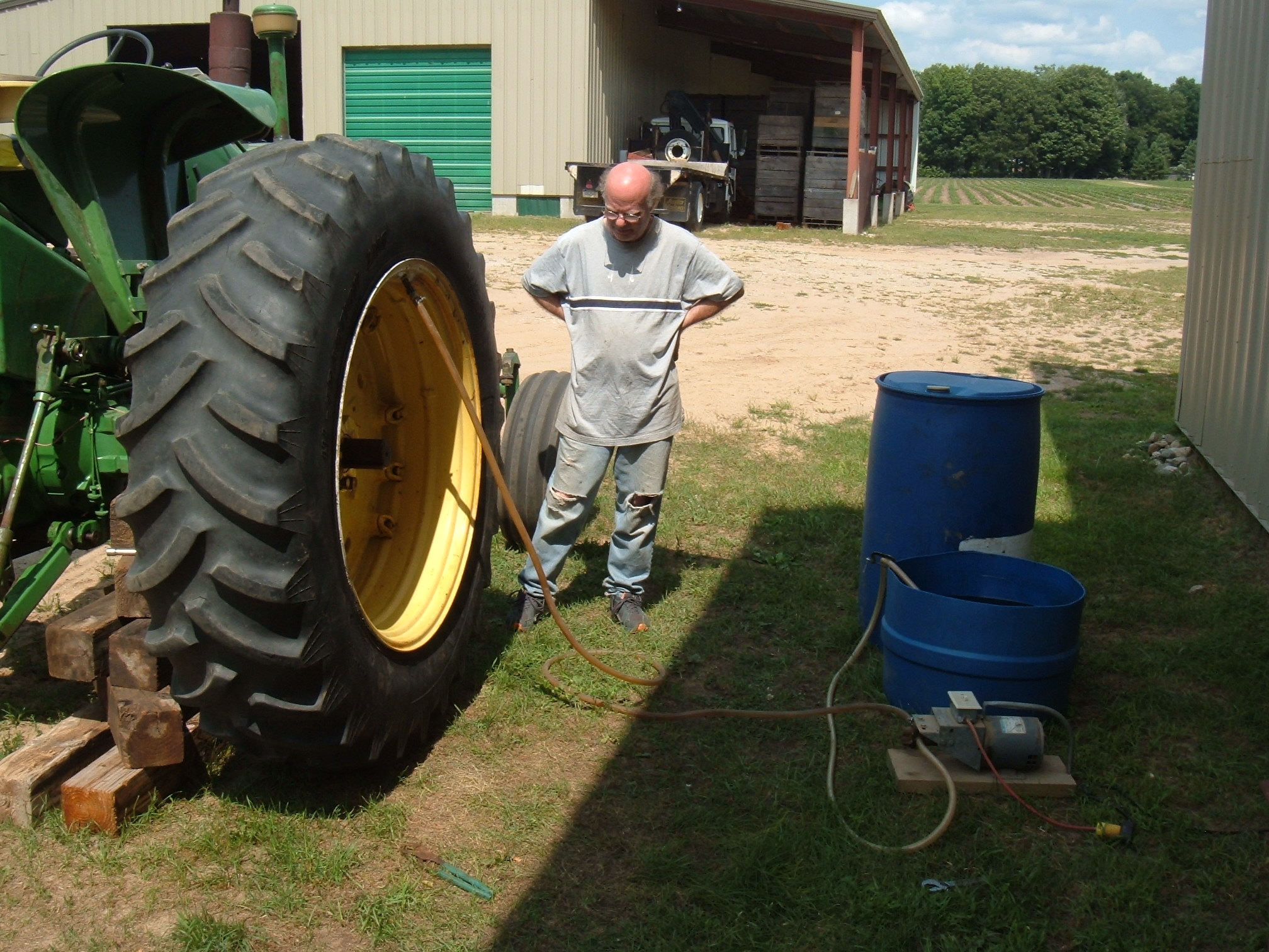

Helper filling a tire, re using the brine.

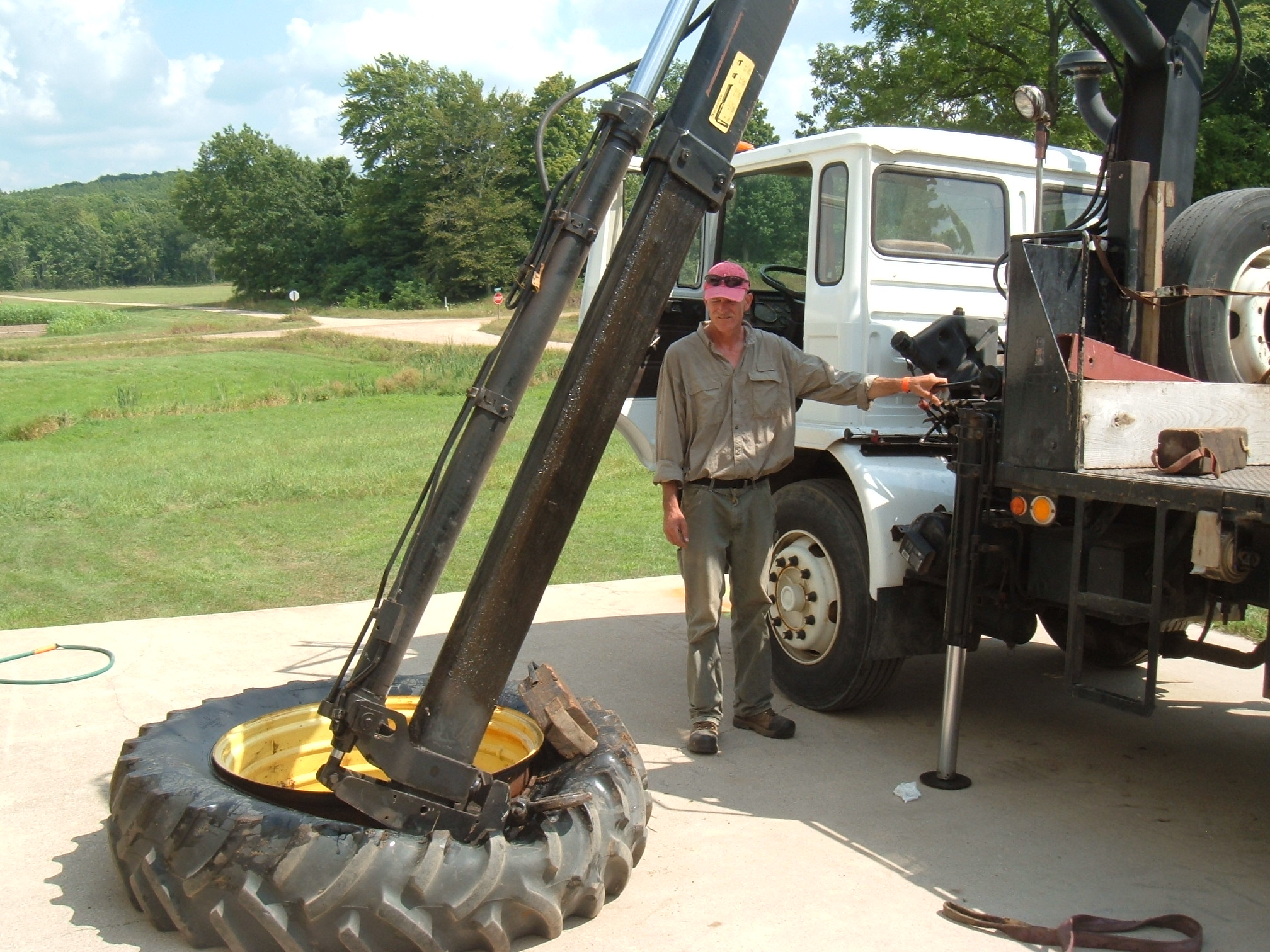

Brother breaking a bead. I know they can be done on the unit but I have a crane and take them off. I can super wash, sometimes paint or fix any damage or the stem h
ole.
