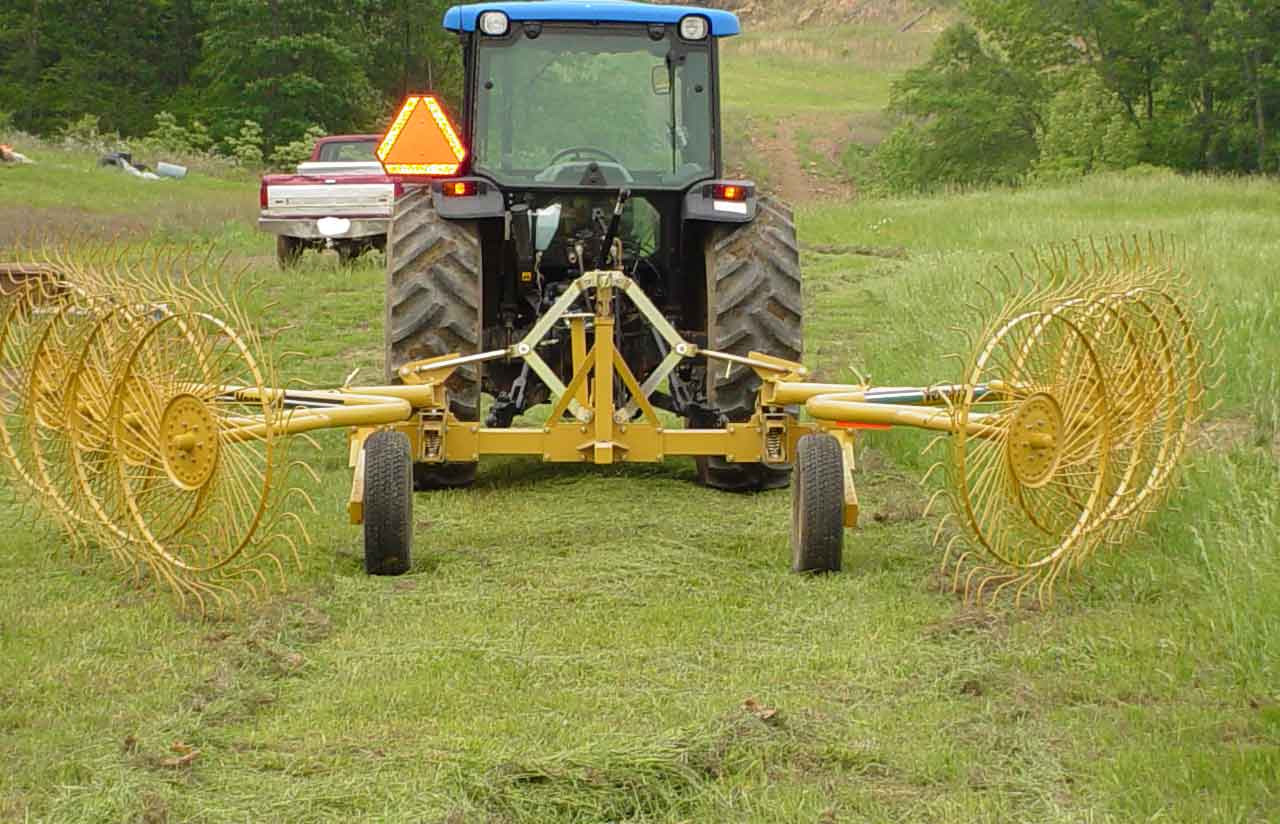

Next you rake it up into a row.
The attached shows my rake which is ~13' and produces ~52" wide row of hay.
In teh picture you will see that their is very little grass. I was just setting it up for the right width in this thin field before moving to the real field. Normally the pile of grass would be ~52" wide and ~1' tall at least.
Normally in my area I let it dry a few days after cutting before raking. This will depend on the weather.
After you rake it you may need a few more days to fully cure the hay then bale it.

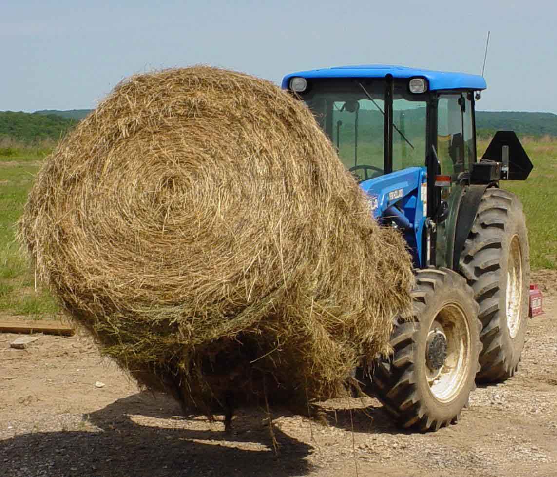

I make 4'x5' bales (~1100 lbs each) but they can be larger or slightly smaller. Some folks make square bales but this is a lot more work, to collect all those ~50 lb bales and stack them up in a barn.
The square can not stay outisde and take the rain. The round will shed the rain well and still be good for feed.
The round bales are moved with a spike on the tractor.
This is not a good bale, to much rain made it rot.
Its important to get the moisture content right so that the bale lasts and the bulk of it can be feed out and the live stock will eat it. If its moldy or rotting some animals won't eat it.

Your this rake looks very good, with a simple but very good design from engineering point of view, also simple mounting to the cart is another advantage. The best rake I have ever seen.
http://www.tractorbynet.com/forumfiles/323397-rake.jpg
Where is it made or what brand name is it?
