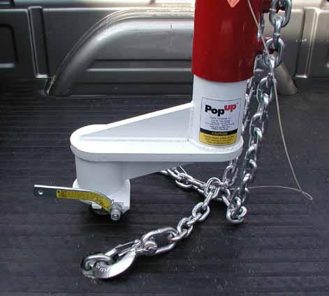

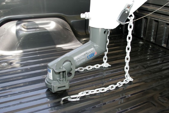

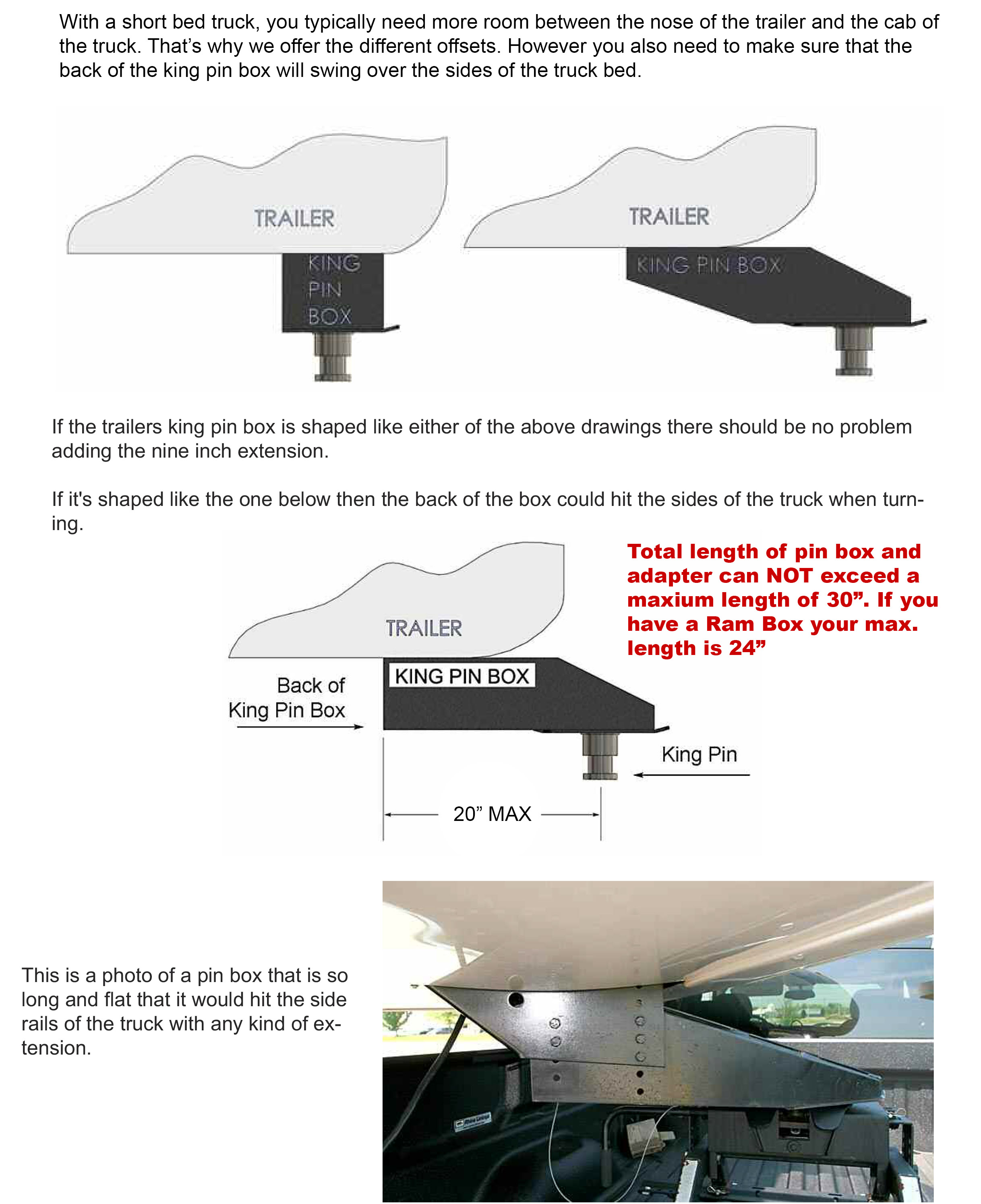

These extenders are made to prevent a gooseneck horse trailer from hitting the cab of a short bed pickup truck on a sharp turn:
   / Are gooseneck trailers really more maneuverable? #42
Ideally.

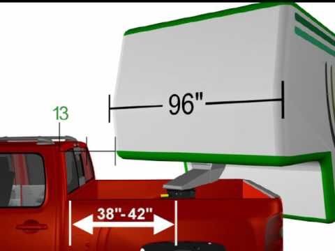

A local guy bought a new 3500 Ram with a flatbed and when it was delivered, the hitch was BEHIND the rear axle! The upfitter told him it was because the tail-swing of the truck was too long and would hit the front of the trailer. The only solution was to cut about a 1-foot 45* wedge off of both rear corners and put the hitch back over the axle. Dodge said you can't change the frame length or you'll loose the warranty.
This is why you see some fifth wheel holiday trailers with hitch extensions. The solution is to buy a flatbed with a longer hitch.
This is the fifth wheel extender:

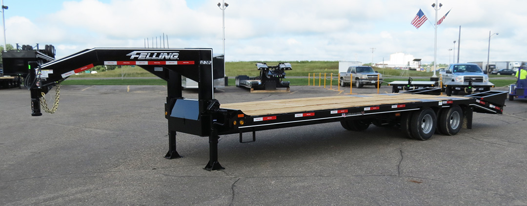

This is a gooseneck with a longer A frame to clear a longer than normal bed: 3 Key Measurements Are a Must - Felling Trailers - Gooseneck Coupler

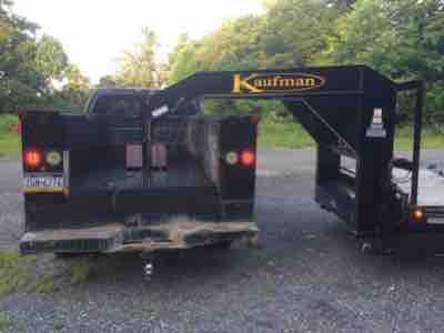

And a gooseneck with a higher A frame to clear a service bed:
