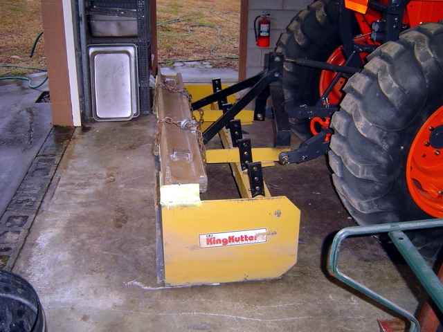

Hi Tony,
You need more weight on the box blade. I bought one of the King Kutters, (looking back, I should have researched more and gotten a Land Pride or Gannon), and discovered I also needed more weight on it to really dig in. I got some rail and welded on a tray of sorts to hold it. Now it works great! Standard size rail weighs 50 lbs per foot, and I added 6 feet of rail. You can get rail at a scrap metal yard. The naked box blade weighed 500 lbs and I added 300 lbs of rail.
If you have a front end loader, just keep your box blade attached all the time and it becomes your weight box to provide a counter weight.

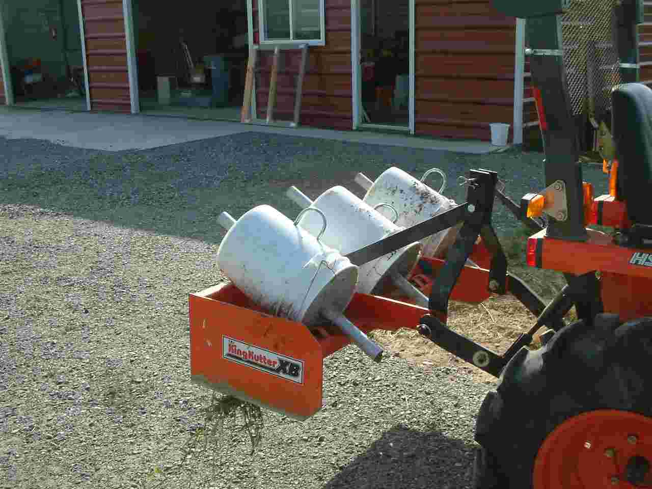

tony123 said:
I've been using my box blade now for about a month. It's a 48" United. I've tried every setup adjustment I have, but can't find any way to get it to bite in more than an inch or two.
Specifically, I'd like to get the teeth to dig in several inches deep before the blade. Almost in a plow sort of fashion.
Maybe I need a really short toplink?
Am I trying to get it to do too much?
Most 4-ft wide box blades are too lightweight. Add weight. I have three 120-lb concrete weights that I can load onto my King Kutter 4-ft BB that I use with my 21-hp Kubota B7510HST. With the extra 360 lb that KK BB works OK except in the summer when the soil is like a brick around here.

Weight it is. Thanks for the photos and ideas.
I'm going to try and track down some railroad rail. I'll start with one length and add a second if still needed.
