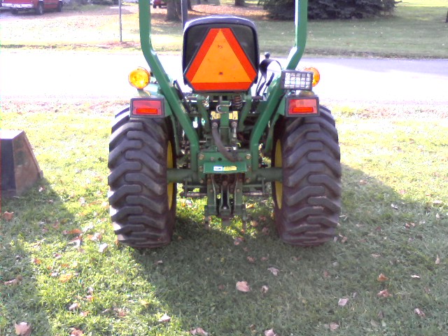

I am having trouble trying to find out if my R4 tires are mounted correct. Like are the bars going in the right direction. Does anyone have a picture of the correct way the bars should be running?

Here you go.
   / Are my tires mounted right? #3
From the top, the treads should form a "V" that points forward. The tracks left on the ground will be pointing opposite the direction of travel.
   / Are my tires mounted right? #4
I'll second that photo............:D
Thanks guys. My tires are on wrong. I'll have to switch the tires to get them right.

   / Are my tires mounted right? #8
Some one might have switched them for a wider or narrower track if the bolt plate in the rim is off set.
Make sure you check the clearance after you switch them.
If they do hit you will have to demount tires and spin them on the rim and remount them in the other direction.
