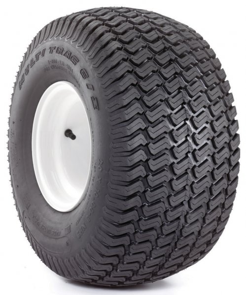

coollx I wondered the same thing R3 or R4.
The R3 tires I have seen on the new 2520 are a Carlile brand.
They sure did seem to have an agressive tread on them. I wanted to find a picture of them on the web, but didn't find any.
I also will use them in the snow, but primarily mowing in the summer.
Do you kow what model Carlile tire you have?
PS It seems to me the tread on these R3 turfs aren't like previous treads I have seen on turf tires.
smalltown, the R3's currently on my 2520 are Carlisle 36X14.00-15 MULTI TRAC C/S. Actually, the tread is fairly open and looks pretty aggressive.
   / Are R4's Really Bad In The Snow? #14
coollx I think that's the tire I saw at my local JD dealer. I will be driving by his lot later and try to take a photo to compare.
My point is as yours that this is a turf tire but seems to have a agressive tread pattern.
