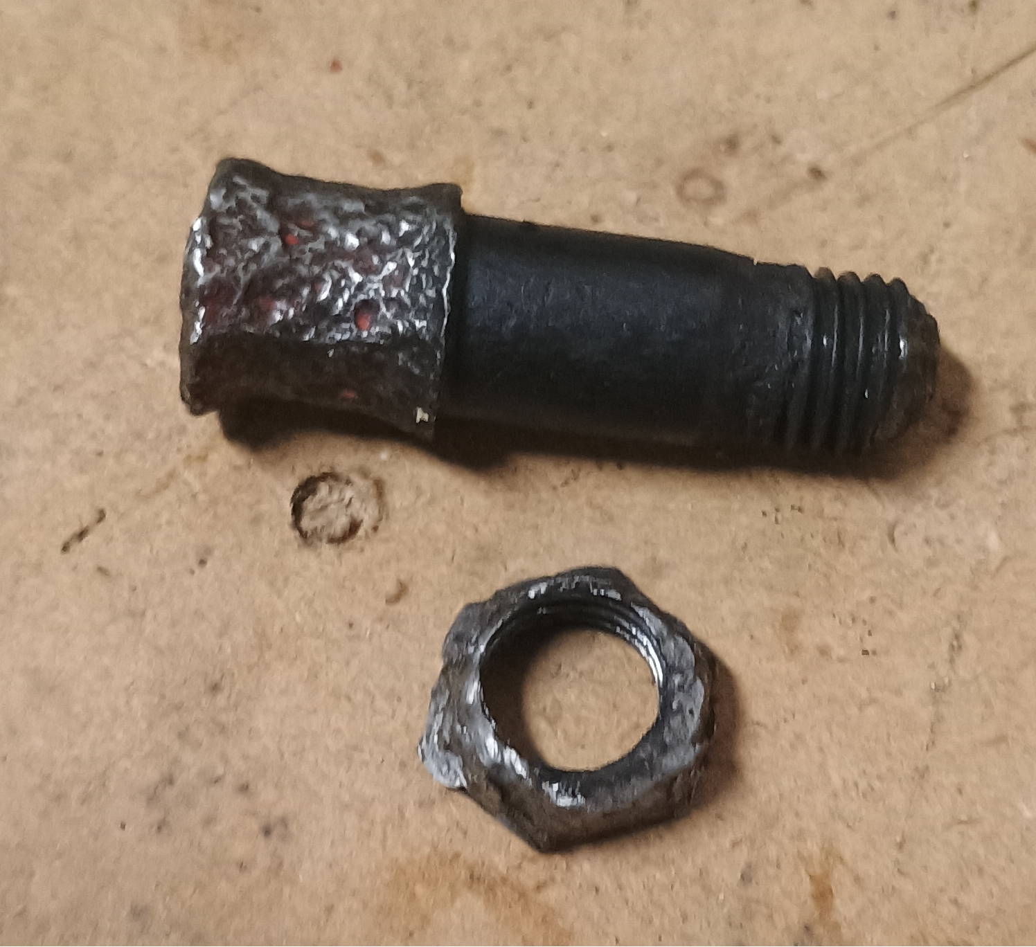

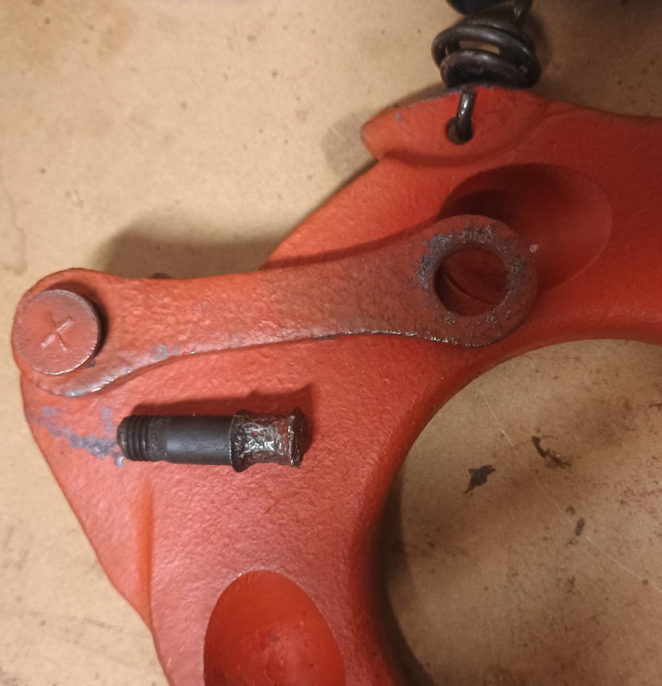

Doing a little work on the old International 606 Diesel.
Trying to get the brakes working. I picked up a brake kit with new bearings, springs, and friction disks. But, one brake won't hold together without replacing the brake actuator stud. A small stepped (shoulder) bolt.
I called the dealer today, and they wanted $96 each. One looks like it was replaced at some point. I would need 3 of them for a total of about $300.
They aren't big. Probably hardened steel. However, they likely are precision machined. So, it is unlikely an off the shelf solution would work. I was surprised I was able to get the old bolt out cleanly (filing the flats to 10mm).

I would hunt around for a while to find something else to fill the Bill (That's me). Something to substitute, make, or adapt from other vehicles, machinery, and or raw stock. It's not dealing with high speed forces or moments, so weld on a piece of rod onto a hardware store bolt cut to length. Heck even a thick-wall tube would serve the pinion's purpose, pressed onto a bolt shaft.

Maybe a 5/8" bolt or whatever diameter it is, with a piece of 1/2" pipe welded to the end. You could probably even get a machine shop to turn out a few for $100.

I would imagine that the actuator studs fit in at least a dozen different International mechanical brake tractors models, and perhaps also fit in a dozen hydraulic brake models. Perhaps even more. So it isn't a one off. They probably don't fly off the shelf, but likely there is enough demand (if the price was good) to keep a few in stock.
The brake friction disks, actuator springs, bearings, and boots seem to be readily available aftermarket. Possibly the entire actuator assembly.
I have a feeling that the drums aren't entirely sealed. Mine were missing the cover plates. But a mixture of moisture getting in, and not getting out quickly, as well as no escape for brake dust, and it all makes a very caustic environment for the parts.
The shoulders are important. The first one is to fit tight in the actuator disc. If it was simply threads, it would eventually wallow out. The second shoulder is to fit the actuator arms,and something to bolt tight down onto.
As far as the part, I should have asked for the part number, but I'll find it. Or I will make my own studs.
The idea of using either a bronze or steel bushing for the second step makes sense, and might lead to an off the shelf solution. Thanks @mrmikey
I haven't found only the studs. I did find some used brake parts on E-Bay that I ordered. They may come as quickly as the dealer would have gotten the very expensive bolts in.
But, I can also imagine the slippery slope of tractor restoration. $20 here, $100 there... and do that a few hundred times and one could just buy a newer tractor.
For now, I think I'll simply weld a washer onto the old stud to form a new head, and put it back into the tractor. Then when I have some time, take it apart and fix it good enough for the next 60 years.
