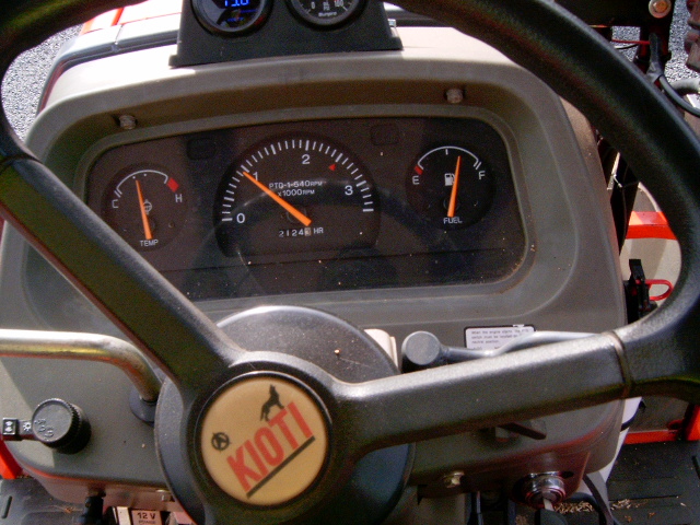

Heres the hour meter picture of my 2001 Kioti DK 35.
Been an awesome tractor, expecting thousands more.
