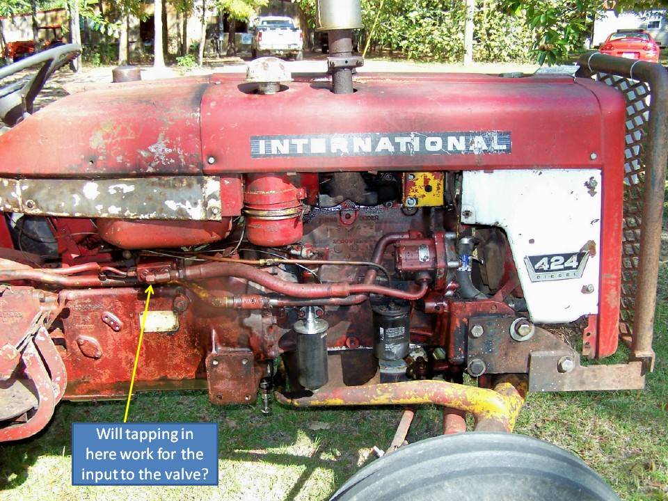

I've never added a valve to a tractor before, so this is a learning process for me.
Will tapping in as show in this pic work? Would it be better to try to get a factory valve setup?
There is a tee there currently with a cap on one side and that is where the service manual shows connecting to for testing the pumps pressure. The block that tee goes into is where the split is to divide the fluid to the steering and to the three point hitch.

There hasn't been a facory option available for 30 years. I do believe you are headed in the right direction. The return would be easiest by adding on to the fill behind the seat and dumping it in there.

First put pressure guage in where you say the manual says to check pressure and verify by pressure if it is open or closed.
That looks to me like a priority valve. Splits certain amount to power steering and rest to 3 ph. If it is open center it will not do you any good hooking to the plugged end. You will need number of valves as needed and a power beyond probably hooked to 3 ph.

Yes that is a priority valve to split flow between the steering and the 3 pt hitch.

Looks like there plenty of joystick valves that have the powerbeyond capability, but I'll likely have to buy the kit to add it.
