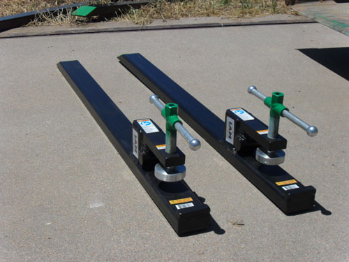

Thanks for all the input. I did buy these yesterday. $319 with free stabilizer bar and free shipping. They are light duty 1200 lifting capacity. My tractor is rated less than 1000 and like lots of you wanna use it for downed trees and brush. The trees would be cut up into shorter logs.
I think if I had a large tractor I would want a QA type. But I don't and I don't have a QA bucket. Time will tell if I messed up.. and as far and indentations in the buck, Well this type has a big round bottom that does not rotate on the bucket metal. I can think of what you call it now. Here is a picture..
I can't tell from the picture, but I hope there is a slot to insert a 2 x 4 for backing in front of the bucket. It allows a lot of brush to be stacked that way. In fact, if there is a shaky, long haul to your disposal pile, you can add a couple chain hooks to the top of the bucket so as to secure the transport without dropping some. Those big round pads and that cross piece should prevent damage to your bucket, hopefully.

They look good and that seems like a good price. Just don't overdo it.

I don't think these have that slot for the 2x4. The heavier sets do. I should get them next week sometime. These pictures do not show the stabilizer bar.

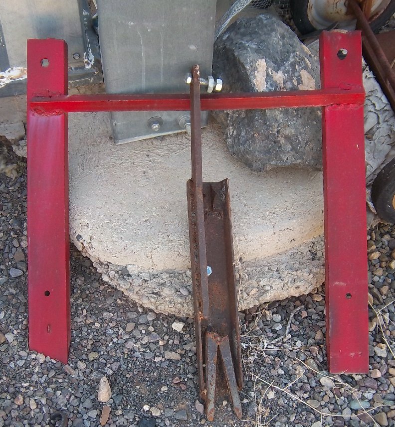

I have a hard time with the cost of those simple forks. A little scrap iron & less than a 1/2 hour of welding + drilling two holes in the bucket & your done.
Pictured is a simple short for mostly for brush loading, not for real heavy work.

Very similar to what I made!
You'll be very pleased 'specially moving piles of branches.
Hint: just lay branches flat and pile high and drive the forks in. You will find that the branches sort of interlock and while carting very few will fall off.
Just add a bit of tilt back and off you go.
I have piled so high that I can barely see where I am going.
