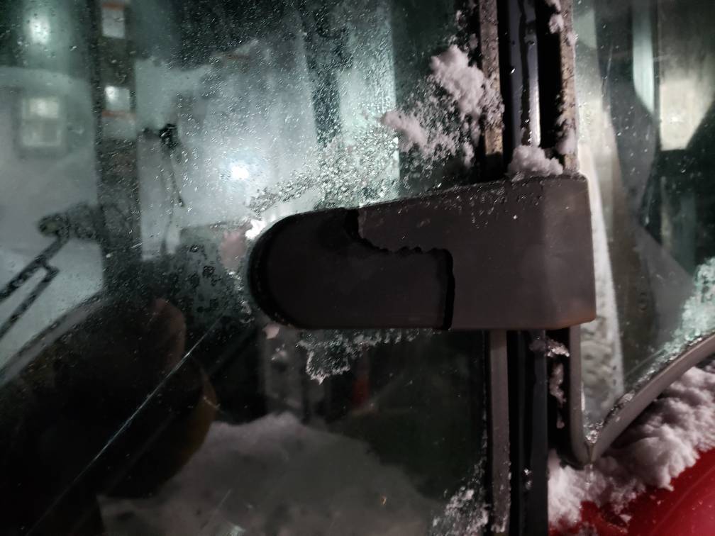

Argh...not too happy right now, broke my baby!
   / Argh...not too happy right now, broke my baby! #11
Try putting or hanging a light inside the cab with a small appliance bulb like 40 watt I have one in a cover over my jet pump for my water system keeps it from freezing all winter even have it plugged into a little device that turns on at 35degrees. Only cost around $20 for the whole setup and is cheap to operate.
   / Argh...not too happy right now, broke my baby! #12
Lightened up some.
   / Argh...not too happy right now, broke my baby! #13
EasyHeat Freeze Free Pipe Heat Cable Controller
This the name for it can't get the picture to copy but this is at Lowe's
You can plug a small light into it or even a little heater but an appliance bulb works great just has to be the old fashioned incandescent type.
   / Argh...not too happy right now, broke my baby! #14
