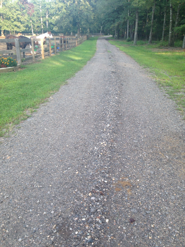

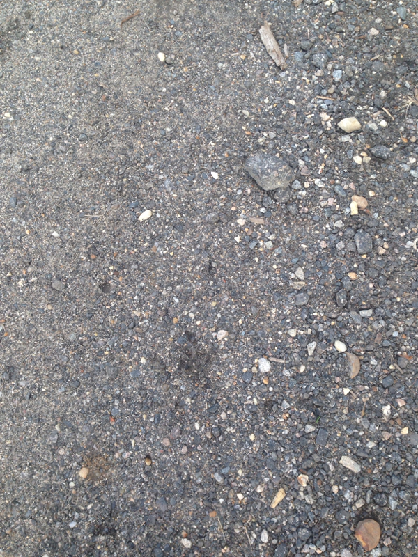

This is what my drive looks like after 3 yrs. I take the rake once in awhile and drag it back to the middle. I spread it with a 4 in 1 bucket and a rake. Then packed it with the hoe tires. I ended up building a land plane to cut the whoopdedos out of it. Very little grass grows in it. I thought about taking the chunks with the yellow paint on them and striping the middle.
